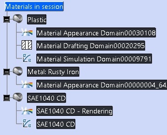

  • Material Definition App shows all the materials Open in the Session. This helps to quickly locate and edit any of the materials loaded in the session, from any product you are working on. (Image 3)

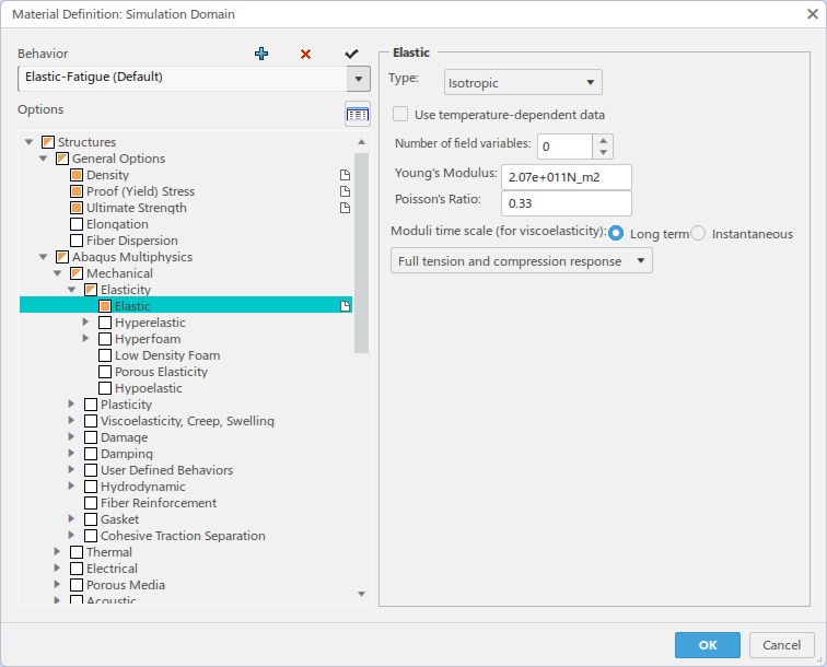

Image 1- Material Definition App- Editing Simulation Domain properties

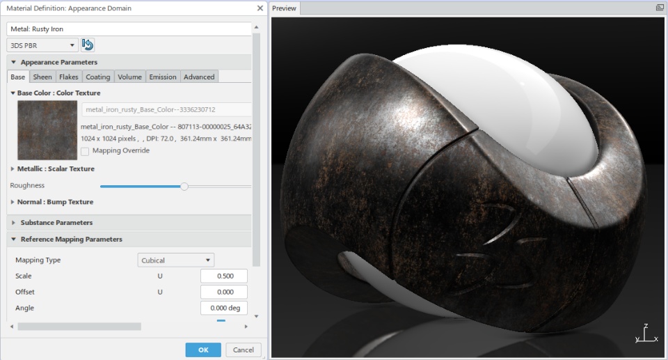

Image 2- ​​​​​​​Material Definition App- Editing Appearance Domain Properties

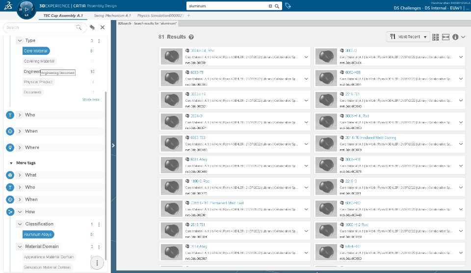

Image 3 Material Definition App- Materials in Session

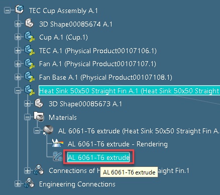

Material Definition dialog box can also be opened within other Apps
(like Part Design) by double clicking the already applied Material's Domain from the tree. ​​​​​​​​​​​​​​The material properties can be modified from here too.

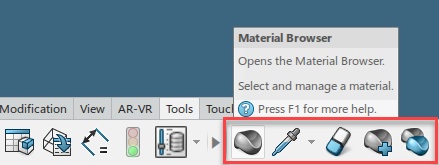

Material Browser- Material related operations are also available in the Tools Section of Design apps.
You can do the following:
  • Search for Materials, view their details
  • Filter Materials with 6WTags- (Which type of material? Who was the creator of the material? When was it created?... etc)
  • Pick a Material from a geometry it was applied on
  • Apply a material to a geometry
  • Duplicate existing materials
  • Delete applied materials

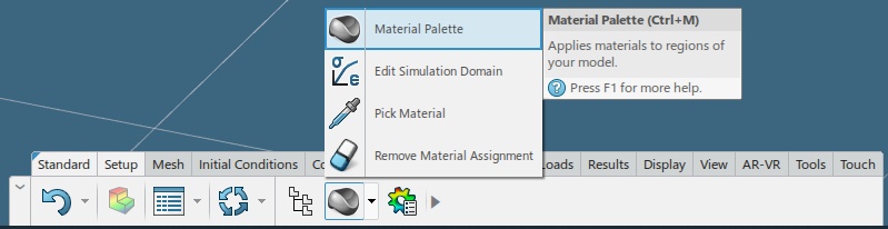

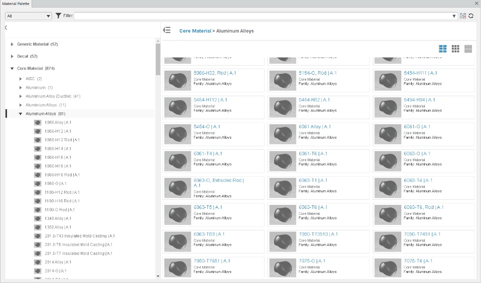

Material Palette- Material related operations are also available in the Tools Section of Simulation apps.

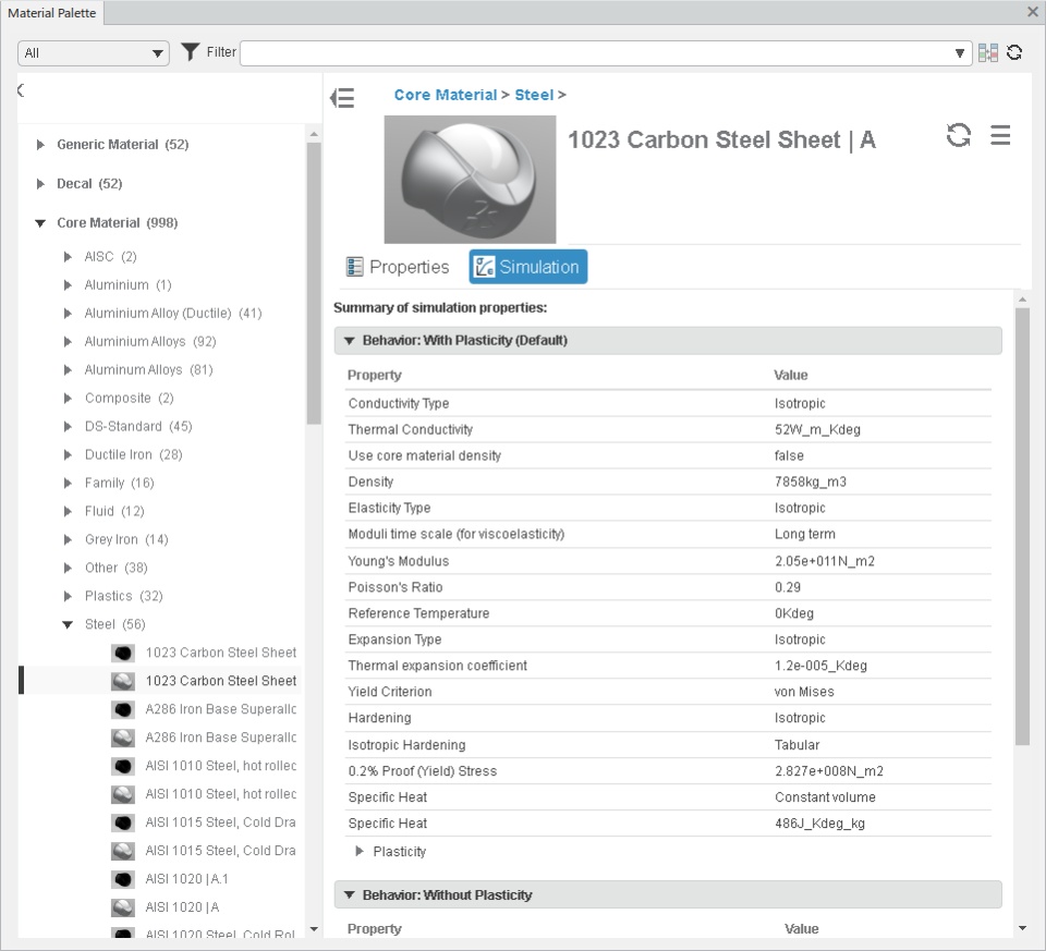

  • Use the Material Palette to explore a material and its associated material domains, or to explore a material domain and its associated parent material.
  • View and Edit Simulation Domain Properties
Material Palette​​​​​​​
3DSearch- Materials can also be Searched and Filtered using the Search bar from any app.​​​​​​​
