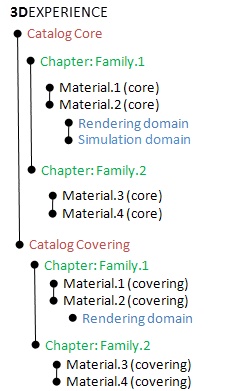

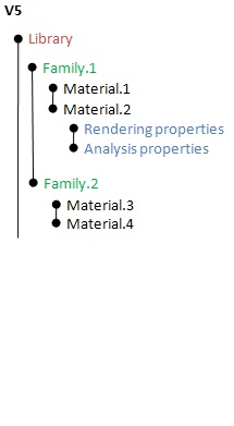

A CATIA V5- CATMaterial document has no equivalent in the 3DEXPERIENCE platform, but its content is imported as shown below-
CATIA V5 Data3DEXPERIENCE Data

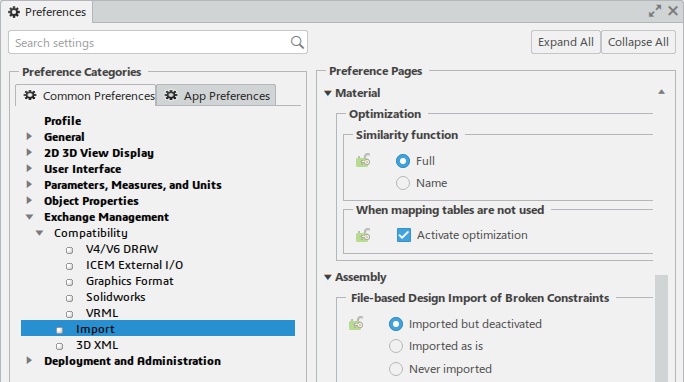

To specify these options, select Me > Preferences > Common Preferences > Exchange Management > Import > Material tab.
Similarity Function
Full
Imports material data using the full similarity function which tests the similarity of materials by checking both material names and domain attribute values. (By default, this check box is selected.)
Name
Imports material data using a similarity function that tests the similarity of materials by checking material names only.
When mapping tables are not used
Select- Activate optimization
FBDI performs optimization of the newly imported material data, which helps ensure that data is not duplicated if a previously imported material is similar to one that you want to import.

  • Import Mode- Do not simultaneously use the Name and Full similarity functions.
Use the same mode for all your imports.
For example, if you import a part with applied materials in the Full mode and then import the same part in the Name mode, the system may not recognize the previously imported materials and create duplicates.
  • If you select Optimization > Similarity function > Full, only the materials with a Basic, Custom or 3D Material rendering domain are supported. The materials with another rendering domain type are duplicated.
