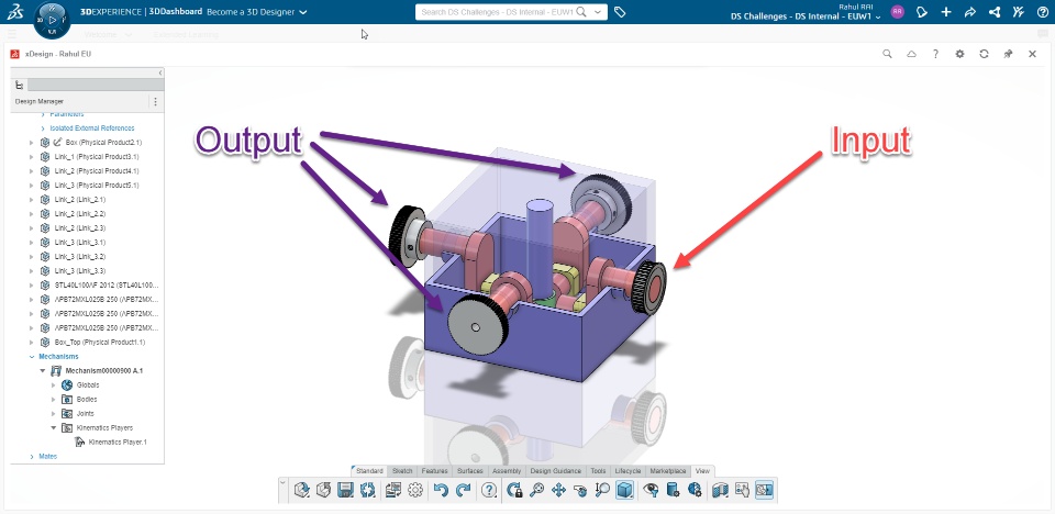

Can we transmit rotational motion at right angles without using bevel gears?

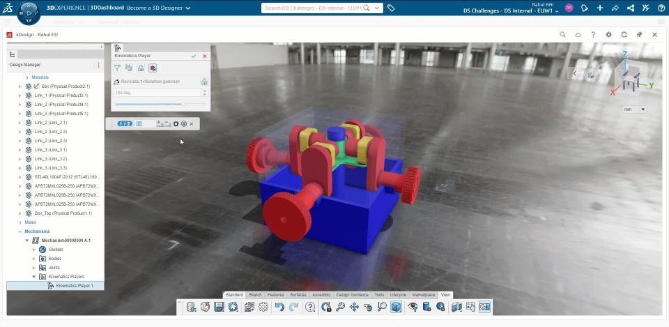

Yes, following Transmission Box receive input on one shaft and give output to other three shafts. Its a combination of sliding and rotating pairs. It works best for high load on low speed.
Kinematic Simulation
Realistic Visualization
