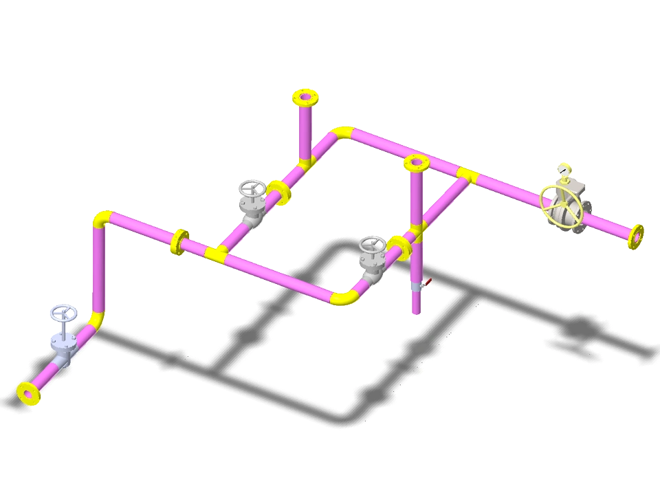

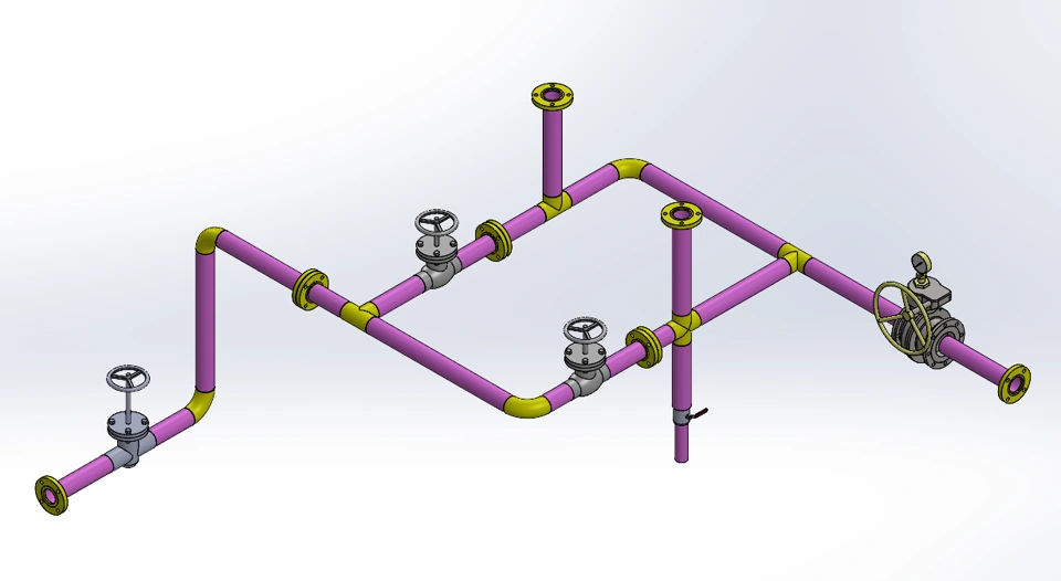

This SOLIDWORKS piping model shows a network of pipes with elbows, flanges, and valves placed using the Routing add-in.
It’s a basic setup that can be scaled into a full plant layout with tanks and equipment.
