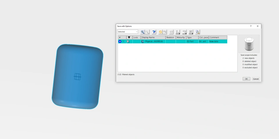

I encountered an issue when trying to create a part or component in the "Part Design" app on 3DEXPERIENCE. I want to save my part or component into a specific bookmark, instead of just the collaborative space. When I save it in the collaborative space, it becomes cluttered with various parts mixed together, which is not ideal.
I am seeking advice on how to handle this and wondering if there's a video tutorial available. I've been searching for information on forums and YouTube for about a month now, but I've only found tutorials for "Solidworks," which allows saving into a specific bookmark, unlike "Part Design." I will attach a picture to show that I cannot select a bookmark when saving a part for the first time in "Part Desing".
