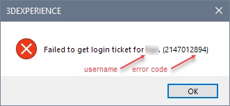

Failed to get Login Ticket Error....How to Resolve?
This is a generic error that means you cannot access a collaborative space on your platform. There are different solutions depending on the error code.
400 error:
This is the generic HTTP 400 Bad Request error, which means that the server cannot process the request because of an invalid request.

2147012889 error:
This error indicates that you have an expired Collaborative Industry Innovator license on a platform. To validate this, perform steps 3-6 of the "403 error" answer. If you have access to multiple platforms, then activate each platform. You either see an error or do not see any collaborative spaces in the 3DSpace app.
Contact your Platform Administrator to remove the expired license and role from your account.
2147012894 error:
This error indicates that there is a server outage or ongoing maintenance. Check the 3DEXPERIENCE platform on cloud support webpage to ensure that the servers are available.
2147418113 error:
This error indicates that you do not have a Collaborative Industry Innovator license. To validate this, perform steps 3-6 of the "'403 error" answer. You either see an error or do not see any collaborative spaces in the 3DSpace app.
You might also see this error if other dashboard app licenses expired.
Contact your Platform Administrator for assistance. You need an active Collaborative Industry Innovator license. Your Platform Administrator cannot grant you expired roles, and you must be a member of at least one collaborative space for SOLIDWORKS Connected to start successfully.
