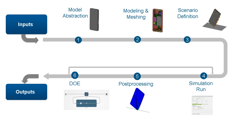

3DEXPERIENCE platform enables a streamlined, end-to-end workflow for conducting Explicit Dynamics drop test simulations, and here's what makes it stand out:
Integrated Preprocessing Capabilities:

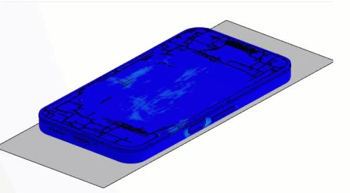

  • Create rigid abstraction shapes (e.g., floor surfaces) for impact definition.
  • Mesh complex assemblies with precision.
  • Apply boundary conditions, contact definitions, and gravity loading—all in one collaborative environment.
Powerful Post-Processing Tools:
  • Visualize stress, strain, and deformation to identify critical failure regions.
  • Analyze time-dependent responses like impact force and acceleration.
  • Use animations, section cuts, and contour plots to interpret results and communicate design performance clearly.
Accelerated Design Iteration:
  • Quickly implement and validate design modifications within the same platform.
  • Reduce the need for physical prototypes by using simulation insights early in the development cycle.
  • Foster better collaboration between design, engineering, and simulation teams—all connected through the cloud.
