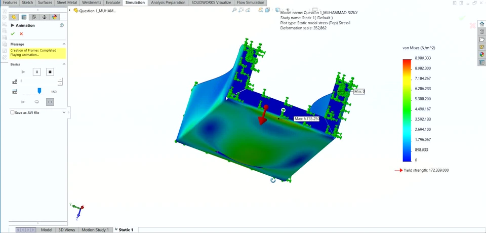

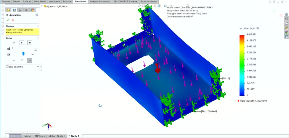

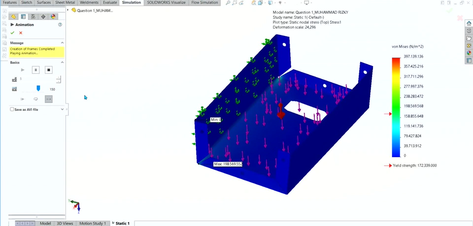

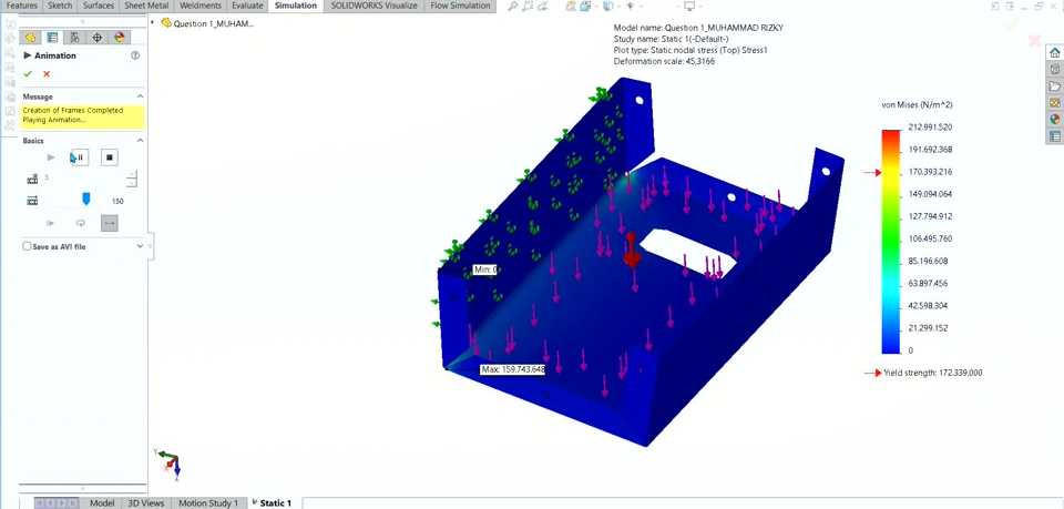

I just tried and applied SOLIDWORKS Simulation for a Sheet Metal Enclosure Bracket, applying realistic load conditions and using Stainless Steel as the material. The Sheet Metal Enclosure Bracket was tested with two fixed geometric ratios as the basis. Here are the details that will be applied to the test:
📌 Applied load: 25 N and 50 N
🌍 Gravity: 9.81 m/s^2
🛠 Material: Stainless Steel
🛑 Stress Results:
Fixed Geometry 1 Side
  1. 25 N - SS
  2. 50 N - SS
Fixed Geometry 2 Sides
  1. 25 N - SS
  2. 50 N - SS
