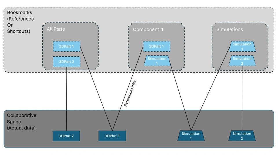

  • A Bookmark does not store data. It only allows to order and facilitate access to the content in a collaborative space.
    Bookmarks themselves are essentially like references or links to your data, meaning you can have the same content referenced in multiple bookmarks without duplicating the actual content in the Collaborative Space.

    • Updating: Bookmarks store references to content, so if content is updated, the changes are reflected across all bookmarks referencing it.
