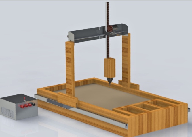

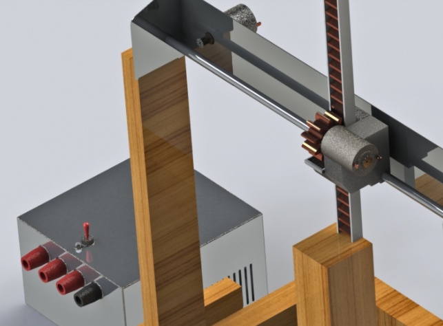

The working idea of the model is similar to that of a Crane and hoist system used in various factories and harbours in this case instead of the hoist there will be a solid bar that will be using rack and a pinion system and instead of the hook in the centre of the crane there will be an adjustable lever arm which can be easily removed so as to fulfil the different operations, further the idea is to create an automatically changing arm as per the need.
Our model will work on the closed-loop with sensors that will specify the system the moisture content of the soil, weather conditions, the temperature of the surroundings, the intensity of sunlight, the intensity of rainfall and hailstorm.
The system is designed to compete for all the farming process which includes preparing of land, sowing of seeds, watering etc. The model will be a helping hand to the farming in both the initial and final phase of the farming and thus also relieving the farmers of undue fatigue. Precision farming, farm-land mapping, drip irrigation and regulated admission of fertilizers can be some of the possible features.
Working of the Product-
The three Main Objectives of the model are
1. Sowing
2. Watering
3. Fertilizing
As mentioned earlier a system identical to crane and hoist is idealized which will be a 3 axis CNC machine type system is set up on the field with a parallel track system along the length. A universal tool holder will be incorporated to mount the tools on the gantry, motors will be used to move the end effecter to various locations on the field to perform specified tasks, mapping of the field is done and a centralized controller is used to direct the machine to various locations and carry on the given task. Sensors such as Control unit (which can be programmed to perform certain calculations and accordingly instruct the components), Ultrasonic sensors, potentiometer, Arduino Soil Moisture Sensor Module, Arduino Uno and HC-05 Bluetooth module will be used for various applications so as to automate and execute the farming with high precision. POTY2K21
