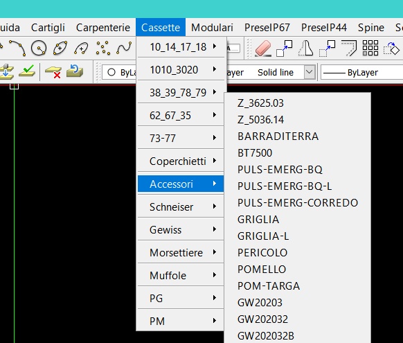

Hello, with DS V1r5x64, I compiled lots of customized menus as below, to automatically insert blocks from a customized library.
With an xml editor I compiled new menu definitions.

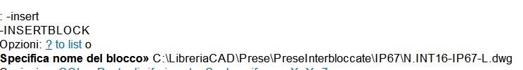

Then here we have the command line.
In command line the following (working) result:

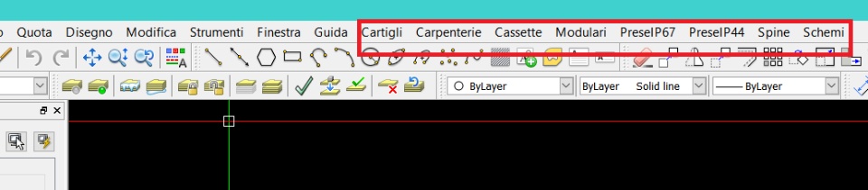

I can’t understand why, but it no longer works with the DraftSight 2019 x64 SP1
Menus has been correctly charged, but the command is not recognized.

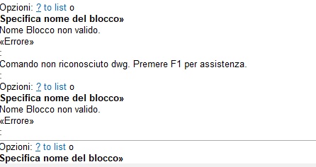

In the command line the responses are:
”Invalid block name”
“unrecognized command“
