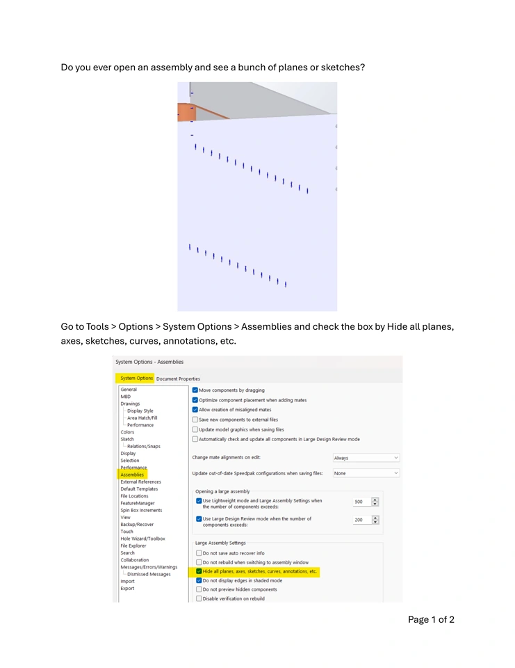

Hey Betty, you could add to this that the eye in the top middle of the screen can be used to hide/show planes, sketches, origins, etc...
The setting you mention is something for 'Large assembly mode', it isn't active on smaller assemblies. The eye is something that works in every environment. It should be noted that while they aren't seen anymore, they are still 'loaded' by the software and calculated in every rebuild.

Alex - I much prefer to hide reference geometry individually in the feature tree and not generally using the eye or the display dropdown. Doing it individually, you can unhide just one in a large assembly and actually use it. If hidden generally, then they all come back if you try to show just one. - Dwight

Two problems with using this:
One: No matter how you do it (System Options, Heads Up Toolbar, View...Hide/Show...All Types menu) it takes precedence over everything. For example, if you have a nifty keyboard shortcut to hide/show temporary axes, it will no longer work when 'Hide All Types' is enabled.
Two: While it appears in System Options, the setting is saved with the document.
I get extremely angry when I come across files stored in our PDM vault that have this setting enabled, which breaks my aforementioned keyboard shortcut and in order to permanently fix it I have to move the files through the PDM workflow so I can check the file out. Having this information saved in the document is just dumb.
