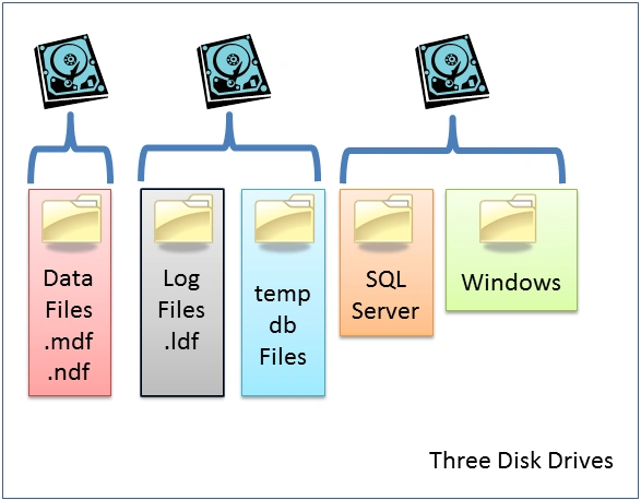

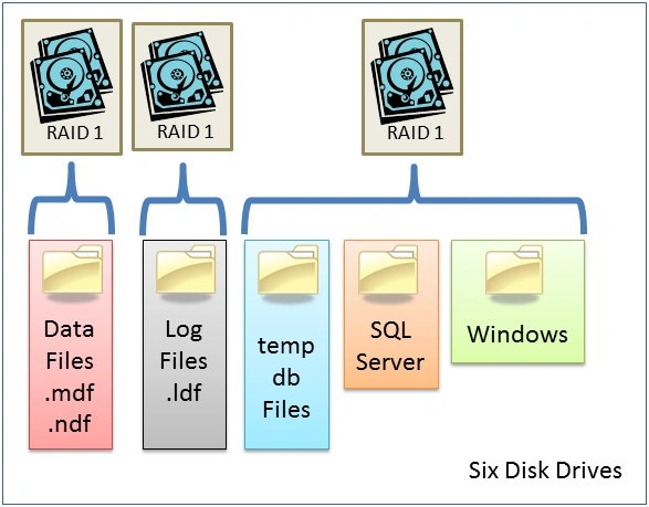

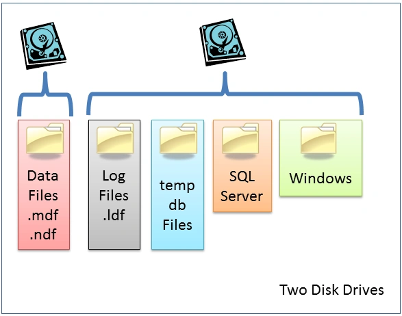

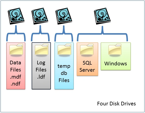

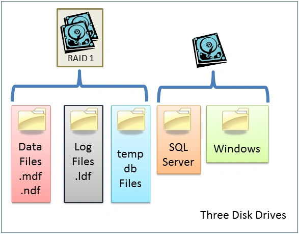

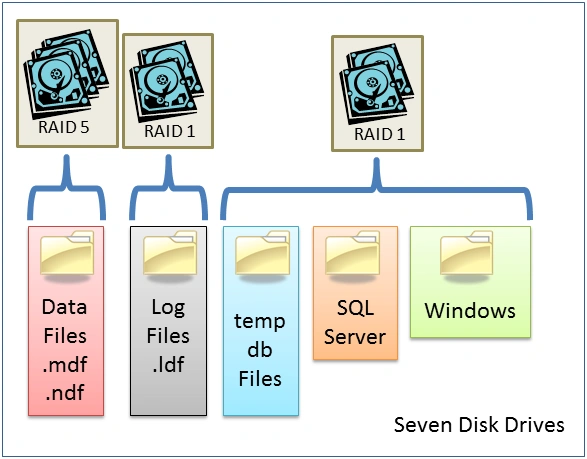

v) Understanding RAID for SQL Server
When designing your database server, choosing the right number of hard drives and the correct RAID configuration can save you a lot of time. If you make a mistake, changing the RAID configuration and moving the database later to correct problems on a deployed server will cause long downtimes and consume IT resources.

- Two drives
With a two-drive SQL Server installation, you can deploy RAID 1 (disk mirroring). In this scenario, all data (Windows, SQL Server, database data files, transaction logs, and tempdb files) goes onto the one logical drive. This deployment is fast and redundant; however, it creates a bottleneck around the disk I/O.
When it comes to hardware, the disk subsystem has the potential to become the greatestbottleneck to SQL Server.
The speed of the disk drives and the ability of the drives to read and write data are the main factors that cause a server running SQL Server to experience slow performance. In other words, the more disk heads you have, the faster the server will perform. Therefore, while two drives that use RAID 1 create a safe environment, it is best to have as many disk heads (physical disk spindles) in your deployment as possible.
A better alternative is to distribute the load across the two disks without using RAID. This method trades robustness for performance. In this case, allocate the one disk drive to the database data (MDF) files. Everything else including the operating system, the tempdb files, the virtual paging file (an operating system file), and the transaction log go onto the primary drive.
- Three drives
With three drives, you can deploy RAID 5, which provides better performance for reading data. However, the drawback is a decrease in performance when writing data. RAID 5 also uses more physical disk space than with a two-drive deployment.
A more likely scenario is to gain the read and security benefits by using a RAID 1 array for all the database files. This means trading this robustness against the likely disk contention.
If you can manage the risks around reducing robustness, you can achieve better performance by spreading the files across separate disk spindles.
- Four drives
With four drives, things get interesting. You could deploy RAID 10 and create one logical drive that holds all data (Windows, SQL Server, the database data files, the transaction log, and the tempdb files). This is very tempting because there is a lot of publicity about the benefits of using RAID 10.
However, it is better to deploy two sets of RAID 1 arrays, which give you two logical drives. This way, you can move the database data for SOLIDWORKS PDM to the second logical drive, and keep the tempdb files, the virtual paging file, and the transaction log on the first logical drive. Typically, the system does not access the virtual paging file very often.
Another option is to not use RAID at all. Instead, you could spread the data over four physical disks. This option maximizes speed, but the system is less robust.

- Six drives
The availability of six drives provides many more options for RAID configuration. Six disks perform better than any of the previous scenarios. With six drives in your physical server, you gain the best performance by setting up three arrays of two disks per array in a RAID 1 configuration. Make sure that at least one of the arrays has enough room to hold your MDF file with room to grow. One array should hold the MDF file for SOLIDWORKS PDM and nothing else. One array should hold the transaction log (LDF) files and nothing else. The last array (drive C:) should have everything else, including the operating system installation and the tempdb files.
- Seven drives
Seven drives allow you to store more data than six drives because you can add the extra drive to one of the arrays, and configure it as a RAID 5 array. Therefore, you still have three arrays, two arrays with two drives in RAID 1, and one array with three drives in RAID 5. On the RAID 5 array, you have the database (MDF) files for SOLIDWORKS PDM. On one of the RAID 1 arrays, you have the transaction log files. The last array (drive C:) should have everything else, including the operating system installation and the tempdb files.

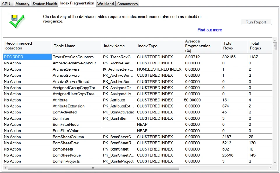

- Schedule a reorganization and rebuild of indexes by using a SQL Server Maintenance Plan.
- Review the MDF and LDF files to ensure that they do not exceed the initial sizes.
- Check for disk fragmentation.

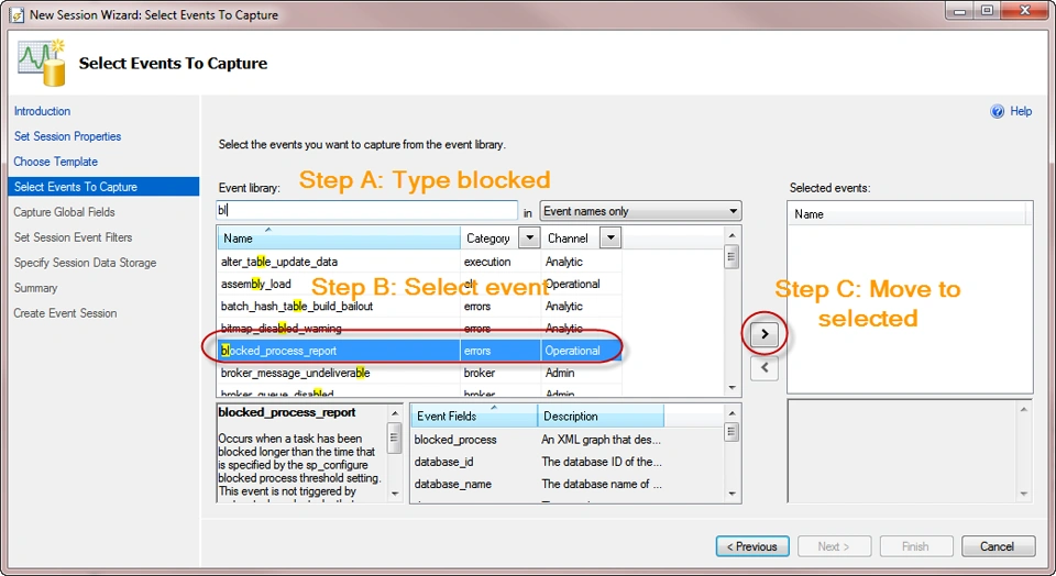

- Tracing random performance indicators such as database locks, deadlocks reports, and blocked processes reports. This method has the advantage that it can run continuously for months. In some cases, it might help identify a performance issue without the need to start a SQL workload trace.
- SQL Workload tracing – This is one of the most detailed collection sets. In some cases, this method can help identify if a specific SOLIDWORKS PDM operation, client computer, application, or file set is the cause of the issue.

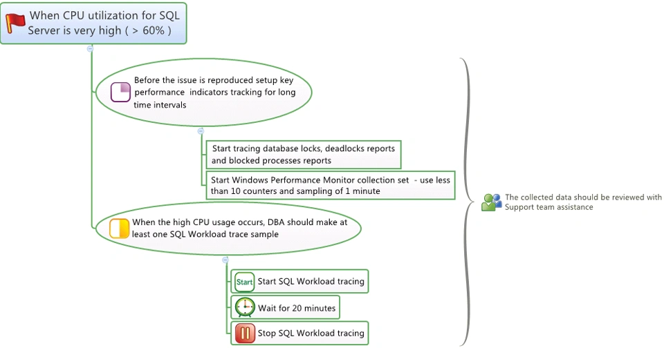

The following diagram explains how to use these data collection methods depending on how the issue is reproducible in a production environment.
How can you reproduce the problem?
:Important:
- For reference crosschecking of SQL events, it is a best practice to collect and review the following logs with the Support team: SQL Server logs, SOLIDWORKS PDM client and service logs (COG files), and Windows Application logs (EVTX files).
- Random problems or problems that occur when CPU utilization exceeds 60% require SQL workload tracing. A DBA or a SOLIDWORKS PDM administrator that is familiar with SQL Server Extended Events and SQL server side tracings should perform this task.
- Before reporting an issue that is reproducible at any time to Technical Support, confirm that the problem is also reproducible in a test environment.
- For most performance cases, the data mentioned in this section should be enough to understand the main SQL performance issues. However, in some complex cases, Technical Support could ask to adjust the collection sets or to repeat the data collection with a different server or database configuration.
- In cases where the collected data cannot help identify the performance issue, the recommendation is to work directly with end users and review their actual complaint. This may reveal that the actual problem might not relate to only the SQL Server performance.
iii) Analyzing performance data
Following the process in the previous section ensures the collection of all main key performance indicators for SQL Server. In addition, SQL trace (TRC file format) or Extended Events sessions (XEL file format) include details with the SQL query execution.
As a general rule, the more deadlocks, blockings reports, and high CPU usage that are in evidence, the worse the overall performance it is. This type of data is usually seen in Performance Monitor collection sets. You must use the SQL query data to understand what applications, client computers, or SOLIDWORKS PDM operations are involved.
When analyzing a SQL query, it is important to identify the name of the SOLIDWORKS PDM stored procedures. In most cases, these stored procedures have a self-explanatory name. For example, XRef_GetTree means getting file references, SPA_AddDocuments means the operation to add documents, and so forth.
If a SOLIDWORKS PDM vault stored procedure appears in a SQL event that takes a long duration, or is involved in a deadlock or blocking process report, the stored procedure helps identify the cause of the performance issue.
SQL queries that have stored procedures may include as parameters document IDs or user IDs, which you might use to reproduce the issue. Eventually, this should help solve the problem.
The next section covers additional information about how to analyze performance data.

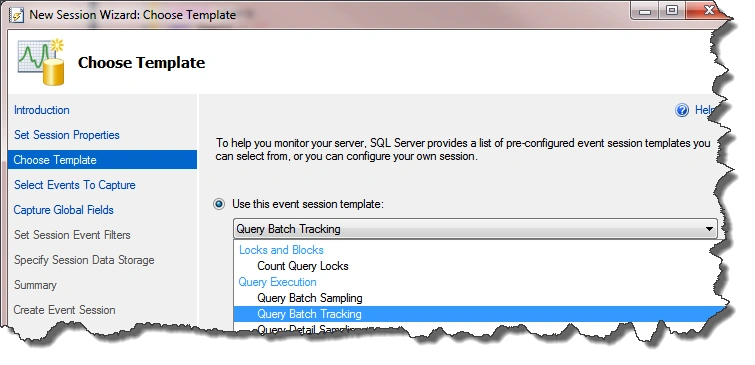

Use Extended Events sessions based on the Query Batch Tracking template that tracks all active sessions.
To configure a SQL Server workload session, follow these steps:
1. Open SQL Server Management Studio.
2. Connect to the production server instance.
3. Expand the SQL Server instance > Management > Extended Events.
4. Right-click Sessions > New Session Wizard.
5. Type a new name for the session. For example, Query Batch Tracking.
6. Click Next and then select the Use this event session template option.
7. Select the Query Batch Tracking template, and then click Next.
8. On the Capture Global Fields page, select the check boxes for the client_hostname and database_name fields.
9. Click Next and proceed to the Specify Session Data Storage page. Then select the Save data to a file for later analysis option.
10. For the File name on server option, browse to a file location in which you wish to save the trace file. For example, C:\\Temp\\ QueryBatchTracking.xel.
If you do not specify a file location, the trace file saves in the default location of the Log folder. For example, C:\\Program Files \\Microsoft SQL Server \\MSSQL[version].MSSQLSERVER\\MSSQL\\Log\\ QueryBatchTracking.xel. However, sometimes there is a change to the default location. Therefore, it is better to specify the location in which to save the trace file.
11. Ensure that the Enable file rollover option is active and that the total stored data is approximately 500 MB. For example, Maximum file size = 100 MB and Maximum number of files is 5. A size of 500 MB is a recommendation only. You can add more storage as needed.
12. Click Finish and then click Close.
13. In the SQL Server Management Studio Object Explorer, expand the SQL Server instance and navigate to Management > Extended Events > Sessions.
14. Right-click Query Batch (or the name you specified in step 5) > Start Session.
15. After reproducing the issue or after 20 minutes when taking SQL workload samples, stop this extended session. To do this, repeat step 13, and then right-click QueryBatchTracking (or the name you specified in step 5) > Stop Session.

- Capturing blocking locks
To capture blocking reports, follow these steps to create a new Extended Events session:
2. Connect to the production Server instance.
3. Expand the SQL Server instance and navigate to Management > Extended Events.
5. Type a name for the new session. For example, type BlockingLocks.
6. Click Next > select the Do not use a template option > Next.
7. On the Select Events to Capture page, double-click the blocked_process_report event (or press the arrow) to move the event to the Selected Events list.
8. Click Next and proceed to the Specify Session Data Storage page. Then select the Save data to a file for later analysis option.
9. For the File name on server option, browse to a file location in which you wish to save the trace file. For example, C:\\Temp\\ BlockingLocks.xel.
Note: If you do not specify a file location, the trace file will be saved in the default location of the ‘Log’ folder. For example, C:\\Program Files \\Microsoft SQL Server \\MSSQL[version].MSSQLSERVER\\MSSQL\\Log\\ BlockingLocks.xel. However, sometimes there is a change to the default location. Therefore, it is better to specify the location in which to save the trace file.
10. Click Finish and then click Close.
11. In Object Explorer, right-click the SQL Server instance > Properties > Advanced and set the Blocked Process Threshold event to 20 seconds. In test environments, you could use a value of 5 seconds instead.
12. Expand the SQL Server instance and navigate to Management > Extended Events > Sessions > Blockings (or the name specified in step 5) > Start Session.

i) Index Fragmentation
SQL Server uses indexes to provide fast access to information at the request of users or applications. As the table data grows or changes, the Database Engine maintains these indexes. Over time, the indexes can experience fragmentation, especially in databases like SOLDIWORKS PDM in which there is a lot of insert, update, and delete activity. Fragmentation occurs in an index when the physical ordering on the disk does not match the logical order of the data (as defined by the index key,) or when data pages that contain the index are dispersed across non-adjacent sections of the disk. Fragmentation of an index can reduce the speed of data access and result in slower performance of the application. It can also cause the use of more disk space than is actually necessary. You can correct index fragmentation by reorganizing or rebuilding the index.
The easiest way to check for index fragmentation is to run Status Report > Performance > Index Fragmentation.
The Recommended operation column in the report states if a specific table or table index requires a specific maintenance task.
Reorganizing an index does not block user access to the index while the reorganization is in process. However, rebuilding or recreating the index does prevent user access to the index. The exception to this is when using the ALTER INDEX REBUILD statement with the ONLINE = ON option.
Periodically checking for index fragmentation and taking any necessary corrective action is important to maintaining the performance of your SOLIDWORKS PDM system. The rate at which fragmentation occurs depends on user activity. In general, SOLIDWORKS Technical Support recommends checking index fragmentation at least monthly.
Use the following values to determine the best method to remove the fragmentation:
- Reorganize the index when index fragmentation falls between 5% to 30%.
- Rebuild the index when index fragmentation is greater than 30%.
For information about how to establish a maintenance plan that rebuilds the indexes for a SOLDIWORKS PDM database, see the following Knowledge Base solutions:
