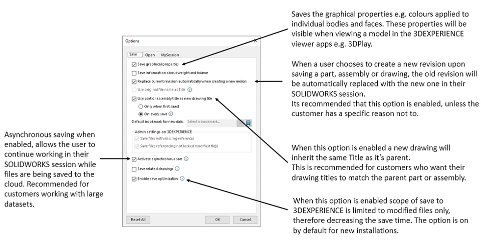

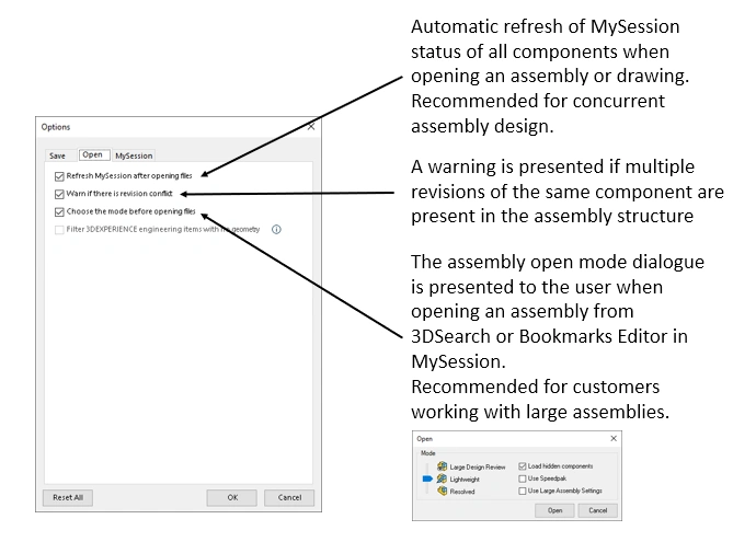

SOLIDWORKS MySession Settings

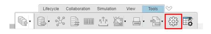

The SOLIDWORKS MySession settings provide the ability to configure the open and save behaviour on each individual user’s workstation. In order for a customer to have the best experience it’s important that users understand these options and how they affect the behavior of SOLIDWORKS. When teams of users are working together on the same project it’s important that the settings chosen are consistent across all workstations to avoid unexpected behavior.
The MySession options are located on the Tools tab of the MySession toolbar.

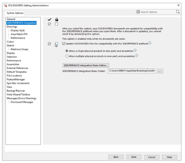

Managing SOLIDWORKS System Options in 3DEXPERIENCE
In a situation where a user’s SOLIDWORKS system options are controlled by an administrator via an sldsettings file, the 3DEXPERIENCE platform can be used to store and manage the settings file. Managing the sldsettings file in 3DEXPERIENCE removes the need to store it on an inhouse server and provides a quick and easy way to deploy standardized SOLIDWORKS settings to multiple users at a company.
A sldsettings file is generated using the Settings Administrator utility. For customers using 3DEXPERIENCE SOLIDWORKS, the utility is located in the SOLIDWORKS installation folder. For customers using SOLIDWORKS desktop and the Collaborative Designer for SOLIDWORKS role, the utility is located in the SOLIDWORKS administrative image.

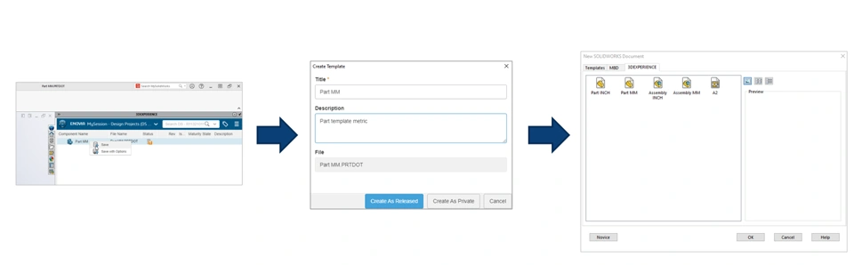

SOLIDWORKS templates are the method of enabling all users at a company to work together using consistent SOLIDWORKS settings and defined drawing standards. For existing SOLIDWORKS customers adopting 3DEXPERIENCE , storing templates in the platform allows them to maintain that consistency of settings and standards with some added benefits.
Security, storing SOLIDWORKS templates in 3DEXPERIENCE provides control over who can modify and delete templates. This is important for customers operating in tightly regulated industries where drawings and have to adhere to strict standards, and for customers working concurrently on large assemblies where having consistent settings across all users will enable everyone to work in the most efficient way.
Storing and managing SOLIDWORKS templates in 3DEXPERIENCE provides the additional benefit of lowering administration overhead. Templates don’t need to be backed up from a server, and any modifications can be immediately made available to all users in a company, which can be a big benefit to customers both large and small.
The process of uploading Part, Assembly, or Drawing templates is the same as a regular SOLIDWORKS file. When opened in SOLIDWORKS a template is saved to a collaborative space using the MySession save. However there are a few subtle differences. Templates are recognized as their own object type which is XCAD Template. During the save the user is offered the option of either creating the template in the Released maturity state making available to all users, or in the Private maturity state where it will only be accessible to the person saving. Any templates saved in the Private state can always be promoted later to Released if required.

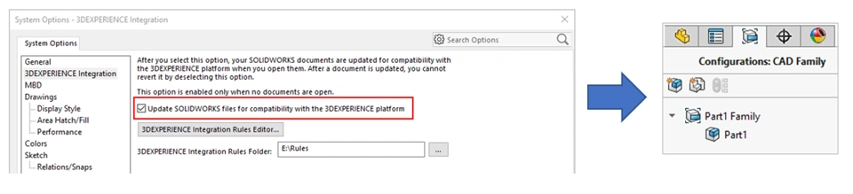

Attributes from 3DEXPERIENCE can be mapped to SOLIDWORKS parts, assemblies, and drawings. There are two types, PLM attributes for example Revision and Maturity which are available without any set up, or user defined attributes from an object (Physical Product, Drawing). Likewise SOLIDWORKS properties can be mapped to 3DEXPERIENCE. This is useful for passing property values to 3DEXPERIENCE that are generate by SOLIDWORKS, for example Material
When configuring attribute mapping from SOLIDWORKS it’s important that the customer is familiar with the concept of CAD Family vs Physical Product in relation to SOLIDWORKS Parts and Assemblies. It is important that any properties defined in SOLIDWORKS are stored on the configuration specific tab. Configuration specific properties map to the related Physical Product and therefore will be searchable and visible in all of the 3DEXPERIENCE web apps.

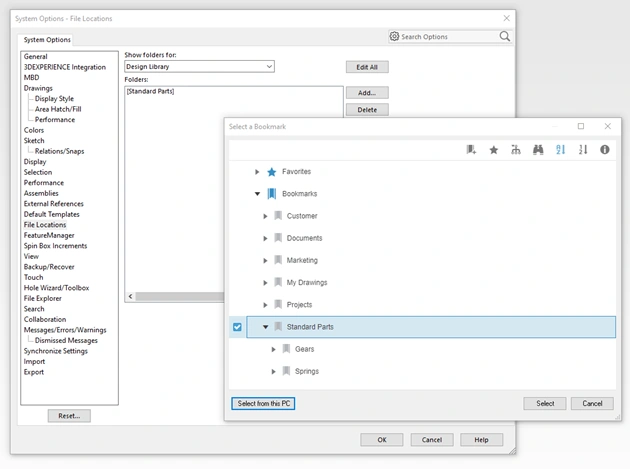

Configuring the SOLIDWORKS Design Library for 3DEXPERIENCE

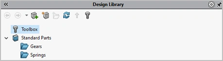

The SOLIDWORKS Design Library tab in the SOLIDWORKS Task Pane provides a central location for reusable design elements such as parts, assemblies, and sketches. Traditionally the Design Library displays sub folders and their contents located on a local or network drive.

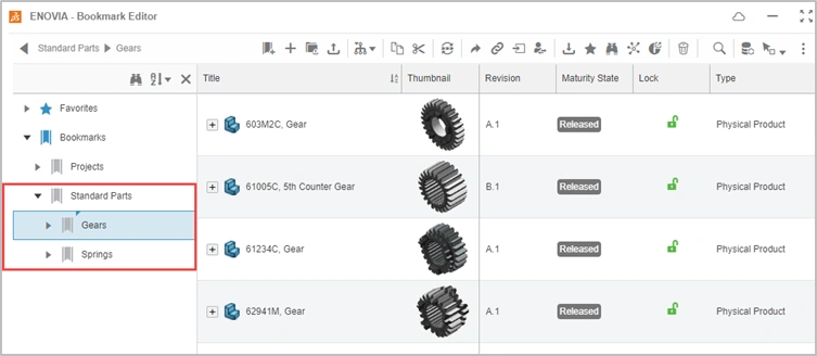

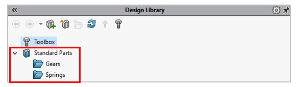

Customers adopting 3DEXPERIENCE can store their Design Library parts and assemblies in a collaborative space, and organize them using a Bookmark structure. This is called a Connected Design Library and is displayed in the Task Pane with a blue library icon.
EXPERIENCE Utility is used to upload the files replicating the existing folder structure as Bookmarks. To avoid users unintentionally modifying the Design Library items it is recommended that after the upload, the library items are promoted from “In Work” to the “Released” state if no further modifications (geometry, attributes etc.) are required.

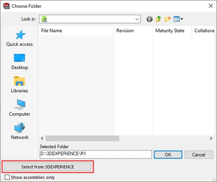

  • In SOLIDWORKS Options > File Locations, show folders for Design Library and click Add
In the choose folder dialogue box, click Select from 3DEXPERIENCE.
Using a “Protected” Collaborative Space type provides a simple method of restricting the access to Design Library components undergoing modification while in the In Work maturity state, followed by automatic exposure of the Design Library components to the wider business when they are promoted later to the Released state.

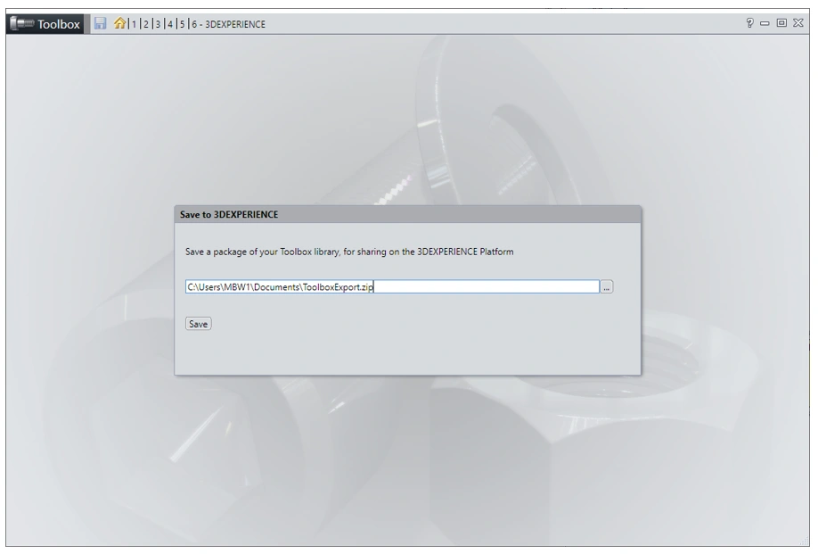

Configuring SOLIDWORKS Toolbox for 3DEXPERIENCE
Its common practice for existing customers using SOLIDWORKS Professional and Premium to be utilizing Toolbox for their standard parts library.

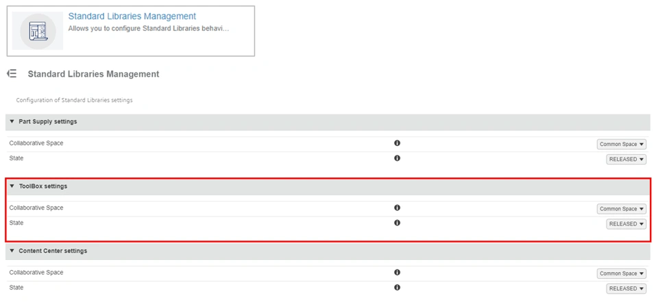

The Toolbox component library can be fully managed using 3DEXPERIENCE, therefore it is important that both new and existing customers intending to use Toolbox have a complete understanding of how to use it in the context of 3DEXPERIENCE.
EXPERIENCE platform by the administrator. The package file can be automatically created from step 6 in the Toolbox configuration utility.EXPERIENCE the default collaborative space and initial maturity state of uploaded Toolbox components can be configured from the Standard Libraries Management area of the Collaborative Spaces Configuration Center.
 If Toolbox components need to edited before being made available to the wider design team, then its recommended that the default Maturity state to set to In_Work. When in the In Work state Toolbox components can modified and then promoted to the Released state as a separate operation.
For a comprehensive overview with recommended best practices, please refer to the SolidPractices guide titled Working with Toolbox.

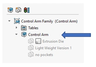

Recommended Strategy - One Physical Product per Part and Assembly File
It’s recommended that parts and assemblies designed and developed in house for production should only have one SOLIDWORKS configuration converted to a Physical Product on save to 3DEXPERIENCE. This nominated SOLIDWORKS configuration should be configured to contain any key SOLIDWORKS properties related to engineering and manufacture.
The resulting Physical Product in 3DEXPERIENCE will represent a single engineering definition for that part and assembly including the maturity state, Enterprise Item Number, plus any Physical Product specific attributes.

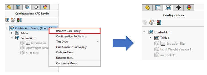

For existing SOLIDWORKS customers that are adopting 3DEXPERIENCE its important to understand how configurations have been used in their Parts and Assembly files before saving any to 3DEXPERIENCE. Due to their versatility its common practice for design teams to treat configurations as individual part numbers. In this scenario time will need to be spent analysing the files (see configuration rules utility) and factored in to any migration project.
If the intention is to maintain any part or assembly configurations as individually lifecycled engineering items, then those configurations must be split off into their own individual part and assembly files, each containing one Physical Product configuration only. Note, this is a manual process but can be automated using a SOLIDWORKS Macro.
