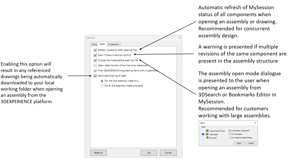

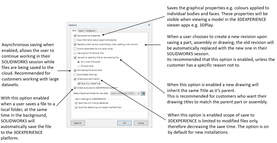

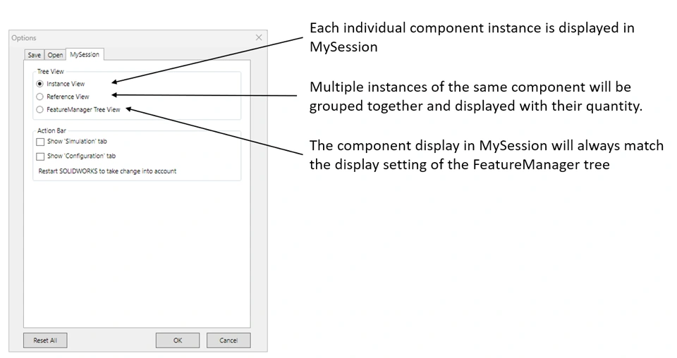

The following three graphics explain the recommended MySession option settings.
Open Options
Save Options
MySession Options
For more information related to the MySession options, please refer to the 3DEXPERIENCE online documentation here.
