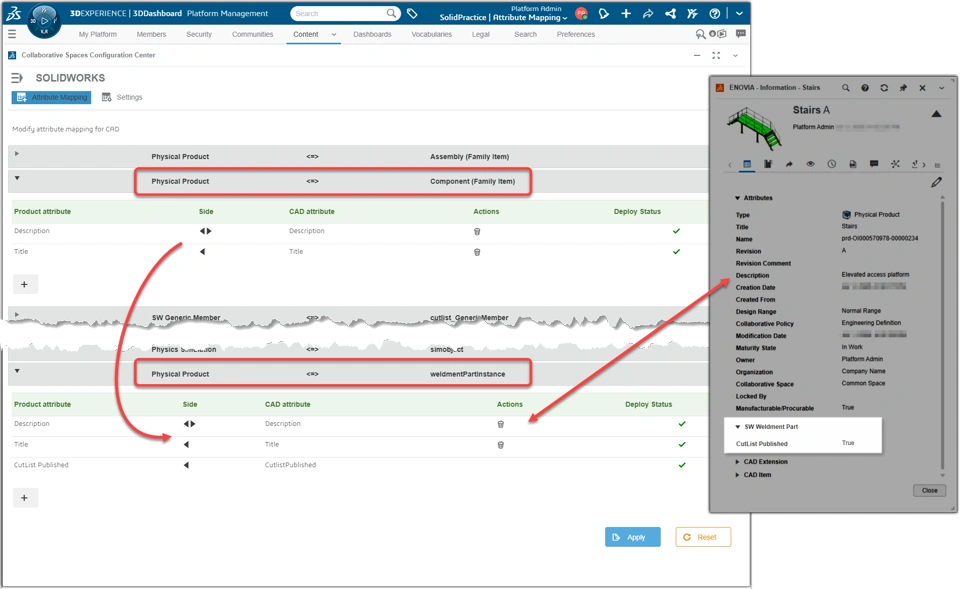

Unlike SOLIDWORKS Design, the 3DEXPERIENCE platform only has one classification of attributes. To make SOLIDWORKS Design have one classification of properties, you can activate the Update SOLIDWORKS files for compatibility with the 3DEXPERIENCE platform option.
Figure 8. The 3DEXPERIENCE Integration options are only available when you activate the 3DEXPERIENCE add-in.
The data management option only applies to user-license versions of SOLIDWORKS Design.
Figure 9. Assistant notifications, like this example for configurations, display in SOLIDWORKS Design 2026 SP1.0 and newer.
When you update files, the system disables custom properties (for part and assembly content types) and moves them to configuration properties. With one classification of file properties per content type, files are optimized for compatibility with the 3DEXPERIENCE platform.
PLM Attributes are available with and without updating.

Unlike SOLIDWORKS Design, the 3DEXPERIENCE platform does not provide a list of common attributes for content types. If you want other attributes, then you must create them for each content type. The attributes you create are called custom attributes. Custom attributes are to the 3DEXPERIENCE platform as file properties are to SOLIDWORKS Design.
i) Content Types
3DEXPERIENCE platform SaaS has 591 content types for which you can create custom attributes. Of these, only six apply to SOLIDWORKS Design data:
  • CAD Family
NOTE: The ability to map custom properties for part and assembly content types became unavailable in R2026x FD01 (February 2026). If your <strong>3D</strong>EXPERIENCE subscription started <i>before</i> that date, then you <i>can</i> map custom properties to CAD Family. However, it is <i>not</i> a best practice.
<span class="cke-highlighted" style="background-color:#f8afc8">The best practice is only to map configuration properties for part and assembly content types.</span>
  • Drawing
  • Physical Product
  • SW Generic Member
  • SW Sheet Metal Member
  • SW Structural Member

5) Data Type Mapping
Table 4. Data type mappings that you can configure between SOLIDWORKS Design and 3DEXPERIENCE.
 Attribute
Data Type
StringBooleanIntegerRealReal +
Dimensions (Unit)
Date
Property
Data Type
Text✅❌❌❌❌❌
Date✅❌❌❌❌✅
Number✅❌✅✅❌❌
Yes or no✅✅❌❌❌❌
Equation✅❌✅✅✅❌
  • You can map any property to any String attribute. To avoid mapping problems, particularly with file properties that have the Date data type, you can choose only to create String custom attributes.
  • File properties with a Yes value are equivalent to custom attributes with a True value. File properties with a No value are equivalent to custom attributes with a False value.
  • It is possible to map file properties that have a Number date type to custom attributes that have an Integer data type, even if the property value is not an integer. However, the best practice is to map Number to Real. Examples:
    • ‘1.’ is not an integer. If a property with this value maps to an Integer attribute, then it evaluates as ‘1’.
    • ‘1.57’ is not an integer. If a property with this value maps to an Integer attribute, then it evaluates as ‘1’. In both cases, the platform does not round the value.
  • You can only map file properties that have an Equation data type from SOLIDWORKS Design to 3DEXPERIENCE, and it is a best practice to create the mapped attribute as Read-Only.
    • In this scenario, regardless of the unit system in the file, the Meter, Kilogram, Second (MKS) value of the property displays shows in the 3DEXPERIENCE attribute.

i) Weldments, Sheet Metal, Structural Members
1. Publishing Cut-List Items
You can configure weldment, sheet metal, or structural member parts for cut list publishing. When you save those part files anew, the system creates a Physical Product with an SW Weldment Part extension. The system creates this extension whether you publish the cut-list items or not.
Attribute mapping for these parts has an additional requirement. For attribute values to be visible in 3DEXPERIENCE, you must duplicate your Physical Product <=> Component (Family Item) attribute mappings to Physical Product <=> weldmentPartInstance.
Figure 45. In this example, there are mappings for the Title and Description attributes. To see the values for these attributes in a Physical Product that has an SW Weldment Part extension, you must duplicate the mappings.

  • How do I map a file property like mass, with units, to 3DEXPERIENCE?
From the information in Table 4, use the highlighted data type mapping. In SOLIDWORKS Design, define your file property with an Equation data type. In 3DEXPERIENCE, define your custom attribute with a Real + Dimensions (Unit) data type.
Table 6. Data type mapping to use for file properties that have units.
 Attribute
Data Type
Dimensions (Unit)
Date
Property
Data Type
Text✅❌❌❌❌❌
Date✅❌❌❌❌✅
Number✅❌✅✅❌❌
Yes or no✅✅❌❌❌❌
Equation✅❌✅✅✅❌
The only supported dimensions (unit) are length, mass, angle, or any combination of those three dimensions (like area, volume, or density).
For example, in SOLIDWORKS Design, this weldment part is set to the MKS (meter, second, kilogram) unit system. It has a configuration property named Mass with an Equation data type. The property evaluates to 114.91. Because of the MKS unit system, the value is in kilograms.
Figure 59. Define the property type as Equation, with SW-Mass as the text expression.
In 3DEXPERIENCE, a custom attribute named Mass, with a Real data type exists. The Dimensions (Unit) parameter is set to Mass, and the Display Unit is set to kg.
Figure 60. Custom attribute with the data type as Real, the Dimensions (Unit) as Mass, and your required Unit.
Create attribute mappings, from SOLIDWORKS Design to 3DEXPERIENCE, for the configuration and the weldment content type.
Figure 61. Two mappings from SOLIDWORKS Design to 3DEXPERIENCE. One mapping for the configuration, and one mapping for the weldment content type.
With this configuration, the value of the file property propagates to 3DEXPERIENCE with the correct value and unit.
  • In 3DEXPERIENCE, why is the dimensional value of a custom attribute not the same as the value of its mapped file property in SOLIDWORKS Design?
The system only reads file property values as MKS (meter, kilogram, second). This is a limitation of the SOLIDWORKS Design API. It takes that value and converts it to the Dimensions (Unit) that you specify in the custom attribute.
For example, a weldment part is set to the IPS (inch, pound, second) unit system, and the length of a cut-list item is 259.84 inches. A custom attribute named Length, with a Real data type exists. The Dimensions (Unit) parameter is set to Length, and the Display Unit is set to in. The file property and custom attribute are mapped.
The value of the file property in 3DEXPERIENCE shows as 10229.92 inches. This value is correct. The system reads the file property value as 259.84 meters and converts that value to inches. 259.84 meters * 39.3701 = 10229.92 inches.
Figure 62. Custom attribute with the data type as Real, the Dimensions (Unit) as Length, and the Unit as in.
Figure 63. Case-sensitive mapping from SOLIDWORKS Design to 3DEXPERIENCE.
Figure 64. The value in 3DEXPERIENCE shows 10229.92 inches. This value is correct.
