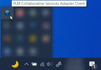

PLM Collaborative Services Adapter Client
The PLM Collaborative Services Adapter (PLMCSA) client (ENOPLMCSAClient.exe) is responsible for client/server communication with the 3DEXPERIENCE platform web services to save, open and manage SOLIDWORKS data within the 3DEXPERIENCE platform. For example, when you save a SOLIDWORKS file using the save commands within the MySession app, the PLMCSA client handles the client/server network communication to the 3DEXPERIENCE platform.
This process involves sending and receiving SOLIDWORKS files (SLDPRT, SLDASM and SLDDRW) to and from the 3DEXPERIENCE platform as well as sending and receiving database operation requests and responses for the 3DEXPERIENCE platform objects.
The PLMCSA client appears in the Windows notification area as a3DEXPERIENCE icon with a tooltip ofPLM Collaborative Services Adapter Client.

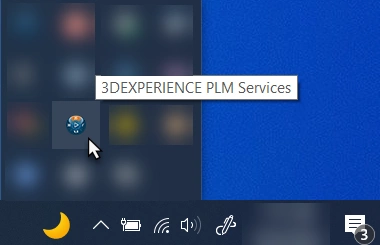

3DEXPERIENCE PLM Services is a small application (EdmServerV6.exe) that assists with the client/server XML messaging activity of the PLMCSA client. The application appears in the Windows notification area as a 3DEXPERIENCE icon with the tooltip

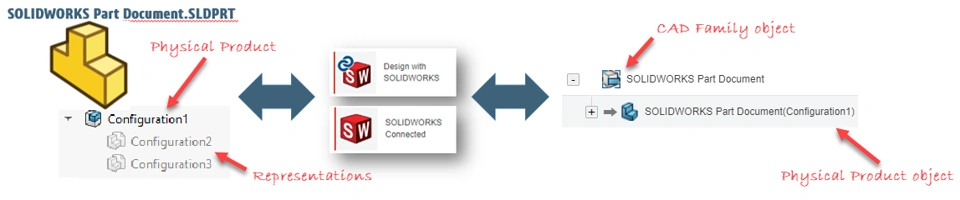

When you save a SOLIDWORKS file to the 3DEXPERIENCE platform, you create objects within the 3DEXPERIENCE platform that correspond to the components of the SOLIDWORKS structure. SOLIDWORKS files and SOLIDWORKS configurations map to certain 3DEXPERIENCE platform objects on the 3DEXPERIENCE platform.
SOLIDWORKS part (SLDPRT) and assembly (SLDASM) files map to CAD Family objects within the 3DEXPERIENCE platform. Each SOLIDWORKS configuration with a SOLIDWORKS part or assembly file maps to a Physical Product object within the 3DEXPERIENCE platform.
CAD Family objects for SOLIDWORKS part (SLDPRT) and assembly (SLDASM) documents with only one configuration are not visible within the 3DEXPERIENCE platform applications. For more information about this behavior, refer to the Knowledge Base Article ID: QA00000102922.
SOLIDWORKS drawing (SLDDRW) files map to Drawing objects within the 3DEXPERIENCE platform.
The following illustration depicts the SOLIDWORKS to 3DEXPERIENCE platform data model for a SOLIDWORKS part document.
In this illustration, a single SOLIDWORKS part (SLDPRT) document that contains three configurations creates one CAD Family object and three Physical Product objects within the 3DEXPERIENCE platform. Each SOLIDWORKS configuration is a Physical Product object.

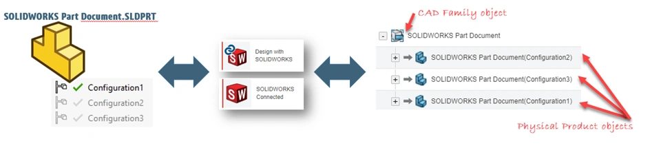

3DEXPERIENCE Compatibility
You do not create 3DEXPERIENCE objects for representations within SOLIDWORKS assembly and part documents after converting the SOLIDWORKS files to 3DEXPERIENCE Compatibility.
The following illustration depicts the SOLIDWORKS to3DEXPERIENCE platform data model for a SOLIDWORKS part document upgraded to 3DEXPERIENCE Compatibility.
In this illustration, a single SOLIDWORKS part (SLDPRT) document that contains one Physical product and two representations in SOLIDWORKS for a total of three configurations. This SOLIDWORKS part creates one CAD Family object and one Physical Product object within the 3DEXPERIENCE platform.

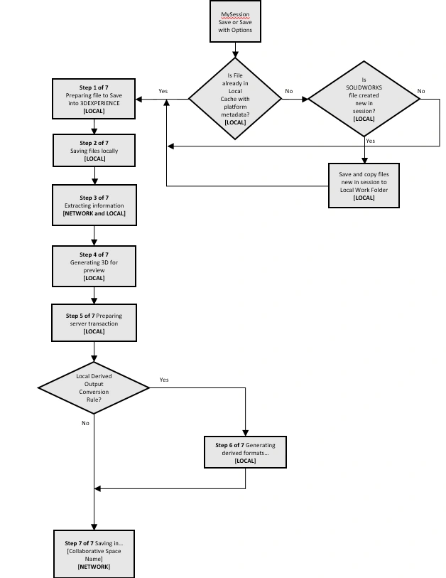

ENOVIA MySession Save Options
The MySession Save options may increase the amount of data or change how you send to the data to the 3DEXPERIENCE platform. Here are the options and how they influence the save behavior.
- Save graphical properties (Default: OFF)

- Save related drawings (Default: OFF)
This options uses the SOLIDWORKS Document Manager API to find related drawings to include in the Save scope (Save with Options dialog) for the SOLIDWORKS structure when Save related drawings option is on.
This activity happens prior to Step 3 of 7 Extracting file information during the save to 3DEXPERIENCE platform save procedure.
You may experience a delay due to this activity if you have many SOLIDWORKS drawings in your local work folder with Save related drawings on.
- Enable save optimization (Default: ON)
This option optimizes what SOLIDWORKS files within the SOLIDWORKS file structure to traverse when building the Save to 3DEXPERIENCE dialog for the list of new and modified files to save when Enable save optimization is on.
Listing fewer SOLIDWORKS files within the Save to 3DEXPERIENCE list results in better performance.
The entire SOLIDWORKS structure is included within the Save to 3DEXPERIENCE dialog when Enable save optimization is off.
This activity is part of Step 3 of 7 Extracting file information… during the save to 3DEXPERIENCE platform save procedure.

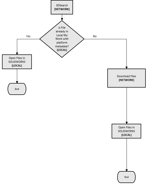

SOLIDWORKS Open Procedure from the 3DEXPERIENCE Platform
3DEXPERIENCE
task pane.
As you can see, if the SOLIDWORKS file does not exist in your local work folder, the time to open the data is heavily dependent on the network plus the time to open the SOLIDWORKS data in SOLIDWORKS.
If you have already saved SOLIDWORKS files to the 3DEXPERIENCE platform that are located locally on your computer, you may not experience as much network activity with the 3DEXPERIENCE platform network services during the open procedure.

Question: What can I do to improve performance if SOLIDWORKS displays the Downloading window for a long time?
Answer: This is the PLMCSA server request operation to download SOLIDWORKS files. Your network performance (bandwidth and latency) is a key influencer for the time that it takes to download the SOLIDWORKS files. Check your network performance by running the Cloud Eligibility tool.
If you are unable to improve your network performance. The size of the SOLIDWORKS files also may contribute to the time it takes to download the files from the 3DEXPERIENCE platform. Review the file size of the SOLIDWORKS files in your local work folder. If any file sizes appear unreasonable based on your design, you may try to open the files in SOLIDWORKS, and make modifications to reduce the size of the file. Examples might include lowering the image quality of the SOLIDWORKS document or removing unnecessary details within the model.
: Why do I see the Open completion is running message after I open a SOLIDWORKS file from the 3DEXPERIENCE platform?
: One scenario where this may happen is when you open a SOLIDWORKS assembly document with many suppressed components that do not exist in the local work folder, and the suppressed components include SOLIDWORKS files with very large file sizes.
The first PLMCSA requests gather the structure and metadata from unsuppressed components, then downloads the unsuppressed components. SOLIDWORKS opens the assembly, and then in parallel, the PLMCSA client requests to download the SOLIDWORKS files for the suppressed components as well as the metadata for the entire structure of the assembly document.
The PLMCSA server request to collect the entire structure including downloading additional files and metadata of all objects within the structure may still be downloading the suppressed components or gathering the metadata.
SOLIDWORKS Save Procedure to 3DEXPERIENCE Platform
The following workflow image provides a summary of what happens when you save a SOLIDWORKS file in the MySession app within the
3DEXPERIENCE
task pane.
See theFAQfor additional questions about the save process.
FAQ
Question: Why might the Step 2 of 7 Saving files locally… process take a long time while saving a SOLIDWORKS assembly document?
Answer: Confirm that the MySession > Options > Save tab > Save information about weight and balance option is active. This option requires that the Tools > Options > System Options > Performance > Update mass properties while saving document option in SOLIDWORKS is also active. Assembly documents that contain complex components may take additional time to recalculate the mass properties.
If you experience a significant delay accessing Tools > Evaluate > Mass Properties in SOLIDWORKS or when clicking Recalculate in the Mass Properties dialog box, then this could be the source of the delay.
Additionally, check for perpetual rebuild lights or files in a permanent modified state within the SOLIDWORKS FeatureManager Design Tree structure. SOLIDWORKS files always in a modified state are always saved during this step.
Question: Why might the Step 3 of 7 Extracting file information... process take a long time while saving a new simple SOLIDWORKS part document?
Answer: First, consult your 3DEXPERIENCE platform administrator to confirm that the Check for file uniqueness option is active. Next, review the
3DEXPERIENCE files on This PC
tab to determine how many files exist in your local work folder. This step queries the files in your local work folder. If thousands of files exist in the cache, this procedure may take longer than expected.
Question: Why might the Step 6 of 7 Generating derived formats… process take so long?
Answer: If your 3DEXPERIENCE platform administrator created a conversion rule such as Step_AP203 with SOLIDWORKS (Synchronous, at save) for a SOLIDWORKS part and you save a SOLIDWORKS part document with many configurations, you may experience this behavior.
SOLIDWORKS needs to create a .Step file for each configuration during the save process.
