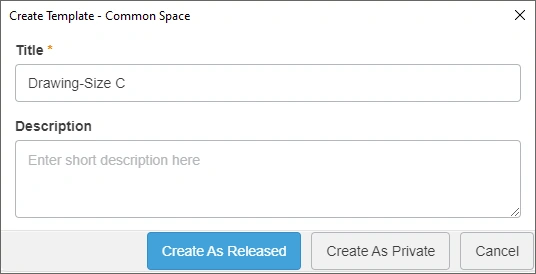

Create Template
If a template is new (does not yet exist in3DEXPERIENCE), all theSavecommands open theCreate Templatedialog box shown in the following image:
In this dialog box, you can:
  • Specify a Title. In the default state, the title specifies a template file name without an extension.
  • Specify a Description. In the default state, the description is empty.
  • Create As Released. This option stores the template in 3DEXPERIENCE in a Released state.
  • Create As Private. This option stores the template in 3DEXPERIENCE in a Private state.

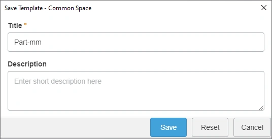

Edit Template
If a template file already exists in 3DEXPERIENCE, all Save commands open the Save Template dialog box shown in the next image. Silent save is not supported for templates.
In this dialog box you can:
  • Override the Title and the Description.
  • Save the template modifications.
  • Reset fields to the default value.

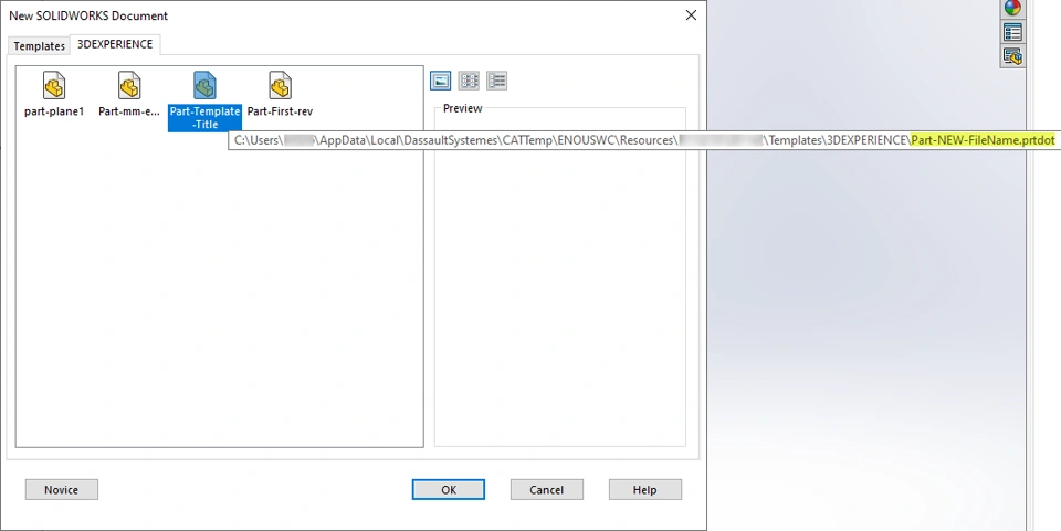

After saving the template in 3DEXPERIENCE:
  • MySession refreshes and shows 3DEXPERIENCE information that relates to the template.
  • The template file becomes available in the New SOLIDWORKS Document dialog box from SOLIDWORKS File > New, under the
    3DEXPERIENCE
    tab.
Template Title
Title is a 3DEXPERIENCE attribute. Template titles do not affect file names of the target objects (part, assembly or drawing). Modifying an existing template title, as described in section b), also does not affect its file name. Templates appear with the titles in the
3DEXPERIENCE
tab of the New SOLIDWORKS Document dialog box.

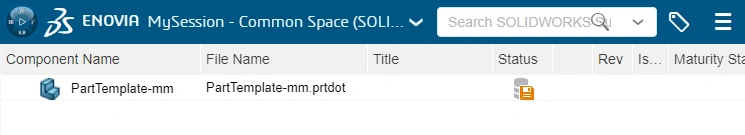

Templates in the MySession Widget
Templates cannot have external references. Therefore, MySession shows a single row when a template is open in SOLIDWORKS:
The icon shown in the Component Name column corresponds to the icon of the target file type.
Template File TypeIcon shown in MySessionTarget File Type
.asmdotAssembly
.drwdotDrawing
.prtdotPart

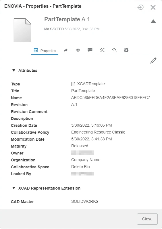

SOLIDWORKS templates saved to 3DEXPERIENCE have the following characteristics:
  • 3DEXPERIENCE object type = XCADTemplate, governed by the Engineering Resource Classic collaborative policy.
  • The
    Create Template
    command only includes Private and Released maturity state options. However, the policy has more states, and you can promote or demote to any other states. In the Platform Management dashboard, the maturity graph for templates is defined in –
Collaborative Spaces Configuration Center > Maturity Graph > Engineering Resource

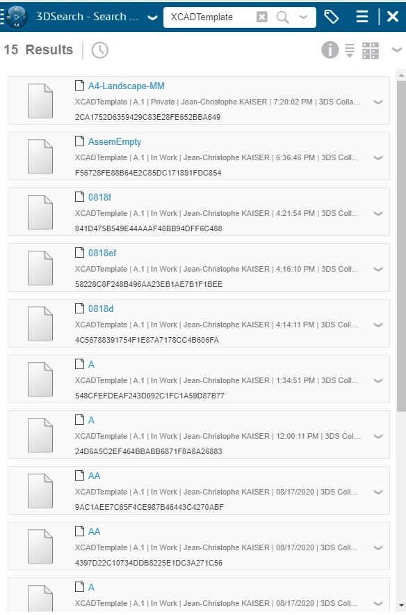

  • Are indexed and searchable in 3DSearch.
  • You can delete them using the Collaborative Lifecycle or Bookmark Editor app. Administrative privileges are required to delete templates in the Frozen, Released and Obsolete states.
Downloading Templates From 3DEXPERIENCE to a Computer
After establishing a connection to the 3DEXPERIENCE platform, SOLIDWORKS automatically downloads missing or outdated SOLIDWORKS templates from the collaborative spaces that you have access to, to your local machine. This means that, the app -
  • Downloads the templates that exist on 3DEXPERIENCE but not on your local machine.
  • Removes the Obsolete templates from your local machine.
  • Replaces previously downloaded outdated templates with the latest ones – within the same revision.
  • For a template with multiple revisions on 3DEXPERIENCE, downloads the latest revision if you make the older revisions Obsolete.
SOLIDWORKS downloads the templates to the following location on your machine:
%LOCALAPPDATA%\\DassaultSystemes\\CATTemp\\ENOUSWC\\Resources\\[tenant ID]\\Templates\\3DEXPERIENCE.
For example, a template ‘PartTemplate-mm.PRTDOT’ saved to 3DEXPERIENCE is downloaded as -
C:\\Users\\abc\\AppData\\Local\\DassaultSystemes\\CATTemp\\ENOUSWC\\Resources\\R1234567890123\\Templates\\3DEXPERIENCE\\ PartTemplate-mm .PRTDOT
