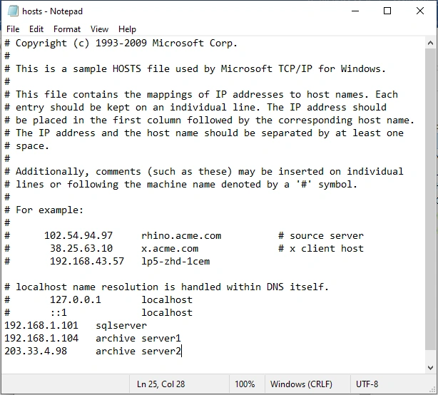

In a multi-site environment, there might be two or more separate network domains. In one domain, you could find the Microsoft SQL Server® installation and one archive server. The other domains may contain a remote archive server. For the servers to communicate with one another across a wide area network (WAN), a working virtual private networking (VPN) connection is a requirement between all sites. Each site should be able to resolve system names for remote servers to an IPv4 address. You can configure name resolution to an IP address by editing the hosts file on each server. SOLIDWORKS recommends this approach, where the hosts file for each server includes new lines with the IPv4 addresses and the system names of all remote servers with which the local server must communicate. The hosts file exists in the following folder:
C:\\Windows\\System32\\drivers\\etc\\hosts
To modify and save the system protected hosts file, you must open the file in a text editor (such as Notepad) as an administrator.

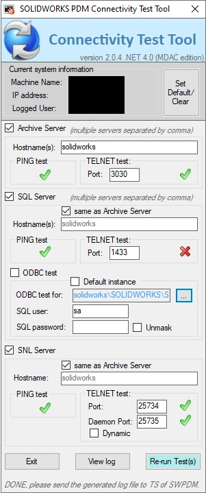

d) Testing SOLIDWORKS PDM System Connectivity
To verify the connectivity (typically between client and server) of the SWPDM system use the connectivity tool provided in DS KB article QA00000119794 “Is there a 'Connectivity Test Tool' for SOLIDWORKS® PDM to verify network communication between a client and server or between replicated servers to ensure the server and service ports are accessible?” This tool generates a log file that you can share with a VAR or with SOLIDWORKS Technical Support to assist with the diagnosis of any issues.

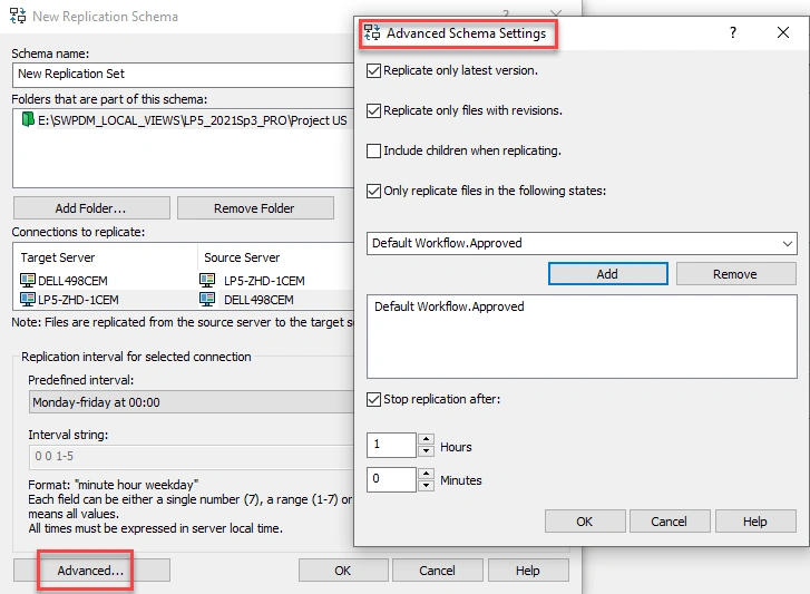

a) Replication Schemas
The following image depicts the correct way to set up SOLIDWORKS PDM for replication across a WAN:

The first question that comes to mind is what is the best time to schedule replication on each replicated site? The recommendation is to schedule replication to occur when no user is working in the vault. This ensures that the replication does not affect users because of a decrease in the available bandwidth. Running scheduled replication outside of business hours does not mean that users cannot replicate newer file versions from a remote archive server during regular business hours. On-demand replication is available for that purpose.
When setting up replication schedules, use the local time of the target archive server.
If a new replication schedule specifies that the source server is the UK archive server and the target server is the US archive server, then setting the schedule to 7 pm means that replication starts at 7 pm Boston time. This is a good time because no users are working in the vault. Therefore, all the bandwidth becomes available for file replication across the WAN.
Another possible replication schedule might specify that the source server is the US archive server and the target server is the UK archive server. Setting this schedule to midnight means that replication starts at midnight UK time (7 pm US time). Again, there are no or few user connections to the vault at this time.

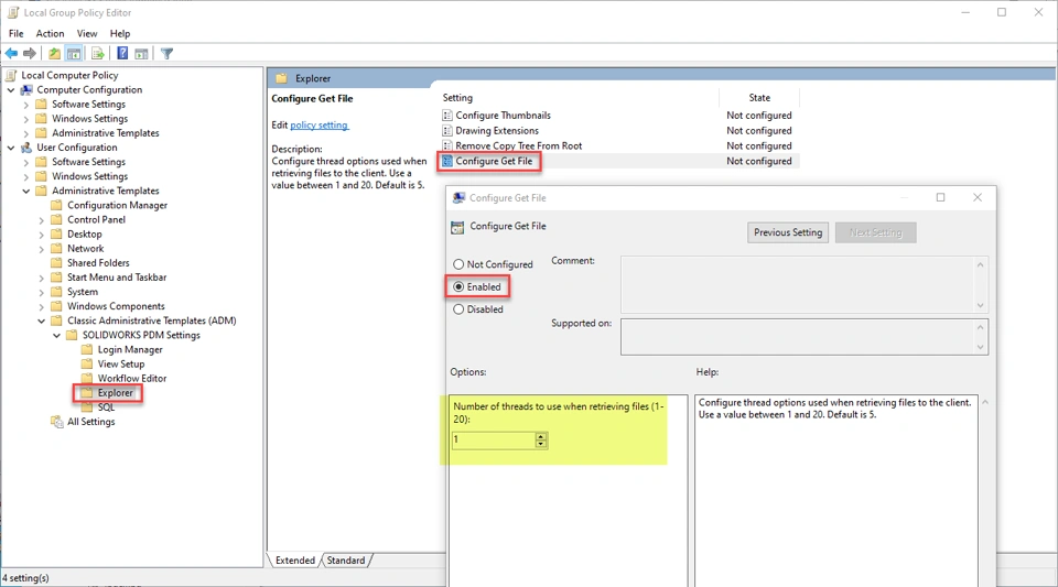

By default, the replication retries twice before timing out. You can use a registry key to change the number of retries as detailed in the DS KB article QA00000122869 “In a SOLIDWORKS® PDM replicated environment, why is the value of the ‘RetriesCount’ registry key larger than 1?” Customers are encouraged to contact their VAR for assistance with this solution.

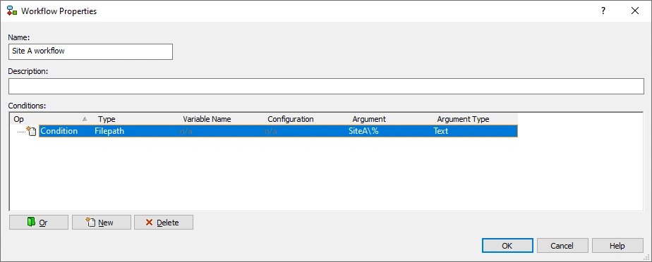

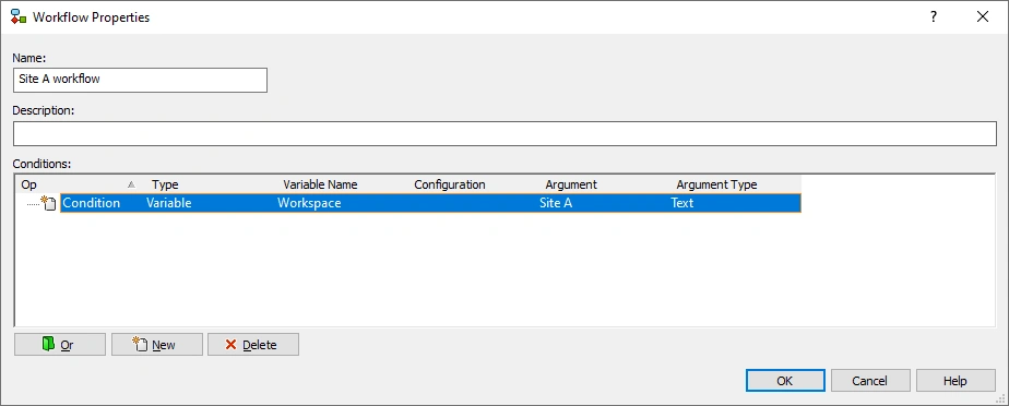

a) Site-Specific Workflows
The easiest way to configure SOLIDWORKS PDM to use different workflows for each site is to use a condition on a folder structure as shown in the following image:
…or use a variable value condition as shown in the next image.
It is possible to automate the writing of the Workspace variable value by creating site-specific SOLIDWORKS PDM templates, which you can configure to be visible only to a group or users that belong to the correct site.

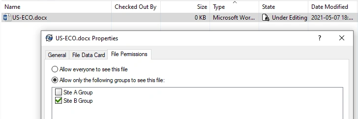

Another alternative is to use file-based permissions. To set file-based permissions, right-click the Properties option for a file.

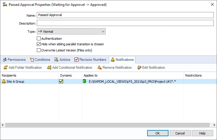

c) Notifications
Similar to the way you can restrict file access to site-specific groups, you can also assign notifications to site-specific groups.

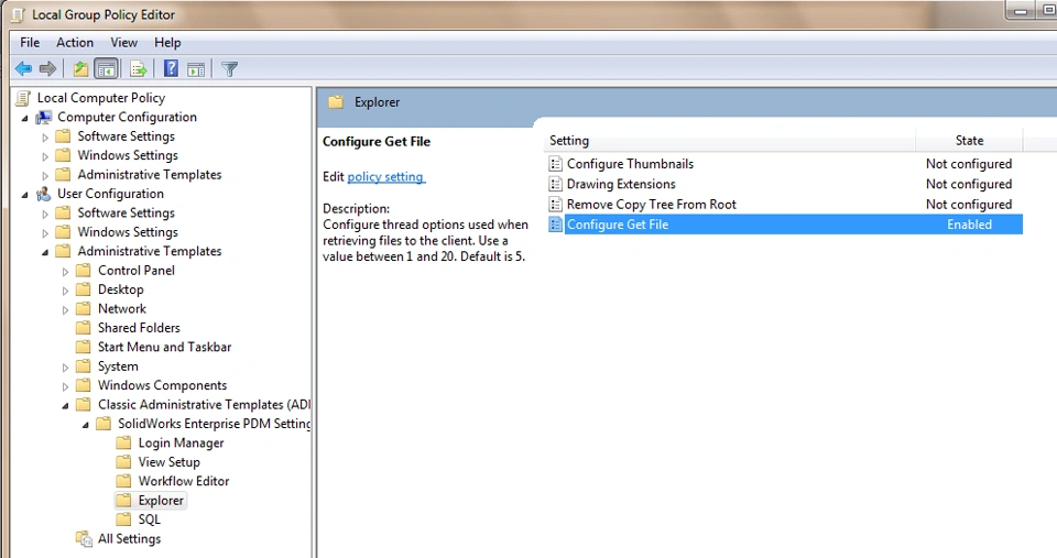

To improve SOLIDWORKS PDM performance over a network, some SOLIDWORKS customers successfully use WAN optimization techniques to prioritize, accelerate, load balance or load share SOLIDWORKS PDM related network traffic alongside other network traffic. These techniques fall outside the scope of this document. For more information about this, consult your IT representative.

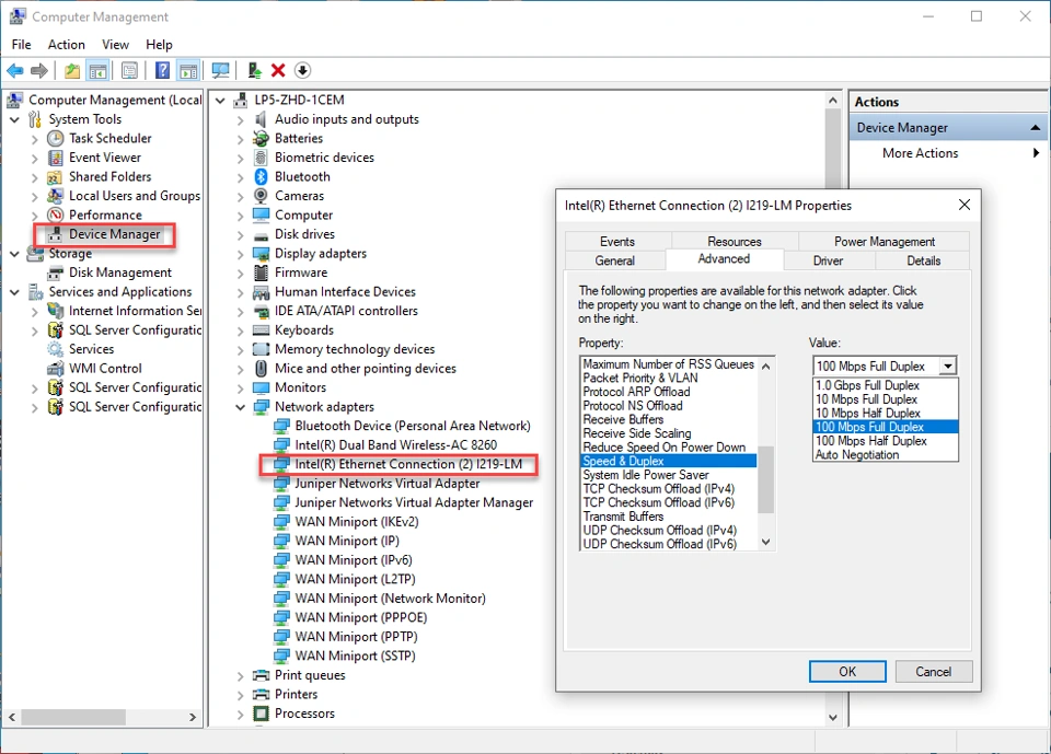

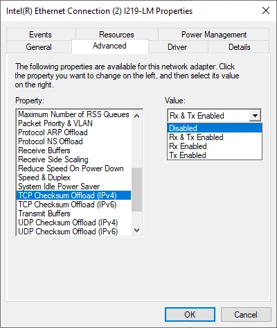

b) Network Adapters: Mismatched Duplex Settings
A common problem that affects network performance comes from mismatched duplex settings between client to server, server to client and server-to-server network adapters.
The recommendation is to try different duplex speed settings to determine which duplex speed is the best for transferring data across the network. You should never use half-duplex speed settings. Instead, try different full-duplex speeds and auto modes.
A simple way to measure this is as follows:
  1. In the Device Manager section of the Windows Computer Management console, specify 100 Mbps Full Duplex as the network adapter duplex speed for Computer A as shown in the following image:
   2. Specify the network adapter duplex speed of 100 Mbps Full Duplex for Computer B.
   3. Create a network share on Computer B.
   4. Copy a large (30 MB+) SOLIDWORKS file from Computer A to the network share on Computer B.
   5. Record how long it takes to complete the copy.
   6. Repeat steps 1-5 using a different duplex speed (such as Auto Negotiation).
After recording the exact times for each full and auto duplex speed, compare the timings and determine which duplex speed specification provides the best optimization for data transfer between two computers.
c) Network Adapters: Checksum Offload
For most common network traffic, offloading checksum calculations to the network adapter hardware offers a significant performance advantage by reducing the number of CPU cycles required per byte. However, it is possible that offloading checksum calculations to the network adapter can cause severe slowness when working with the SOLIDWORKS PDM Add-in.
In such cases, you might consider disabling checksum offload to see if performance returns to a more normal state.
Only consider changing this specification if you experience unusually slow performance.
d) Network Bandwidth: Advanced Replication Settings
To minimize the number of files that replicate across the WAN, SOLIDWORKS PDM provides advanced archive server replication settings to help fine-tune bandwidth usage. The advanced settings provide the following options:
  • Replicate only the latest version of files
  • Replicate only files that have a revision
  • Replicate children
  • Replicate only files in a specific workflow state
The Stop replication after option can be useful to force a scheduled replication to stop after a specific amount of time. A common scenario is to stop scheduled replication an hour before users begin their workday. This helps to ensure maximum availability of bandwidth.

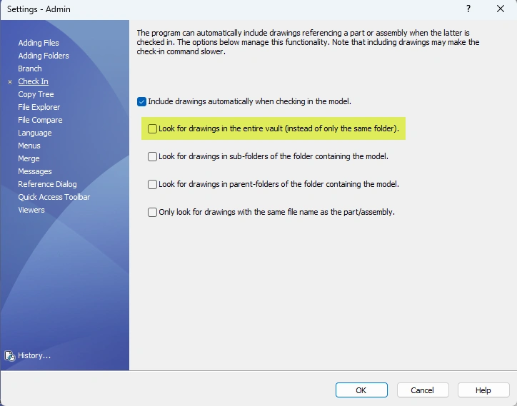

For check-in operations, turning off the Include drawings automatically when checking in the model option can reduce the amount of time it takes to display the Check In dialog box, because the database query does not have to include all the drawings. Deactivating the Look for drawings in the entire vault option lists only drawings that exist in the same folder.

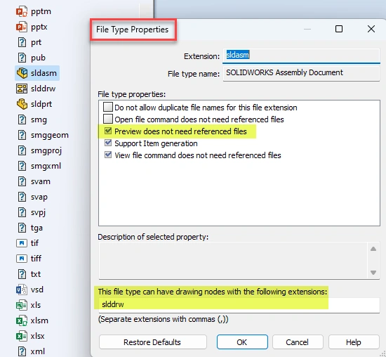

It is also possible to improve performance when previewing SOLIDWORKS assembly or drawing files by activating the Preview does not need referenced files option in the File Type Properties dialog box. This prevents SOLIDWORKS PDM from caching referenced files when previewing assembly or drawing files in the eDrawings window.

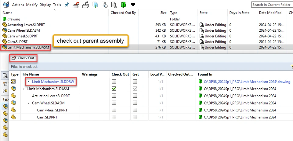

Another setting that can negatively affect performance when calling the Get, Change State or Check In dialog boxes is the option This file type can have drawing nodes with the following extensions (see above image). This option is active by default for SOLIDWORKS assemblies and parts. Clearing the link to the slddrw file type prevents SOLIDWORKS PDM from displaying parent drawings in the reference tree display of the Get, Change State and Check In dialog boxes.
If this option is active, checking out a file used by a drawing displays the parent drawing in blue in the reference tree.
f) Explorer Get File Policy
If you experience slow operations when caching large assembly or drawing structure files in a vault view, it is possible to configure the SOLIDWORKS PDM Explorer Get File group policy to use fewer threads.
Enabling and configuring this policy to use only one thread when retrieving files can noticeably reduce the time it takes to cache a large number of files in a vault view.
For more information about how to configure this policy, see the chapter “Specifying SOLIDWORKS PDM Settings Group Policy Manually” in the “SOLIDWORKS PDM Installation Guide”.
You can apply this group policy client setting to SOLIDWORKS PDM clients in both replicated and non-replicated environments. If in a replicated environment, be aware that this setting does not effect on-demand replication, which is a single-thread operation by design.
