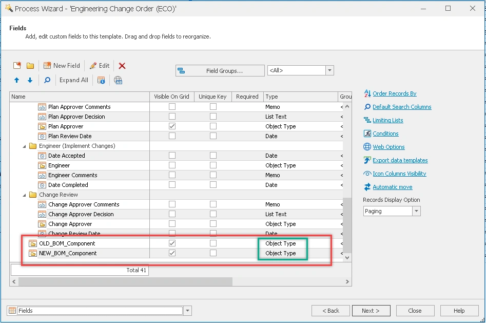

Each workflow stage can have multiple automated outputs, which can perform various actions such as creating new records, updating existing ones, changing PDM states, adding related files, exporting files, and more. The ‘Replace BOM Items’ output is one of these actions. It allows you to replace an item with another in the Bill of Materials of the affected process items. However, it only replaces manually added BOM items and does not affect items added through SOLIDWORKS, for example.This process output requires the configuration of two Object Type fields within the process itself. If these fields have not yet been created, you’ll need to close the configuration page and set them up before proceeding.

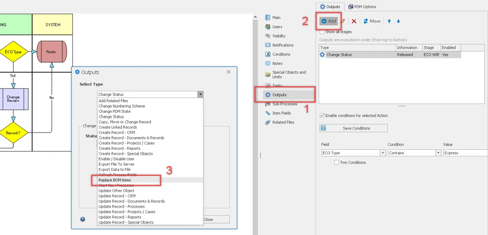

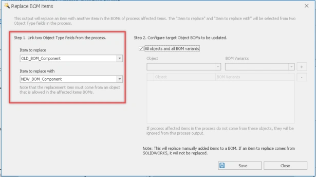

STEP 1. Link two Object Type fields from the process. Navigate to Workflow Properties > Choose the desired stage > Access the Outputs section > Set the type to Replace BOM items.
- Select Item to Replace from the Drop-Down List: This option will only display object type fields that are available within the current process.
 - Select Item to Replace With from the Drop-Down List: This option will only display object type fields available within the current process.

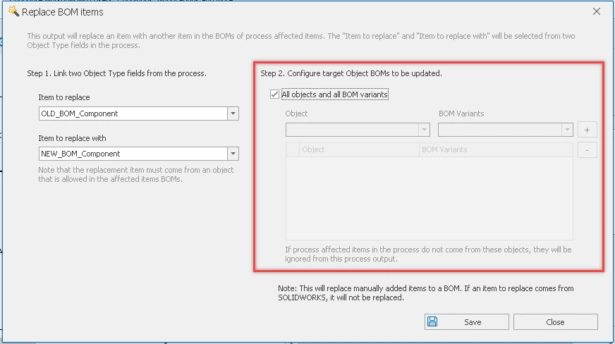

STEP 2. Configure target object BOMs to be updated.
In this step, you will configure the BOMs that can be modified using this output.
- If you select the "All Objects and All BOM Variants" option, all BOMs will be updated. However, if the "Item to Replace With" is not permitted in a specific BOM, it will not be replaced, and the user will be notified of the reason.
 - If you deselect the "All Objects and All BOM Variants" option, you will be able to select specific objects and their corresponding BOM variants. This means that any process-affected items that do not originate from these specified target BOMs will be ignored.
 - Finally, click Save and Close.

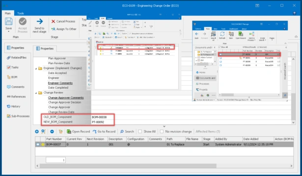

Once you’ve configured the fields and the ‘Replace Output BOM’ output, open the process record and add or select the corresponding values in the object type field.

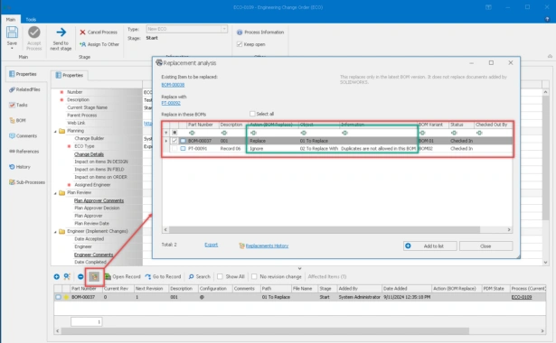

After saving the record, click the ‘Replace Analysis’ button as shown in the image. A pop-up window will appear, displaying the Record to Replace and the Record to Replace With.
You can select records by checking the box next to each one. Click ‘Add to List’ to save your selections. Once this is completed, the records will be replaced at the end of the process stage where the ‘Replace Output BOM’ action is configured.

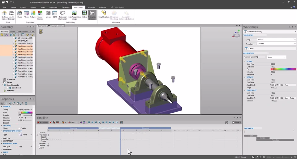

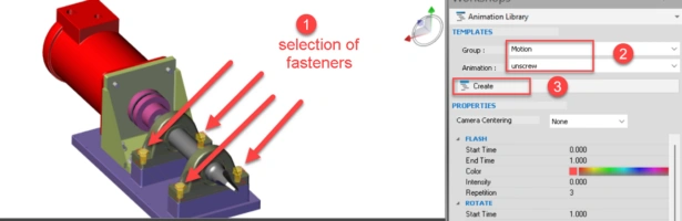

Let us create some predefine animations on the Overturning Mechanism assembly. We will create the animation of the fasteners unscrew from the assembly.
- We select the fasteners. Refer the below image.

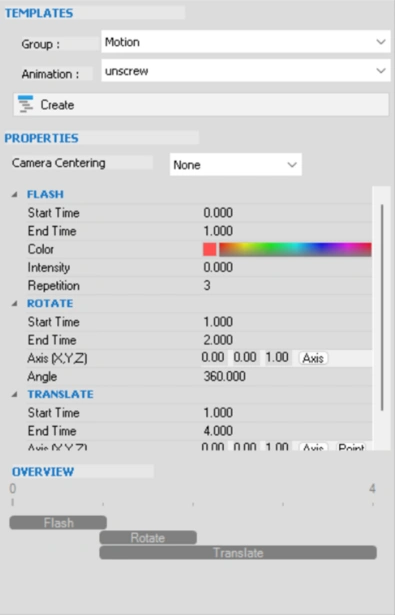

 - Go to Animation Library
 - Select Motion in Group dropdown
 - Select Unscrew in Animation dropdown
 - Click Create
Unscrew animation is made of a sequence of Flash, Rotate and Translate animations.
As the name says ‘Flash’, Highlights, ‘Rotate’ Rotates and ‘Translate’ Translates the selected actors. Let’s go in detail of each sub animations. Each sub animation has its own Start and End time. This means, the sequence of animations is customizable.

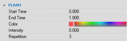

- For the Flash, we can define Color of highlight, Intensity of the emission and Highlight

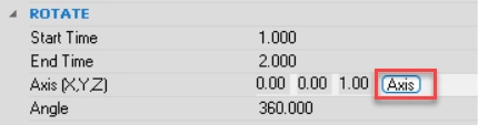

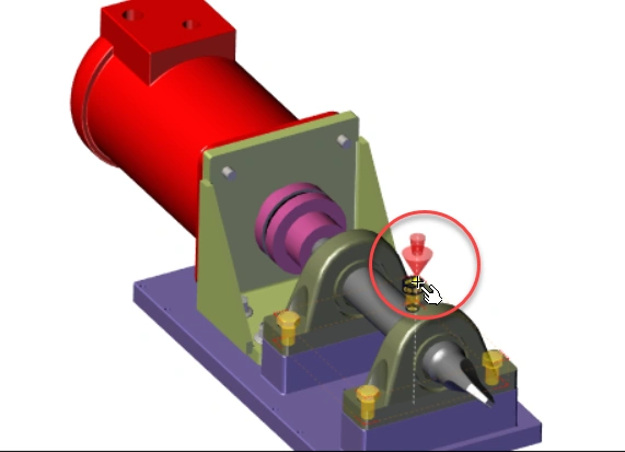

 - Under Rotate, choose axis of rotation X, Y and Z. Enter value ‘1’ for the axis to make in use. Instead of choosing axis, we pick the axis of the actors. To do so click on Axis > press Alt to pick center of axis of the actor. Of course, for unscrewing we keep the default Angle of rotation 360.

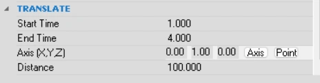

 -  For the Translate animation, we follow the same method to select axis for direction of translation as mentioned in Rotate animation. Also provided distance of translation.

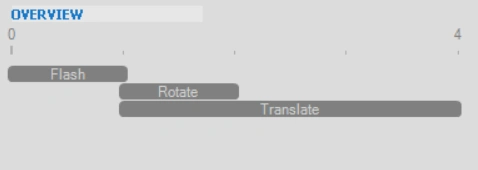

 On every change in parameters the Overview gives a graphical overview of the order of motions in global animation.

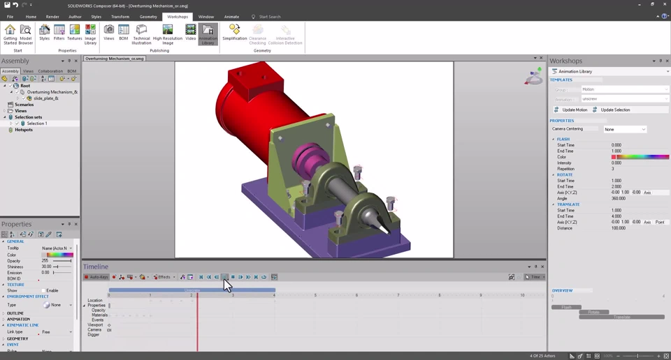

Once the we are satisfied with necessary changes, run the animation.
In the Timeline, check the animation block is created. This block can be expanded, collapsed and even move across the timeline. Animation blocks consists of multiple animation keys restricted to the respective blocks. This avoids the situation of overlapping of multiple animations with individual keys in the Timeline. You can also create multiple animation blocks and manipulate them together.

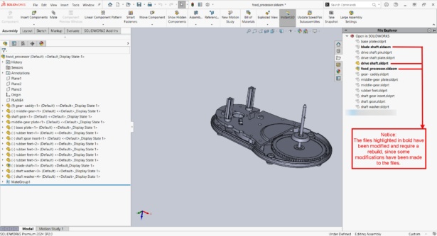

 - Use File Explorer and look for files with bold highlights when you use Open in SOLIDWORKS from the Task Pane. Files in bold have been modified and may have a Dirty Mark.

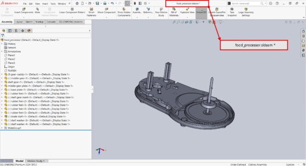

 - An assembly immediately displays a dirty mark when it is opened, and even though no changes have been done, SOLIDWORKS prompts us to save data when we try to dismiss the assembly:
Sometimes, upon opening the assembly, the assembly displays a Dirty Mark (*) icon, as shown below:
