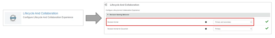

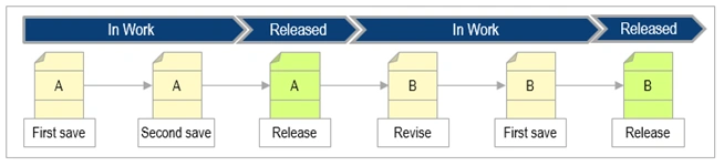

The 3DEXPERIENCE platform provides for primary and secondary revision values. Each new customer 3DEXPERIENCE tenant is set to use primary revisions by default. The primary value is the main revision of the object that is used at release, and its schema can be set to be alphabetical or numeric.
When using both primary and secondary revisions, the secondary values represent subsequent iterations that are used before the object is ready. When an item is promoted to the released maturity state, both the primary and secondary values are displayed, and the primary value should be used to identify the revision.
For example, when a user creates and saves a new part, it is assigned the revision A.1. After an operation to modify and save the part, if the user selects the new revision option in the Save to 3DEXPERIENCE dialogue box, a new revision A.2 will be created. When the part is released, the revision value will still be displayed as A.2. The value A is the primary and the .2  is the secondary value. If a new revision of the released part is created, its primary revision will increment to B and the secondary will reset to .1.

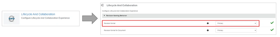

Settings controlling the Revision schema and revision behavior are located in the Collaborative Spaces Configuration Center. If a client is adopting the use of primary revisions only, it’s recommended that the following settings are considered.
  • Set the revision format to Primary (default setting for new tenants)

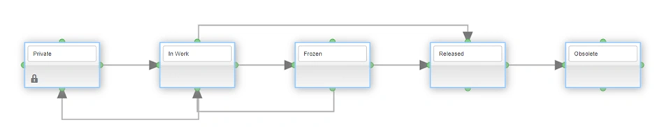

3DEXPERIENCE provides clients with a preconfigured lifecycle for SOLIDWORKS parts, assemblies and drawings, consisting of five states. This is called the Engineering Definition Maturity Graph.

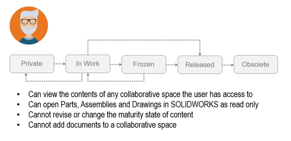

The following images show each collaborative space role and their access level in context of the Engineering Definition maturity graph.
Contributor

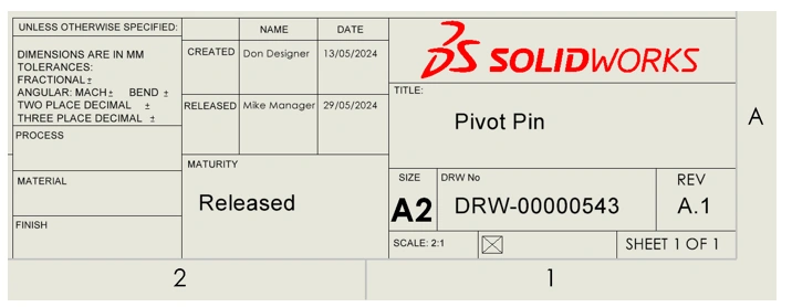

Displaying 3DEXPERIENCE Revision and Lifecycle Information on a SOLIDWORKS Drawing
Its common practice to display important information related to the revision and lifecycle on a SOLIDWORKS drawing. Therefore, the setup of a customer’s drawing templates to display lifecycle related information such as Maturity, Revision, Released Date etc. will need to be considered as part of every implementation of the 3DEXPERIENCE platform.

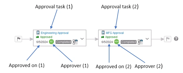

  • The supported attributes are:
    • Approver (x) x represents the "x" (in time) approver of the drawing
    • Approved on (x) x represents the date when the "x" (in time) approval has been set on the drawing
    • Approval task (x) x represents the route task title used when the "x" (in time) approval has been set on the drawing
