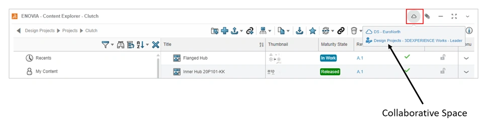

After creating a new collaborative space, before saving any files from SOLIDWORKS Design, it is important to ensure that the SOLIDWORKS session is connected to the desired collaborative space. The top bar of the MySession task pane area displays the name of the collaborative space that the current session is connected to. Any new files saved to the 3DEXPERIENCE platform will be automatically assigned to this collaborative space (unless the user chooses a different space in the Save to 3DEXPERIENCE dialogue box).
To switch SOLIDWORKS Design to a different collaborative space, select the drop-down arrow next to the collaborative space name, click on the preferences icon, and set the credentials to the desired collaborative space.
All new files saved to the 3DEXPERIENCE platform for the first time will be assigned to the collaborative space displayed under Credentials.

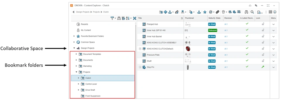

As stated previously in this section, Collaborative Spaces are not intended to act as folders, and the content contained within a Collaborative Space is stored in a flat structure. To help you transition from folders to the 3DEXPERIENCE platform, it is strongly recommended that you are familiar with Bookmark folders as the primary method of organizing your SOLIDWORKS Design content. Bookmark folders behave similarly to Windows folders; users can add SOLIDWORKS content to a Bookmark for easy access, and create Bookmark hierarchies in the same way that they would folder structures.
Bookmark folders are created and accessed using either the Bookmarks Editor app, or the Content Explorer app which is located on the Content tab of the Collaborative Designer for SOLIDWORKS cockpit. The Content Explorer app will display each collaborative space, and the bookmark folders that belong to each collaborative space.
Note: Prior to 2026xFD04 the Bookmarks Editor app was displayed by default on the Content tab of the SOLIDWORKS Design & Collaborative Design for SOLIDWORKS Cockpits. Customers with tenants from 2026x FD03 and earlier can replace the Bookmark Editor app with the Content Explorer app on the Content tab.

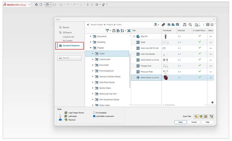

Bookmark folders can also be accessed from inside SOLIDWORKS Design via Content Explorer. A SOLIDWORKS Design part, assembly or drawing can be added to a Bookmark folder when saving it to the 3DEXPERIENCE platform, and files can be opened in SOLIDWORKS Design directly from a Bookmark folder in the same way a user would have previously done using folders.
Organizing SOLIDWORKS designs with Bookmark folders provides a folder-like experience and will provide continuity through a familiar way of working, aiding adoption in the early stages.
Once users become more familiar and comfortable with finding and navigating their Bookmarked content, other methods of content organization can be introduced that utilize the 3DSearch and 6WTag filtering capabilities to increase productivity further. However, for many users, Bookmarks will meet all of their needs.

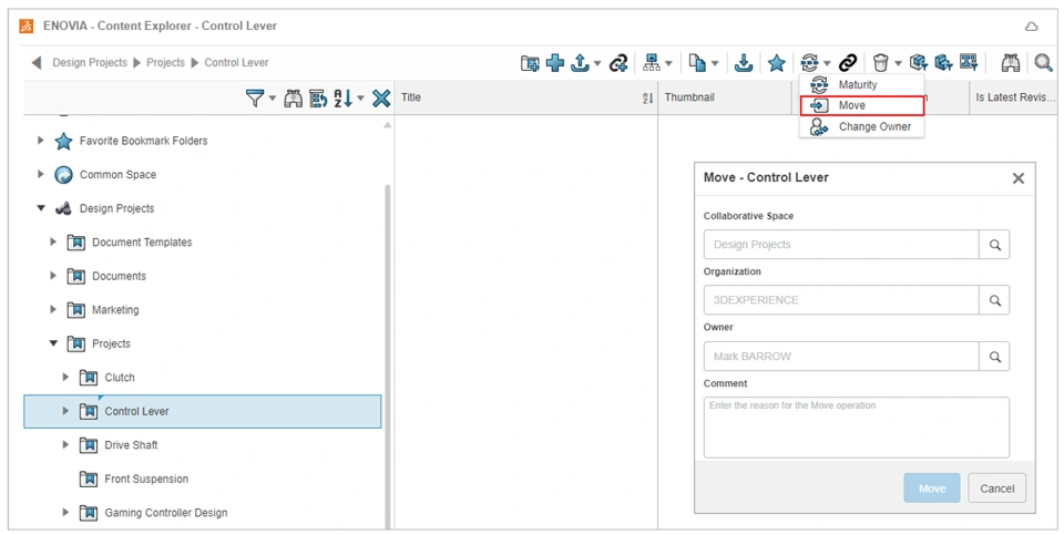

Note: If a user accidentally creates a Bookmark folder in a different Collaborative Space from the one in which they intended, it can be easily moved by selecting the Bookmark folder and using the “Move” command from the Content Explorer toolbar.

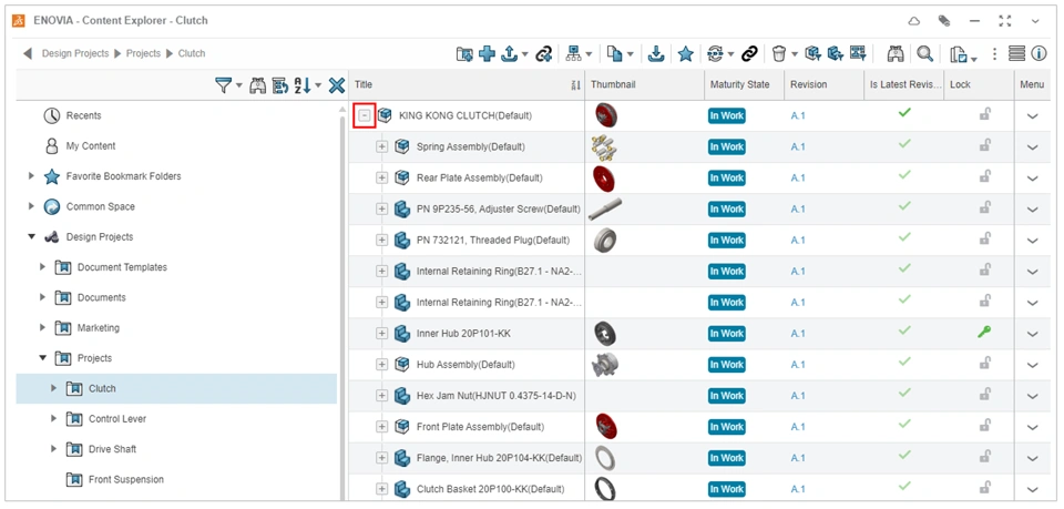

​​​​​​​Another recommended preference for Bookmarking SOLIDWORKS Design content is “Enable Expansion of Products. This preference is on by default and allows the user to expand a Bookmarked Assembly to view the complete structure without needing to have any of the child parts or sub-assemblies individually bookmarked.

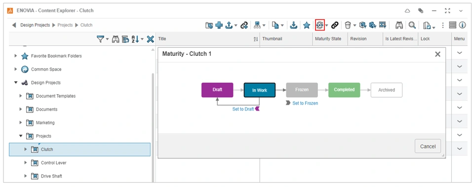

Like Windows folders, Bookmarks can be shared with other users. When a Bookmark folder is created in a collaborative space, by default, it will be visible to other users. The visibility is governed by the Maturity State of the Bookmark folder, and by default, all new Bookmarks are set to the In Work state. When Bookmark folders are set to the In Work state, they are visible to all members of that Collaborative Space. To make a Bookmark folder only visible to the person who created it, set the maturity state of the Bookmark folder back to the Draft state using the Lifecycle command from the Content Explorer toolbar.
The default maturity state of new Bookmark folders can be set in the Bookmarks section in the Collaborative Spaces Configuration Center.
Some design teams may prefer to keep all new Bookmark folders private to each user and have them choose to share a Bookmark with other team members. In this scenario, the option Set the Maturity State to In Work should be unchecked.
