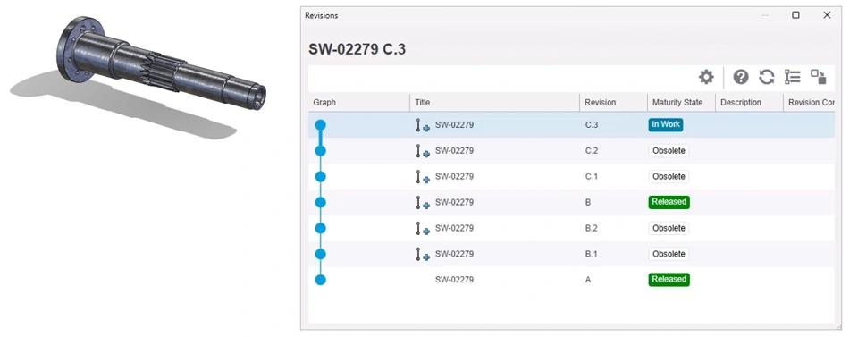

In addition to each release, many customers will have a need to manage different stages of a design in between each major revision. In this scenario, a secondary revision value can be used capture the intermediate stages between each major release.
When using both primary and secondary revisions, the secondary values represent subsequent revisions that are used before the object is ready for a major release. Each secondary revision has its own lifecycle and act as a method of managing in design processes between major releases e.g Simulation studies, external stakeholder collaboration. Secondary revisions can also be used to manage formal iterations during a design phase.
When an item is promoted to the released maturity state (Primary and Secondary Governed Format), only the primary value is displayed.
For example, when a user creates and saves a new part, it is assigned the revision A.1. After an operation to modify and save the part, if the user selects the new revision option in the Save to 3DEXPERIENCE dialogue box, a new revision A.2 will be created, and A.1 will be automatically set to Obsolete. When the part is released, the revision value will still be displayed as A. If a new revision of the released part is created, its primary revision will increment to B, and the secondary will reset to .1.
In summary, primary revisions are used for a new major release of an object, whereas secondary revisions should be used for managing in design processes, major iterations, and minor changes.

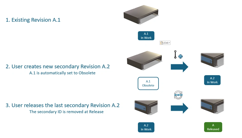

If adopting the use of both primary and secondary revisions, Primary and Secondary Governed is the recommended format.
  • Set the general format to Primary and Secondary Governed
When using Primary and Secondary Governed, the secondary revision will be removed when a part, assembly or drawing is Released. When a new secondary revision is created, the previous secondary revision will be automatically set to Obsolete. This ensures that there is only ever one secondary revision In Work at any time.
