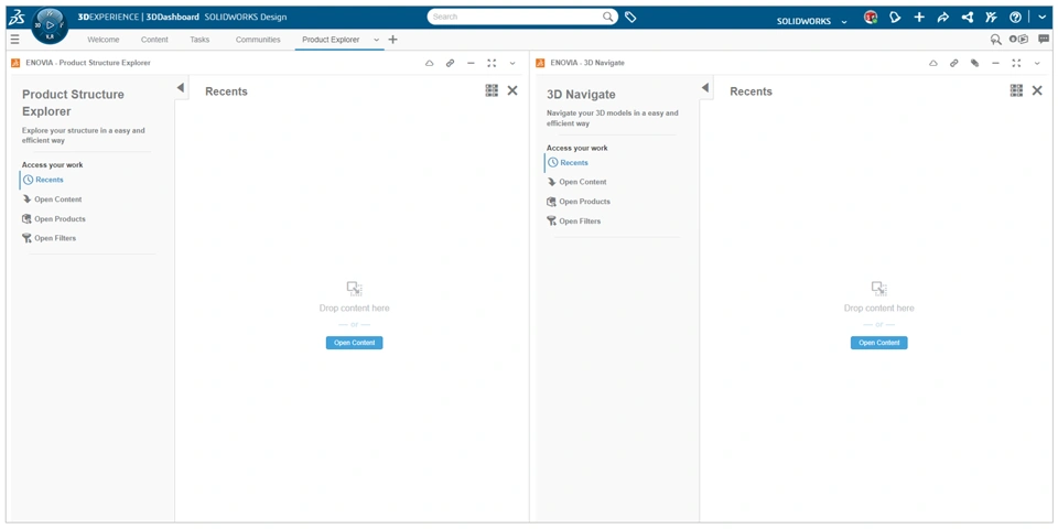

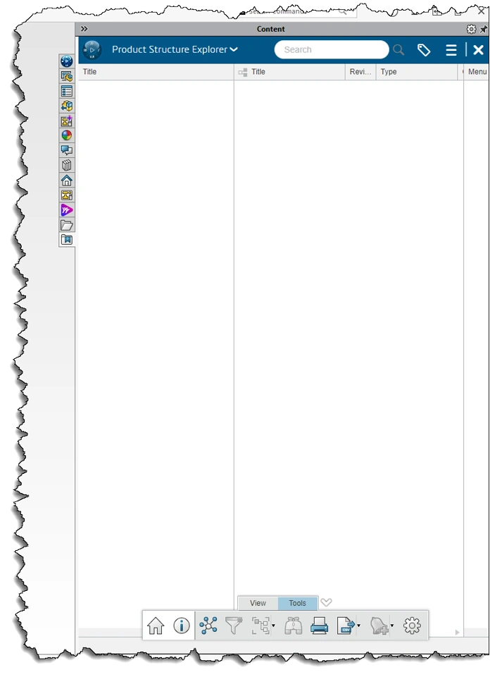

  1. Filters can be created in several applications:
    1. From Product Explorer on the 3DEXPERIENCE platform:
      Tip: Create a new tab on the SOLIDWORKS Design Cockpit and add the Product Explorer app to it.
    2. From Product Structure Explorer in MySession:
  2. To create a Filter, click on the Filter button Tools tab on the Action Bar:

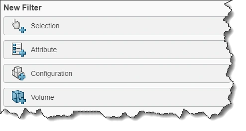

  3. Choose your filter criteria. There are four rule types:
    1. Selection: Keep and/or remove subassemblies or parts based on what you manually select.
    2. Attributes: Select the object type, name, maturity state, or other PLM properties.
    3. Configuration: Choose defined product configurations.
    4. Volume: Define the region around your part of interest using a bounding box, bounding sphere, or proximity range.
      Note: You can apply multiple rule types in a single Filter, and you can reuse and share the same Filter for design work, collaboration, reviews, BOM checks, and other downstream tasks.

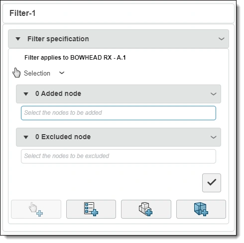

  1. Selection
    1. To include objects, click the Added node field. In the main structure view, select the physical products that you want to include in the filtered structure.
    2. To exclude objects, click the Excluded node field. In the main structure view, select the physical products that you want to exclude from the filtered structure.
    3. Click the check mark at the bottom to finish the Selection rule.
    4. Add additional rules to the Filter or click Apply to see the filtered structure.

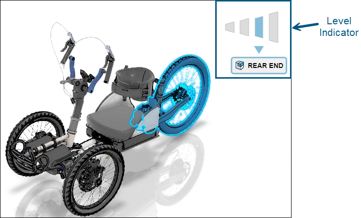

    Tips:
    1. Click on a part in the graphic window and use the level indicator to easily select different levels of a sub-assembly.
    2. Right click on a part and select Hide/Show to help navigate parts you can't see

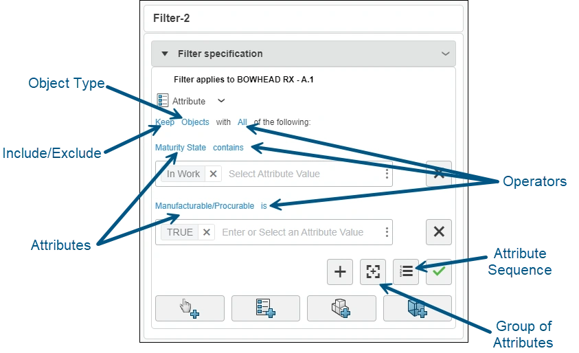

  2. Attributes
    1. Type of Object - specify a type of object (Object, Physical Product, etc) to include or exclude in the filtered structure
      1. If you want to keep a selected type of object, then Keep is already the default behavior.
      2. If you want to remove a certain type of object, click on Keep to switch it to Remove.
    2. Single Attribute
      1. Select an attribute to filter by, then enter the Attribute Value. Depending on how your attributes were mapped, it could be an open field or a list selection.
      2. Add another attribute by clicking the +.
    3. Group of Attributes
      1. Select Add a group of attributes to specify the scope of attributes you want to include in the filter.
      2. When this filter is applied, the whole group of attributes and values are evaluated as a single expression.
      3. Make sure you validate the attribute group by clicking the check mark.
    4. Attribute Sequence
      1. Filter your structure sequentially by clicking on Add an attribute in sequence.
      2. Make sure you validate the attribute sequence by clicking the check mark.
    5. Add additional rules to the Filter or click Apply to see the filtered structure.
    6. Different operators are available depending on the selected attribute.

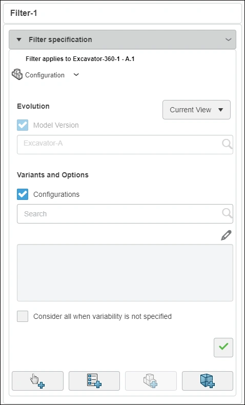

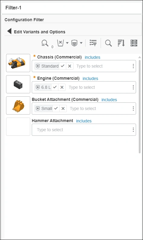

  3. Configuration(*)
    1. In order to filter by configuration, you will need to have an assembly that is assigned to a Configuration Context with Configurations already defined. See Configurations with Model Version [link to PDM role]
    2. To filter by configuration, select the Configuration and click Apply
    3. To filter by variants and option groups, click on the pencil icon. Select desired variants and options groups and click Apply.

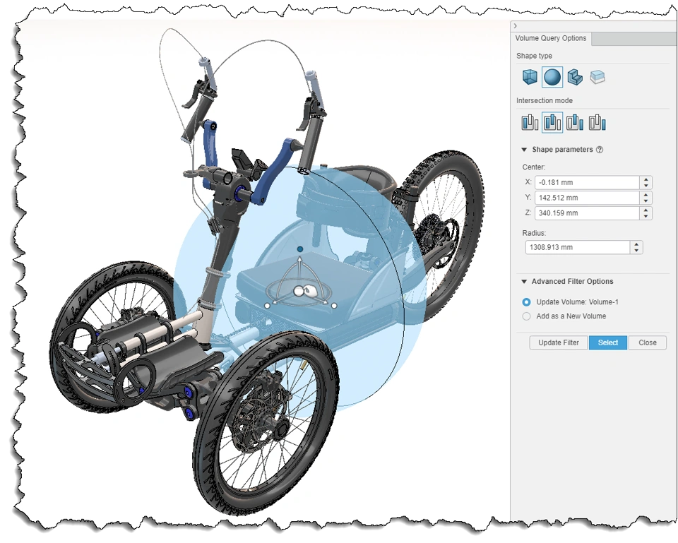

  4. Volume
    1. This rule type is only accessible on the 3DEXPERIENCE platform with Product Explorer and 3DNavigate. Plan your workflow accordingly if a Volume rule is required.
    2. Shape Type - select the shape you want to filter with and use the robot manipulator to move and resize the bounding region
    3. Intersection Mode - select based on if you want components that are partially in the bounding region to be included or excluded
    4. Shape Parameters - more precise way to modify the parameters of the bounding region
    5. Advanced Filter Options - update the existing volume criteria in a filter
Note: Remember that you can combine multiple criteria to create a single Filter. Combining rule types is usually more precise than any single rule on its own!

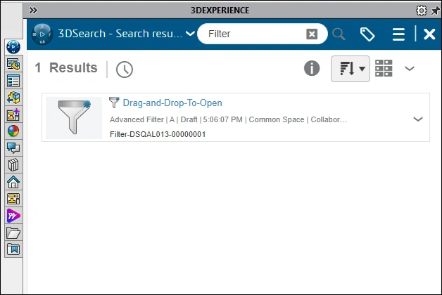

Selective Loading is the functionality for opening these Filters in SOLIDWORKS Design. Once you have created Filters for portions of your large assembly, you can open just the portion you need by opening the Filter instead of the top-level assembly. SOLIDWORKS Design requests only the components defined in the Filter, so you start working sooner while the full assembly context remains intact on the platform.
A Filter is a separate database object, so you can find and open it much like any other object on the platform. There are several ways to search for a Filter:
  • On the 3DEXPERIENCE platform, using 3DSearch or an app such as Product Explorer or Bookmark Editor.
  • In the MySession panel inside SOLIDWORKS Design.
  • Through File > Open > Open from 3DEXPERIENCE in SOLIDWORKS Design.
Once you have located the Filter, drag and drop it into the working area of SOLIDWORKS Design to open it. Because searching by the term "filter" surfaces these objects quickly, a consistent naming convention (see Section 5) pays off every time you open one.

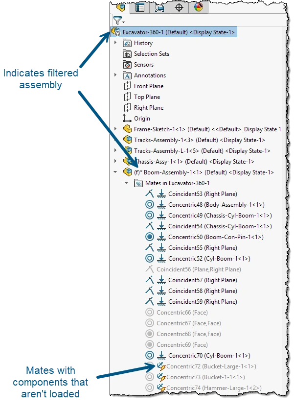

When you open a Filter inside SOLIDWORKS Design, there are indicators to show you are working with a filtered product structure rather than the complete assembly.
  • A filtered assembly banner appears above the CommandManager
  • Top-level assembly has a filter icon in the FeatureManager design tree
  • Sub-assemblies that have components filtered out are marked with an asterisk (*)
  • Mates that are not resolved due to filtered out components also have a different icon.
    • You cannot make changes to these mates.
    • You can create new mates with components that are loaded or new components that are inserted.
    • You can edit mates with components that are loaded.

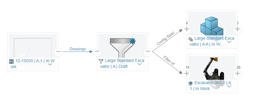

Creating Drawings from Filters
You can create drawings that are associated with a Filter. This is particularly useful for creating BOMs, cut lists, or part lists for specific needs, and for quick high-level sheets for design reviews, inspection, or service documentation, all without loading the whole assembly. Drawings that are related to the Filter will be updated automatically when the Filter is updated.
  • Open your saved Filter in SOLIDWORKS Design and create a new drawing like you typically would.
  • Use the Relations app to see the relationship between objects on the 3DEXPERIENCE platform.
