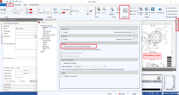

- In SOLIDWORKS® Inspection Professional standalone, open your inspection project.
- To turn on CMM Data Import, go to Home > Options.
- Go to the General page.
- On the General page under Add-ins, select the Measurements Input and CMM Data Import option > Apply > OK.
On the right side you will see CMM Data Import task pane.

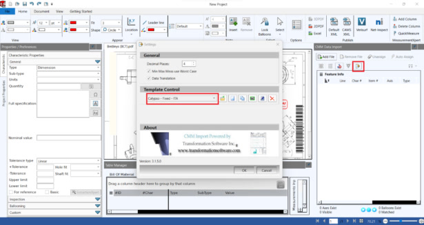

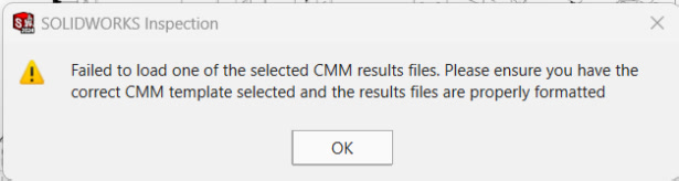

In order to read the CMM data, we first need a template (.xml) which can read the CMM data outputted from machine (like ‘Dukin.txt’ generated from Dukin’s CMM machine). If there is mis-match in the template that we are using and the CMM file that’s generated, it will give us and error 'Failed to load one of the selected CMM results files. Please…..'.
Now this error could be due to following two reasons:
1. Machine is available in default template list :
First, we will check if SOLIDWORKS Inspection already has the template to read our CMM data (Dukin.txt).
To do so please go to the 'CMM Data Import' task pane, click 'Settings'. In the 'Settings' dialog box, to view a list of existing template names, under 'Template Control', click the drop-down arrow. Here you will find template list for more than 60 CMM machines. If you see the name of your CMM machine that please select.
If you do not find your machine in default list, please see refer word file 'CMM Template List' where I have shared list of some template that were built internally. If you find your machine, please create an SR asking the Template file (.xml).
2. Machine is not available in default template:
If your machine is not available in any of the lists of default templates. We will have to create a new template as per the output data of your machine, by editing any of the existing template which is close to your machine output.
Please download and refer the attached pdf file (Part1 and Part2), where we have explained on how to edit various templates for different machines. Following this you can create template for your machine. If you find any difficulties or any issues please contact Technical Support.

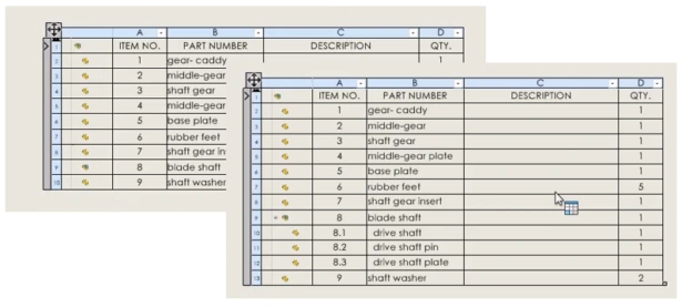

As we all know, while creating Bill of Materials (BOM) in SOLIDWORKS®, we have multiple options like Top -level only, Parts only, Intended, which allows us to create a BOM as per the requirement. When we create BOM using Top -level only option, only the sub assembly name is listed in the BOM table along with the other top level components of assembly. Sub assembly components are not displayed. Similarly with Intended option, we have the provision to expand or collapse the sub assembly, where as per the requirement we can show or hide components of sub assembly accordingly.

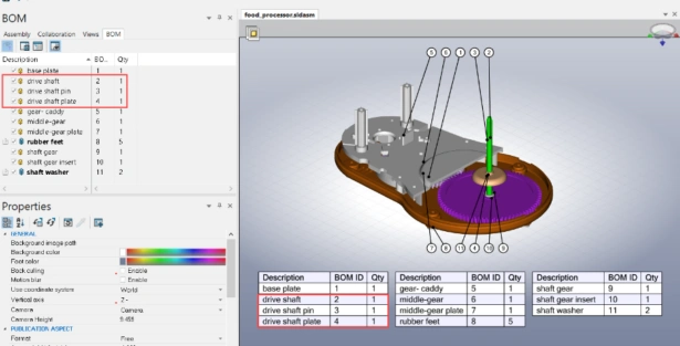

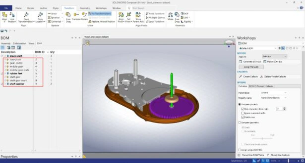

In SOLIDWORKS® Composer™, though we don’t have direct option to display only the sub assembly name in BOM table, this is possible in Composer™ with appropriate workflow. Normally when we create a BOM in Composer™, BOM table lists all the parts in sub assembly also, along with the parts in top level assembly, that is similar to option ‘Parts only’ in SOLIDWORKS®, as you can notice in the image below.

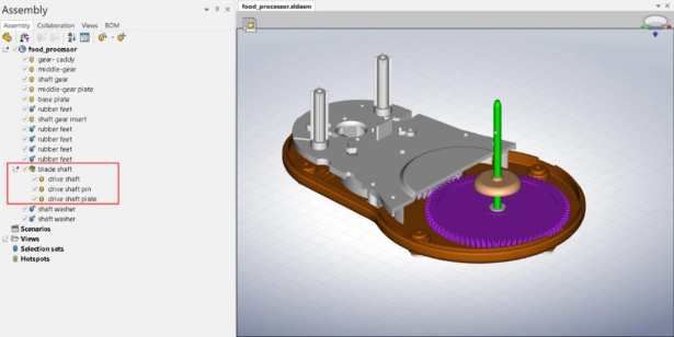

Consider a sample ‘food_processor’ assembly, it has one sub assembly named ‘blade shaft’ which further has 3 components. Now we want to create BOM in such as way, that in BOM table, only the sub assembly name ‘blade shaft’ should be created along with other top level assembly components.

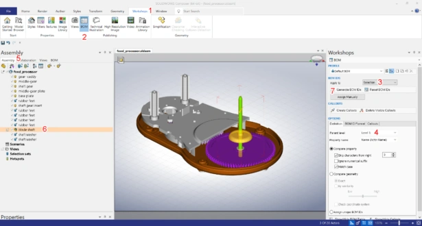

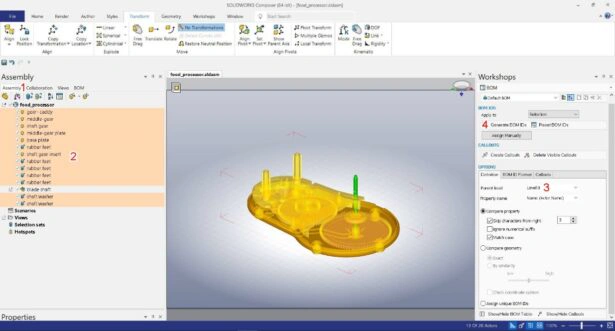

So to achieve this, import the assembly in Composer™, go to Workshops > BOM > in Workshops Pane > under BOM IDS > Apply to > select Selection > under OPTIONS > Definition > Parent Level > select Level 1 > in Left pane, switch to Assembly tab > select the sub assembly blade shaft > click Generate BOM IDs.

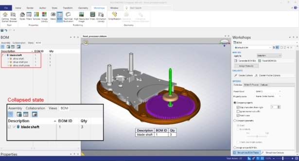

This will generate one single BOM ID for the sub assembly. You can view it in BOM tab in left pane. If you enable the Show/Hide BOM Table button, you can view the same in BOM table. Please note, here the ‘Parent Level’ selection is very important while creating BOM ID, as it specifies whether to create the BOM description from the actor itself (level 0) or from a parent.
Now again switch to Assembly tab in left pane > select all the other top level assembly components (i.e. all the components except the sub assembly) > in Workshops Pane > under OPTIONS > Definition > Parent Level > select Level 0 > under BOM IDS > click Generate BOM IDs.
This will generate the BOM IDs for all the other top level assembly components, which can be viewed in BOM tab.

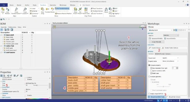

Now the BOM IDs are generated for all the components as per our requirement. Now comes the last part where we need to generate callouts, show the BOM table in the graphics area, and adjust its size accordingly.
To achieve this, select the whole assembly from the graphics area > under CALLOUTS, click Create Callouts > click Show/Hide BOM Table. Once the BOM table is displayed, select it and adjust its size from the Properties pane under TEXT > Size
So this finally completes our process. You can notice in the image, BOM IDs are generated for all the components, similarly for sub assembly also single BOM ID is generated and only the sub assembly name (i.e. blade shaft) is displayed in BOM table.

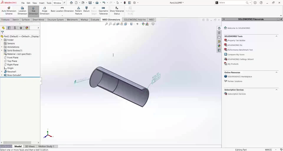

For a visual demo, check out the video example below. In this case, the external face of part 2 which is used in defining the mates with part 3 has no tolerance information defined for it. Thus, no assembly constraints appear for it in the TolAnalyst study.
