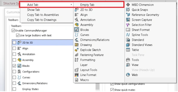

  1. Open a New Part
  2. Customize the Tab: Right-click any of the existing tabs and select Customize. Then, right-click on any tab again and select Add Tab > Empty Tab. Name this new tab, for example, "Macros". This will be the space where you'll store your macros.

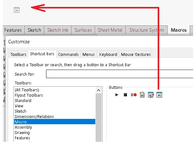

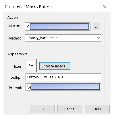

  3. Add Macro Buttons: Once your tab is created, go to Customize > Shortcut Bars, then drag and drop your macro buttons onto the new "Macros" tab.
  4. Configure Macro Path: In the macro button properties, fill in the details for the macro file you want to use. This will point to the location of your shared macros, which is essential for the macro to function properly.
  5. Repeat for Assembly and Drawing Environments: Repeat the process for both the Assembly and Drawing environments with macros respective to those environments, ensuring that the custom "Macros" tab is created in each of these environments.

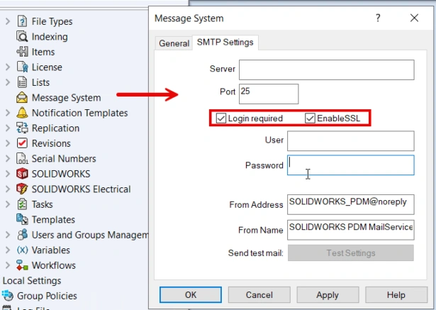

Before SOLIDWORKS PDM 2025, connecting to internal SMTP servers was simple by specifying the SMTP server name/IP address and port number in the SOLIDWORKS PDM Administration > Message System > SMTP Settings. However, for external servers like Gmail or Office365, direct configuration through the Administration tool was not possible. Users had to rely on third-party applications to establish the connection and configure the systems.
Starting with SOLIDWORKS PDM 2025, there is no longer a need for third-party applications to connect to external SMTP servers. You can now directly enable SSL (Secure Socket Layer) or TLS (Transport Layer Security) authentication for email notifications in SOLIDWORKS PDM.
In the SOLIDWORKS PDM Administration Tool, you can select EnableSSL under Message System > SMPT > SMTP Settings to enable SSL or TLS authentication in the SMTP email notifications. It is a two-way authentication along with the login credentials.

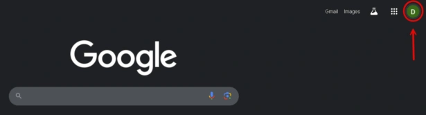

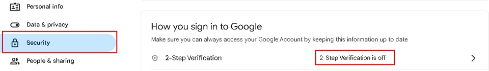

  1. Sign in to your Google account. In the top right corner, Click on Google profile, and select Manage your Google Account
  2. The Google Account page will be opened. Click on Security Tab, and enable/enroll for Two Factor authentication.

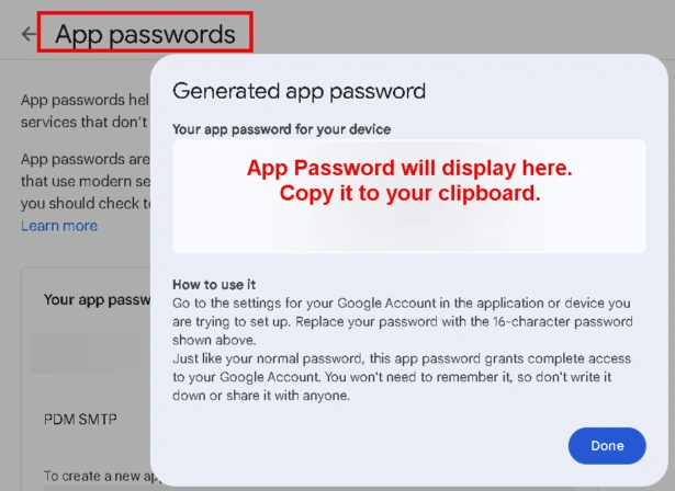

  3. Once you enable Two-Step Verification, you should be able to see a new option App Password. If you are not able to see it, you can also search for App Password in the Search bar at top.
  4. Generate the App Password and copy it to your clipboard.

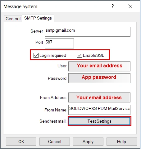

  5. Open SOLIDWORKS PDM Administration Tool > Message System > SMTP Settings. Enter the details as seen in the image below.

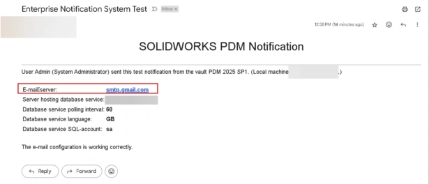

  6. Click on Test Settings and enter the receiver email address to test SMTP notifications successfully.

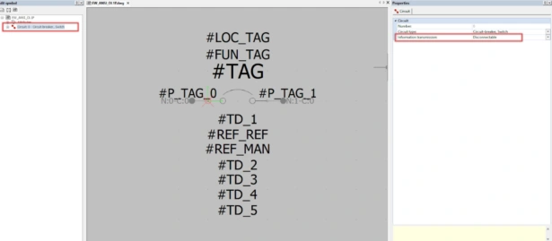

When you place a symbol on top of a wire inside SOLIDWORKS Electrical, very commonly what will happen is when you go to number the wires, each individual wire that's connected to that symbol will be given a different equipotential label. But when a user wants to pass that equipotential label through the circuit in order to transmit that particular signal to some further destination, The user will have to make changes to Information transmission of the symbol.
In SOLIDWORKS Electrical the place where you can control what the software does with equipotential mark is actually within the properties of circuit in the symbol itself. In the image shown below, when you open a symbol and click on the circuit, you can see on the right-side panel there is an option to control information transmission.
This circuit in the attached image is set to Disconnectable but there are four different options available for what we can achieve with equipotential mark. The options are as follows:

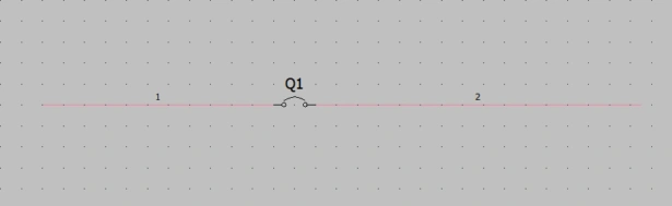

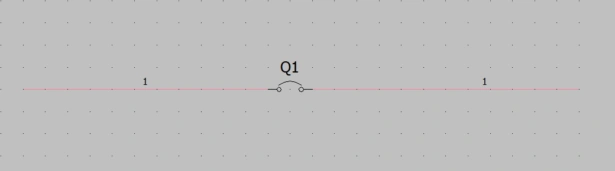

If the user selects the Disconnectable option. Upon placing the symbol on a wire, it will split the equipotential and there will be two different equipotential on either side of the symbol.
If the user selects the Passing option. Upon placing the symbol on a wire, the same equipotential will appear on both the sides of the symbol.

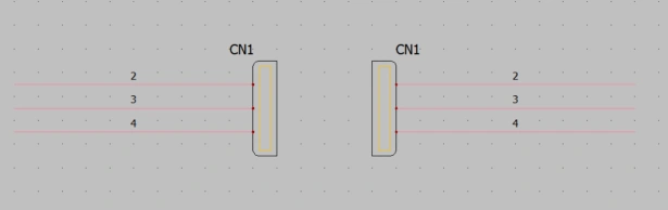

There are instances where the user will have to use connections on multiple drawing sheets. This is where Hyper passing comes into picture. Hyper passing requires two symbols that are associated to each other or to the same component. In the attached image 3 wires are connected to a connector having hyper passing terminals. Now, a similar connector with the Hyper passing terminal is connected to another set of wires but is associated with the same connector. Notice that the equipotential travels through the connectors even if they are separately placed.

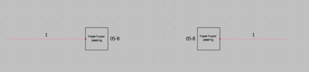

Hyper hyper passing symbol is exclusively used as origin destination symbols. Most symbols in this schematic are multi-wire symbols but if you are going to use Hyper hyper passing transmission type you will have to set the symbol type as origin destination symbol. You can find symbol type when you edit the symbol under properties. Once you set the symbol for origin and destination you can use these symbols similar to origin-destination arrows. These symbols will also show cross references just like origin-destination arrows.
