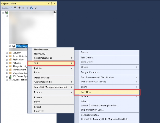

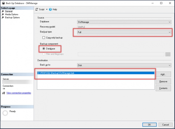

1. The SOLIDWORKS Manage SQL Database backup (.bak): This database contains all of the item and project data created in your SOLIDWORKS Manage environment.
- In the Management Studio, right-click on the Manage database that needs to be backed up. Then go to the Tasks and select ‘Back Up’.See the image below.
- In the Back-Up dialogue box, General page, ensure that the Backup type is set to ‘Full’ and the Backup component is set to ‘Database’. In the Destination area, select click ‘Add’ to select a backup destination on disk. See the image below.
- In the backup ‘Options’ page, it is recommended to use the Overwrite option and also mark the Verify backup checkbox.

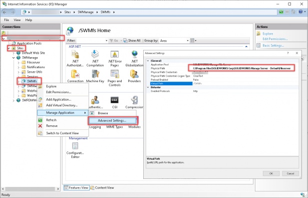

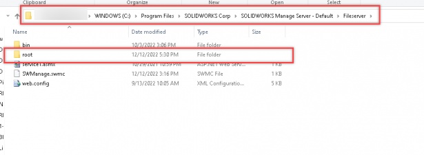

2. The Root folder of the file server: The Root folder contains all the files that are stored in document objects and the related files for all records in SOLIDWORKS Manage. Although the default location of the Root folder is C:\\Program Files\\SOLIDWORKS Manage Server\\FileServer\\Root\\, you might have selected a different folder location during installation. To back up the Root folder, copy the contents to a secure, off-site disk.To find it on your Manage server follow the following steps:
a. Launch Microsoft Internet Information Services (IIS)
b. Expand Server > Sites > SWManage > SWMfs
c. Right Click and select Manage Application > Advanced Settings. Refer image shown below.
d. Find the “root” folder in the “Physical Path” location. See the image below.
If these two elements are backed up and copied from the server, then restoring from a complete system failure can be done very quickly with a minimum of data loss.

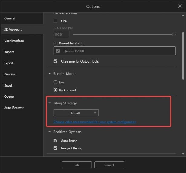

Starting SOLIDWORKS Visualize 2023, we find a new option “Tiling Strategy “in 3DViewport Settings.
To limit the amount of GPU memory used for rendering, SOLIDWORKS Visualize uses tiling, which subdivides an image. Into smaller tiles. After rendering, it combines the tiles into a single large image.
If you click the link” Choose value recommended for your system configuration “, SOLIDWORKS Visualize probes the GPU memory and suggests a preset.
When you specify Tiling Strategy, the following options are available –
Disable: Completely disables tiling altogether even for very large images. This setting may lead to out-of-memory errors during rendering. Only recommended for users with a graphics processor unit (GPU) with a lot of memory.
Optimistic: Uses tiling for images larger than 33,177,600 pixels (8K). Only recommended for users with a graphics processor unit (GPU) with a lot of memory.
Default: Uses tiling for images larger than 8,294,400 pixels (4K). Recommended for users with an entry level graphics processor unit (GPU).
Conservative: Uses tiling for images larger than 2,073,600 pixels (2K). Makes heavy use of tiling to prevent out-of-memory errors. Recommended for users with an entry level graphics processor unit (GPU).

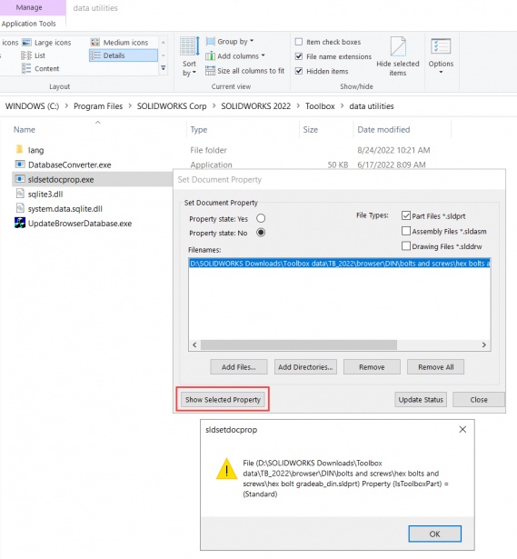

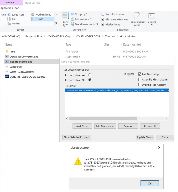

3. How to Remove Toolbox flag from SOLIDWORKS part file?
- By @DP

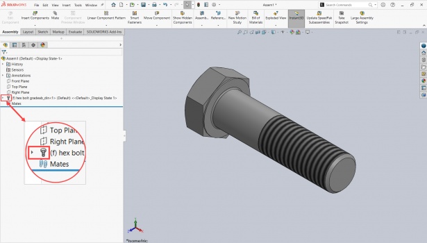

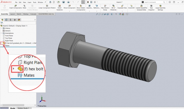

All SOLIDWORKS Toolbox parts have an internal flag set that enables SOLIDWORKS to identify such files as Standard toolbox file. The flag is a hardware icon beside the Toolbox part file name in the FeatureManager Design Tree, highlighted in the below image.
You can copy the existing standard toolbox file and customize it as per requirement.
Once customized, you can place this file either in the Standard Toolbox folder or outside the folder to a desired location as per need basis. The file with unflagged state corresponds to a Toolbox geometry with no link to the Toolbox. A mere dump parametric part, rather than an intelligent toolbox part.

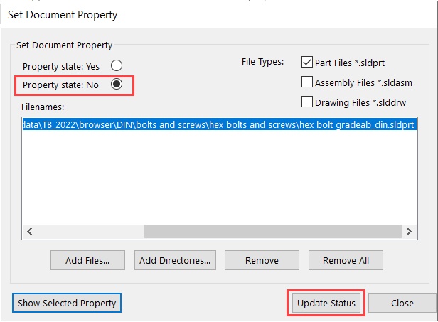

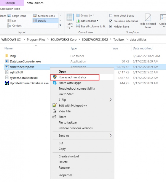

To remove or set the flag for a part file, do as follows:

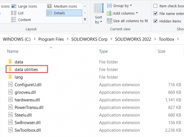

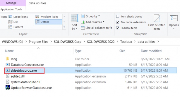

1. Browse into the SOLIDWORKS installation folder ‘[install_dir]\\toolbox\\data utilities’.
2. Right-click ‘sldsetdocprop.exe’ and select ‘Run as Administrator’

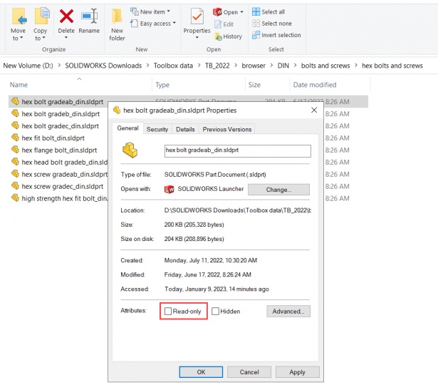

3. Ensure that the files you are updating have the read-only flag disabled
4. Add files or folders to the ‘Filenames’ list
5. Under ‘Set Document Property’, define the toolbox state of the files:
- Select ‘Property state: Yes’ to enable the toolbox flag.
- Select ‘Property state: No’ to remove the toolbox flag.
- To check if a listed file has the Toolbox flag enabled or not, select the file in the list and click the ‘Show Selected Property’ button.
6. Click the ‘Update Status’ button to apply the update.
When the Toolbox flag is removed, the icon in the FeatureManager looks like a regular part file. See the image below.
