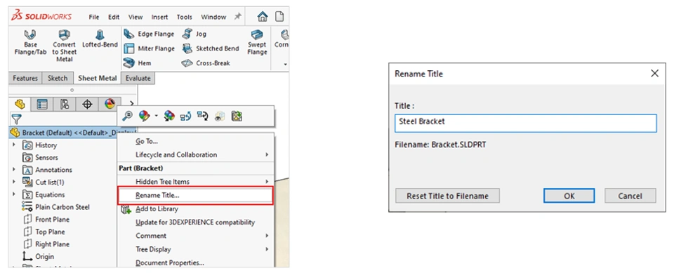

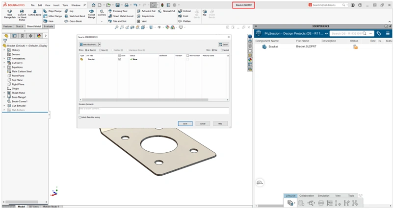

The simplest method of naming an item in 3DEXPERIENCE is manually defining the Title. This approach utilizes the default behaviour of each new customer Tenant. When a saving new SOLIDWORKS part or assembly to 3DEXPERIENCE for the first time, the Title can be set by clicking in the Title field. If the file has not yet been saved locally, the file name will be set to match the Title.

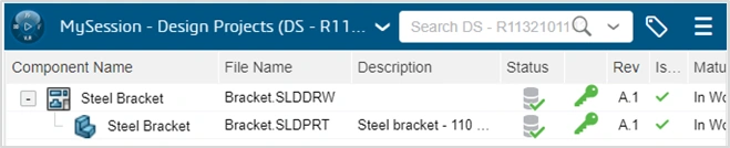

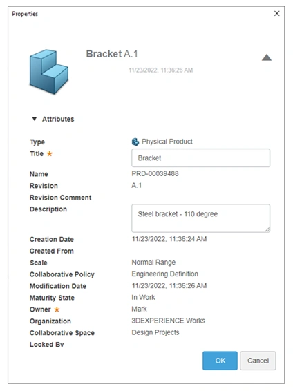

After the save to 3DEXPERIENCE has completed, the Description field in the ENOVIA properties dialogue can be used to capture more detailed information related to the item.
In the image below, a SOLIDWORKS part called Bracket.sldprt is saved to 3DEXPERIENCE for the first time.

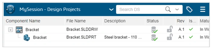

For a single SOLIDWORKS user adopting 3DEXPERIENCE who is already defining the name of each individual file and would like to continue working this way, manually defining each Title is an effective approach to help them to rapidly adopt the 3DEXPERIENCE Platform. The workflow of managing Titles and Descriptions does not require any platform configuration, and follows a similar methodology to one they are already used to, with the added benefit that any references will be maintained if a Title is modified.

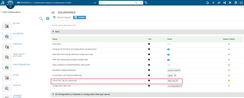

When choosing to adopt a manual naming strategy, by default SOLIDWORKS does not block the saving of an item with a Title that is a duplicate of an existing item in the database. However to ensure that every file saved to 3DEXPERIENCE has a unique title, a SOLIDWORKS setting in the Collaborative Spaces Configuration Center called “Check File Title for uniqueness” can be enabled. This option can be set to either just warn a user if the Title is already in use (user can still save with a duplicate Title), or to block the save to 3DEXPERIENCE operation.

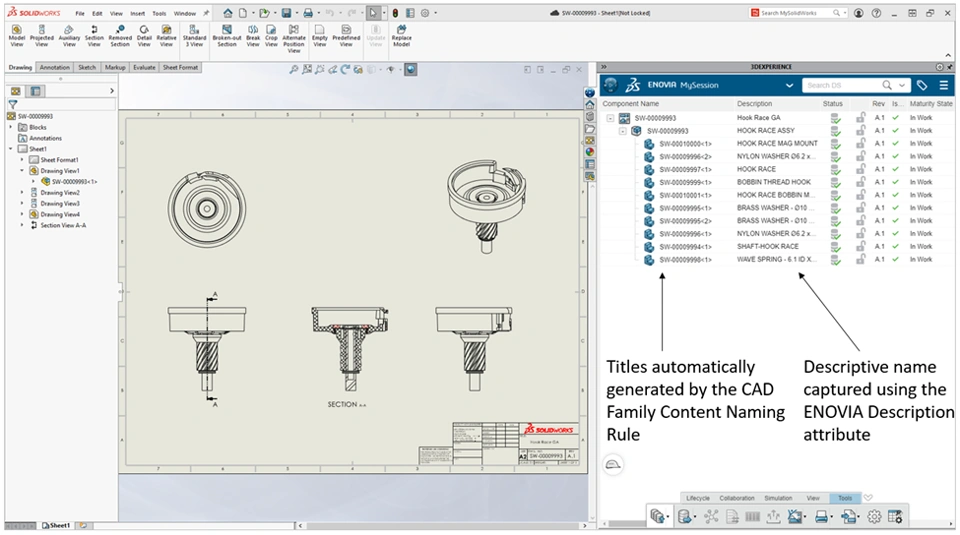

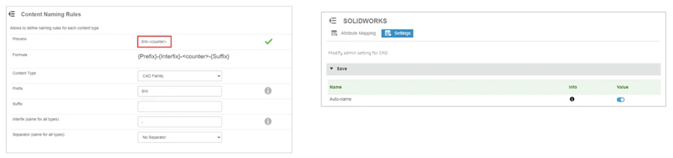

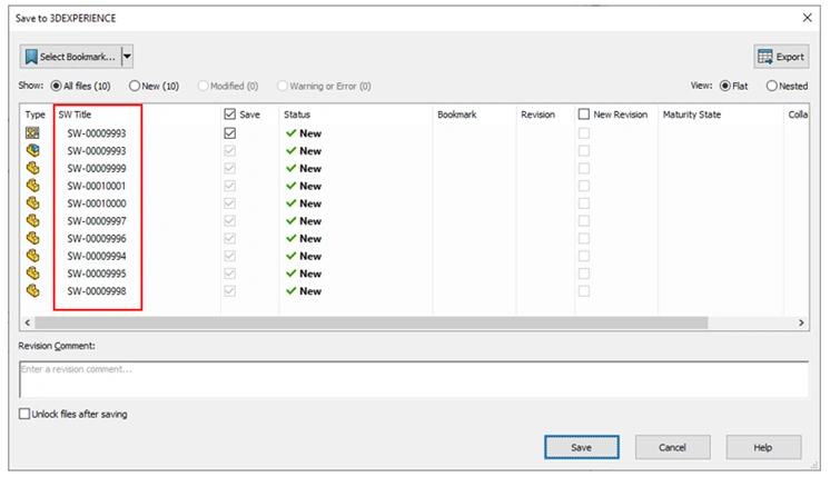

Working with sequential naming turned on, when a user saves new files to 3DEXPERIENCE from SOLIDWORKS for the first time, each Title is automatically populated with the next sequential value generated by the CAD Family object “Content Naming Rule” e.g. SW-00001, SW-00002 etc. A platform administrator defines the content naming rule using the Collaborative Spaces Configuration Center. The naming rule must always contain a counter in combination with one or all of the following, prefix, suffix, and interfix. Once the naming rule has been defined, the automatic naming behaviour for SOLIDWORKS can be enabled (or disabled) using the Auto-name option in the SOLIDWORKS settings panel.

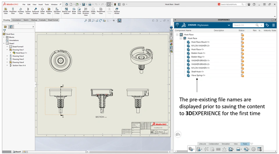

1. A pre-existing drawing called Hook Race.slddrw, and its referenced assembly Hook Race.sldasm are saved to 3DEXPERIENCE for the first time.
The descriptive name of an item can be easily modified by editing the Description field on the ENOVIA properties dialogue, either in SOLIDWORKS or one of the dashboard web apps e.g. Bookmarks Editor. This is a simple workflow for new users to adopt and removes the need to use the Rename Title command in SOLIDWORKS.

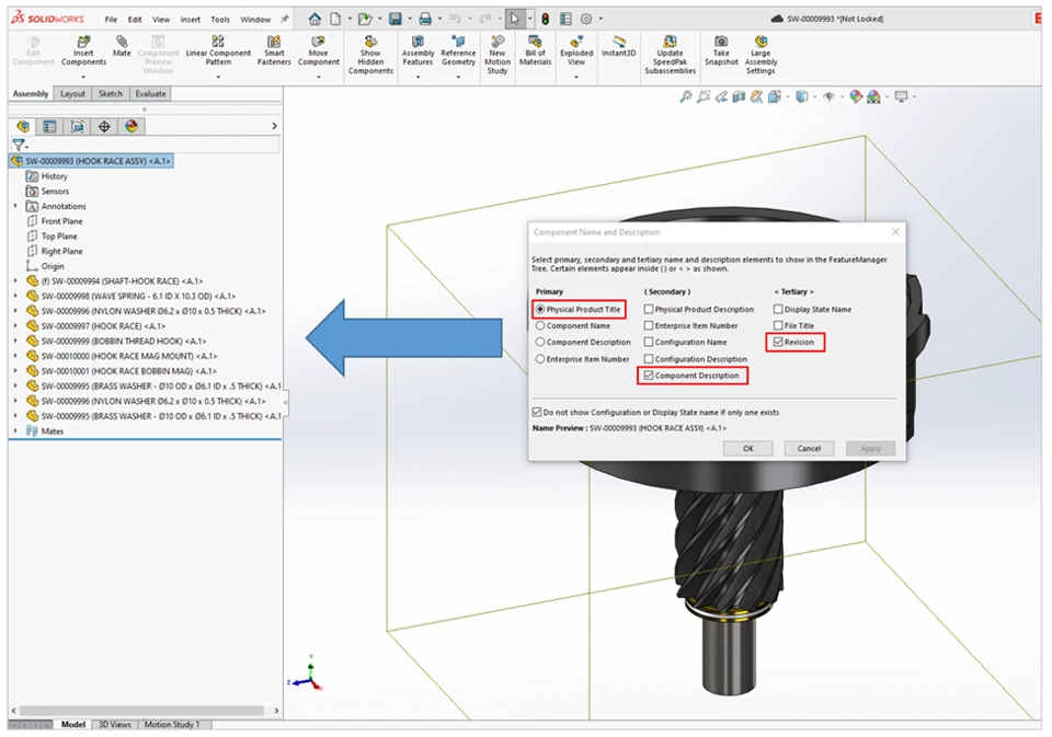

Having users configure their feature manager display to show additional information, e.g. Description, is also highly recommended for quick and easy identification of individual components.

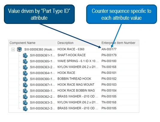

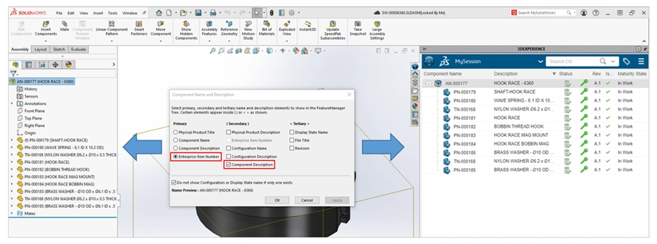

For any customer that has a requirement to capture additional information related to a design as part of a unique identifier, the Enterprise Item Number (EIN) is the recommended solution. The EIN is the primary part/Item numbering solution in 3DEXPERIENCE. The EIN offers much greater scope for configuration over the Content Naming rule. For example, an EIN can be configured to contain attributes, including different counters linked to individual values.
Tip: Once EIN’s have been assigned to components in an assembly structure, for greater clarity, a user can switch their SOLIDWORKS Feature Manager display to show only EIN and Description, instead of the automatically generated Titles.
