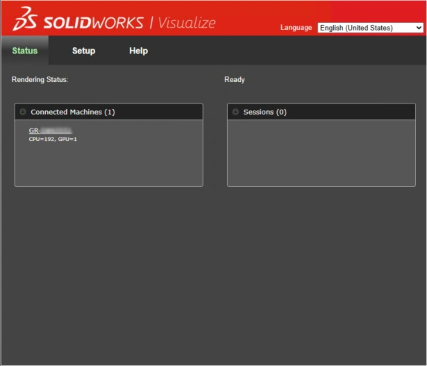

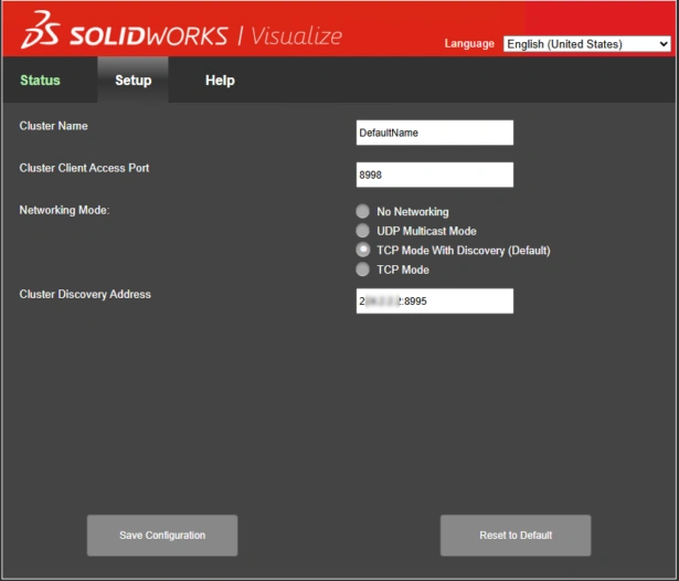

SOLIDWORKS Visualize Boost 2024 had a lengthy and complex process of connecting a coordinator Render machine (server) to a non-coordinator machine (client). Visualize Boost 2024 would support NVIDIA IRay Render Engine.
The Status and Setup Page would look like the attached images.

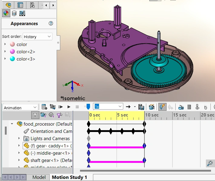

To import motion studies into Visualize Connected, first you embed the motion study data in the SOLIDWORKS Connected part or assembly as shown in below image.

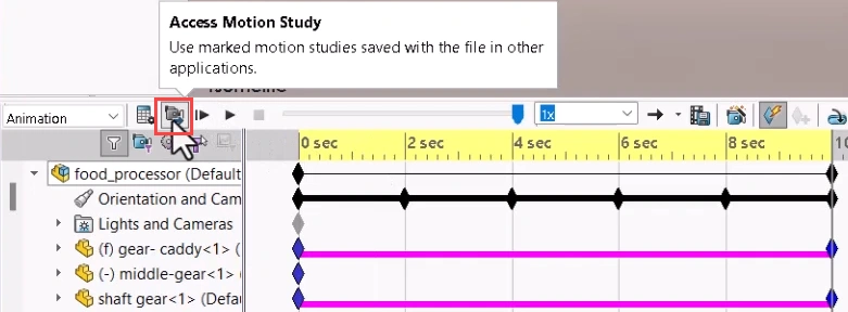

Enable the option Access Motion Study in MotionManager toolbar.

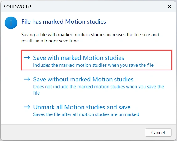

Save the model to 3DEXPERIENCE platform with option Save with marked Motion studies

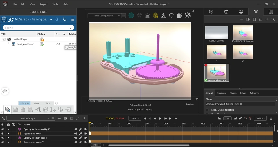

- Import the model with marked motion studies from platform, into Visualize Connected
- When importing model, select Animations in Import Settings dialog box
- Under Cameras tab, select ‘Animated Viewport’
Go to View menu and select Show Timeline to display the animation timeline
