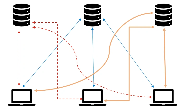

SOLIDWORKS Electrical connects to up to three distinct Servers/Services:
  • Collaborative Server
  • Microsoft SQL Server
  • File server compatible with Microsoft.
Different serves used by SOLIDWORKS Electrical
Microsoft SQL server
Remarks:
  • SOLIDWORKS Electrical utilizes TCP ports to stablish the connections.
  • There is no communication between SQL Server and EwServer
  • SQL server and EwServer can be installed in different computers[1]
[1] SQL Server and EwServer cannot be installed remotely (from client to server). Both must be installed on the server itself through the installation manager.

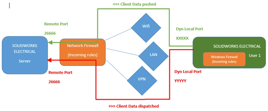

When SOLIDWORKS Electrical client starts, a dynamic socket is initiated from the client’s machine to the server on port 26666.
Following this initial connection, a subsequent in needed required, which is also initiated by the client.
Connections from SOLIDOWKRS Electrical client application to SOLIDWORKS Electrical collaborative server (EwServer)

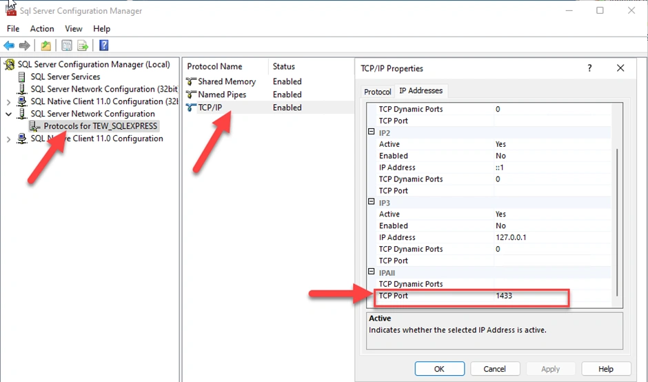

b) Microsoft SQL Server
SQL Server TCP ports can be configured to utilize dynamic or fixed ports, being this one the recommended for SOLIDWORKS Electrical.

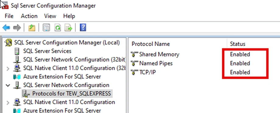

Protocols and TCP Port used by SQL Server, instance TEW_SQLEXPRESS
Protocols utilized by SQL Server, including Shared Memory, Named Pipes and TCP/IP, must be Enabled:
Protocols used by SQL Server, instance TEW_SQLEXPRESS
To see a real case of the ports opened and used once SOLIDWORKS Electrical is running, see Real case of ports used (SQL & EwServer)

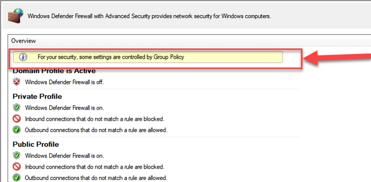

  • Notice that depending on the number of firewalls configured on the user’s environment, policy restrictions, firewall solution used, etc. these rules may not be enough for a comprehensive deployment.

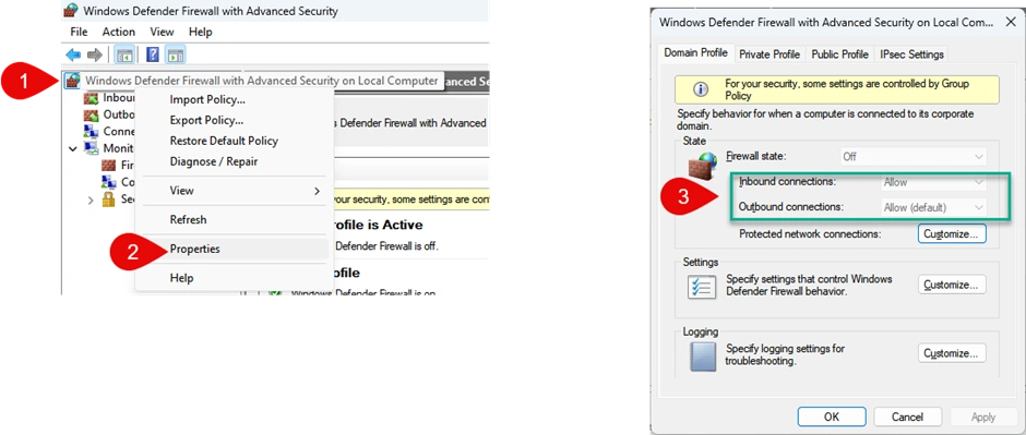

  • Firewalls can be controlled by Group Policy, showing a warning like follows:
Firewall controlled by Group Policy
In these cases, it is essential to engage the IT department. This is because if a connection is allowed through a port at the user level but not at the group level, the port will be closed without the user’s knowledge.
  • Allow inbound / Outbounds connections:
Allowing Inbound and Outbound connections

Firewall is a network security device, to allow or to block network traffic. When SOLIDWORKS Electrical is running in the same computer as EwServer, connections are done at local level (localhost /127.0.0.1), so no network traffic, no firewall..

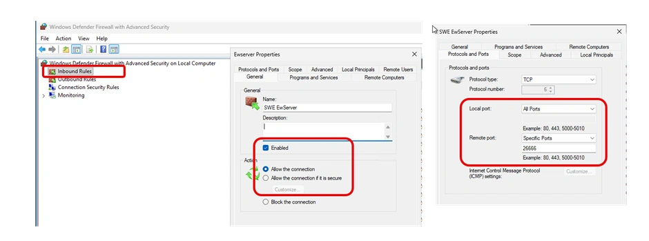

a) Firewall rules on the server

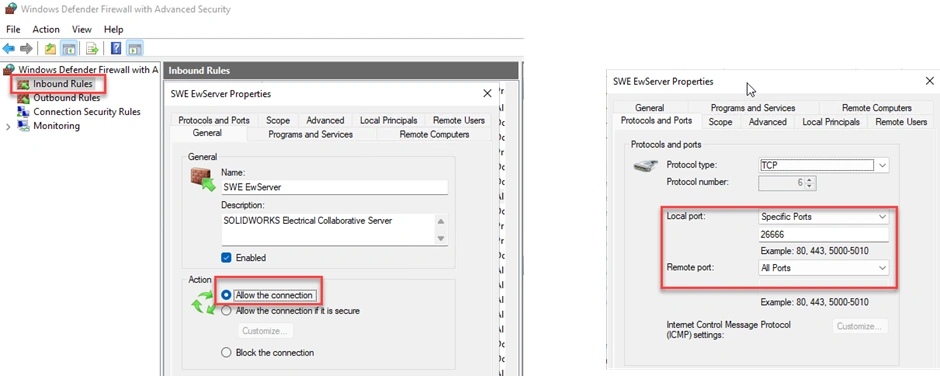

  • For EwServer
Inbound rule for SOLIDWORKS Electrical Collaborative Server, port 26666:
Inbound rule for EwServer
As the return port is a non-controllable-port-private, the Remote port must be “All Ports”

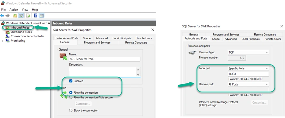

  • For SQL server
Inbound rule as following (see Microsoft SQL Server, to know the port number):
Inbound rule for SQL Server, instance TEW_SQLEXPRESS

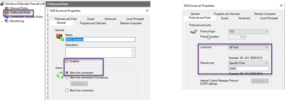

b) Firewall rules on the client
Only rules must be setup for SOLIDWORKS electrical, no need to SQL server as it is not installed on the client.
26666 must be established as Outbound
Outbound rule for Client
As inbound rule, any local port and port 26666 as Remote Port.[1]
Inbound rule for Client

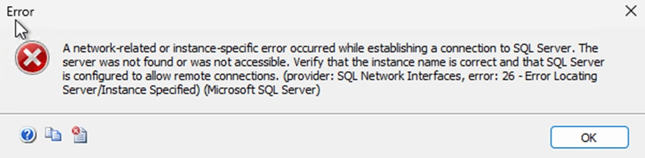

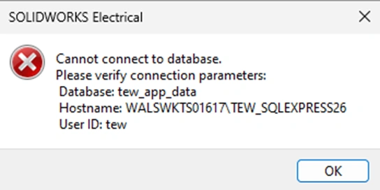

1 Cannot connect to database

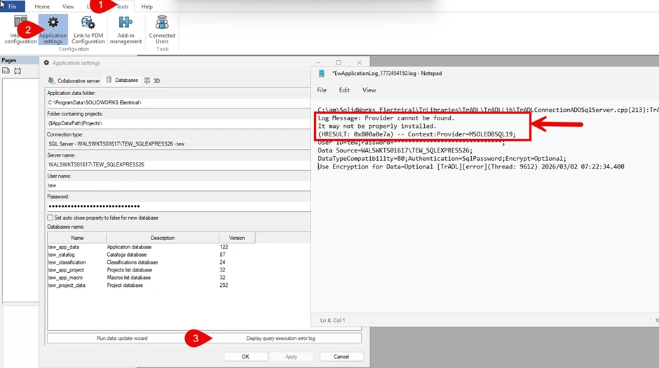

The execution error log will give some clues about what is happening; to open it, follow the next steps:
Query execution error log
SQL Server Management Studio (SSMS) will be the tool for troubleshooting. It can be downloaded from https://learn.microsoft.com/en-us/ssms/install/install
Error given by SQL Management Studio
Error log Content
Action
SQL Server Network Interfaces: Server doesn't support requested protocol
Be sure protocols Shared Memory, Named Pipes and TCP/IP are enable
Port closed: Server is not found or not accessible. Check if instance name is correct and if SQL Server is configured to allow remote connections
Check SQL server service is running at the server. Double check from client that SQL server can be accessible through SSMS
Provider cannot be found. It may not be properly installed. (HRESULT: 0x800a0e7a) -- Context:Provider=MSOLEDBSQL19
Install MSOledbsql19, available at SW file media
\\PreReqs\\MSOledbsql19\\ msoledbsql.msi

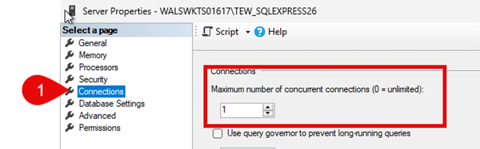

Client unable to establish connection due to prelogin failure
Client unable to establish connection because an error was encountered during handshakes before login.
unsupported version of SQL Server, server too busy to accept new connections or a resource limitation
With SSMS, Increase the Maximum number of concurrent connections, see following image

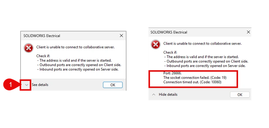

  1. Cannot connect to Collaborative server
Following different messages which, indicate there is a connection issue with the collaborative server.
Too time to connect with the EwServer
TIP: To see more details about the error, click on the down error to see the whole message
All the above cases indicate:

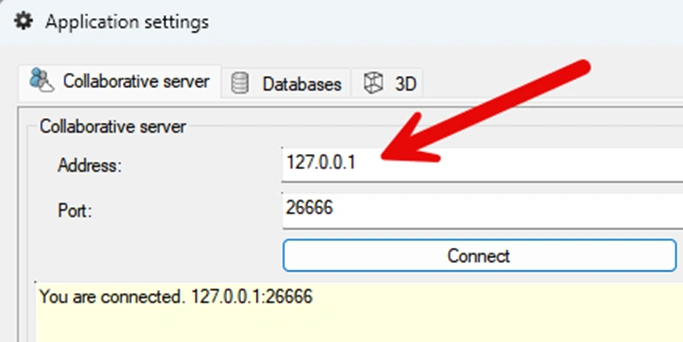

  1. Wrong server name; double check the server name or IP address is the right one
Collaborative server setings

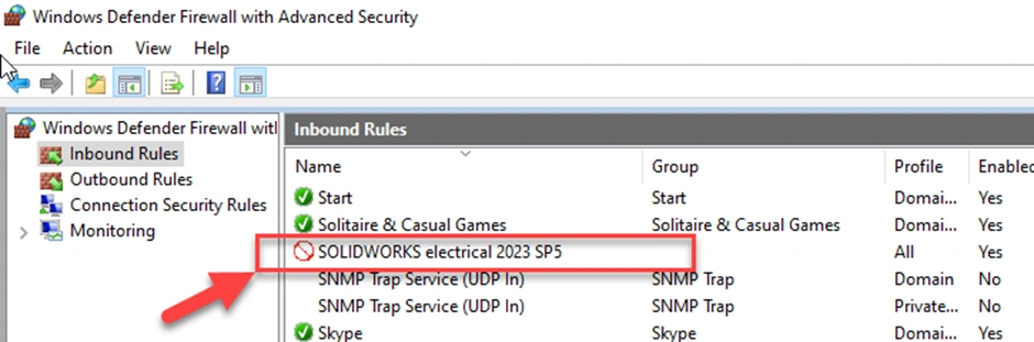

  • The port 26666 is not reachable at server side. To double check this assumption, open a Command Prompt session and run “netstat -an -p tcp” while SOLIDWORKS Electrical is running.
In addition, review there is none rule blocking old versions of SOLIDWORKS electrical:
Blocking rules

  4. EwServer installed and running on client machine while client is pointed to server side EwServer. -> Solved by stopping the EwServer which was running on the client.

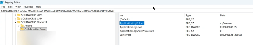

1 Logs for EwServer.exe
In case Technical Support demands the activation of the logs for the Collaborative Server service, follow the next steps and deliver the logs files in the Service Request.
  • Activation Server Logs
Logs must be activated manually at the SERVER side. The file log will be created right after restart the SOLIDWORKS Electrical Collaborative Server service (Ewserver.exe).
By activating the logs, the performance could be impacted therefore they need to be used only during the troubleshooting time.
Caution: Incorrectly editing the registry can severely damage your operating system. The SOLIDWORKS® User Success team strongly suggests that you back up the registry data before changing the registry.
  • Registry entry
The keys need to be created in the existing registry entry
“Computer\\HKEY_LOCAL_MACHINE\\SOFTWARE\\SolidWorks\\SOLIDWORKS Electrical\\Collaborative Server”
Registry entry to activate EWserver logs
Registry value
Used for
Values
ApplicationLogLevel
Activation and content
6 -> Logging disabled
4 -> Only errors
2 -> Information and errors
ApplicationLogFolder
Where the file is stored
For example, “C:\\ewserver\\”
ApplicationLogShowPrivateInfo
Show User name, computer, IP address
0 ->Info replaced by ‘xxxxx’
1->Information visible

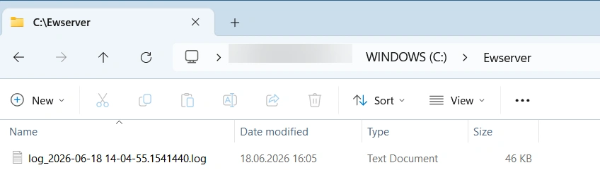

  • Log file
The logs files will be created in the folder defined. Attach a copy of the folder to the Service Request for its analyzing by R&D.
Example of log file

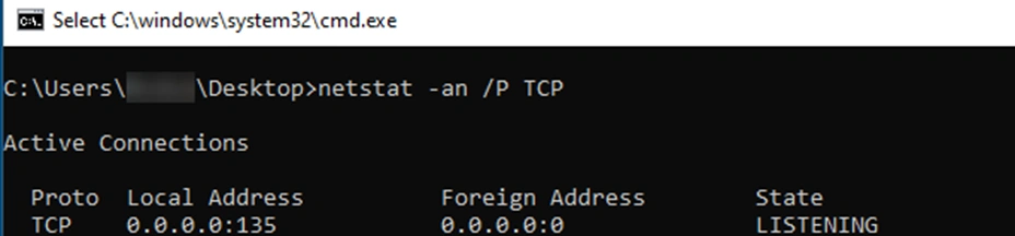

For this case, command netstat has been used.
Remark: “netstat -a -n /p tcp >C:\\Tmp\\ports.txt” (without quotes) will redirect the output to a file.
For more information, visit https://learn.microsoft.com/en-us/windows-server/administration/windows-commands/netstat
