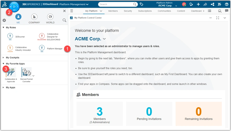

4) Derived Format Management
The Platform Manager is responsible for activating derived output in their platform. They activate derived output by defining and deploying Conversion Rules in the Derived Format Management console of the Collaborative Spaces Configuration Center app.
The Collaborative Spaces Configuration Center app is most commonly accessed by means of the Content tab of the Platform Management dashboard. You can also access this app by opening the Collaborative Spaces Control Center app from the Compass.
Once the Platform Manager deploys conversion rules, platform members are able to create derived output jobs. See section 6) 6)for more information on the required roles and licenses.

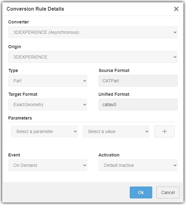

To add conversion rules, in the Derived Format Management console,
  1. Click New Conversion Rule:
icon.
2. Define the conversion parameters.
Figure 7 - Blank conversion rule dialog
The following parameters are available for synchronous and asynchronous rules:
  • Converter
    • The application that generates derived output.
  • Origin
    • The source of your CAD data. For this document, SOLIDWORKS or 3DEXPERIENCE.
  • Type
    • The CAD document type, part or drawing.
  • Target Format
    • The file format that you want to generate.
      The following parameters are only available for asynchronous rules:
  • Parameters (Optional)
    • Only for some formats.
  • Force Update (Optional)
  • Event
  • Activation
  • Conversion User
    • Only for STEP and CATPart.
For more information, see section 4)b)ii) Asynchronous Converter
3. Click OK to close the New Conversion Rule dialog.
The rule shows in the table, and the Deploy Status has the following symbol. This symbol means, New, not yet Applied.
4. Click Apply to deploy the conversion rule.
The Deploy Status changes from to .
NOTE: If the <strong>Deploy Status</strong> is , and you click Reset, the system deletes the conversion rule. The Reset does not delete deployed conversion rules.

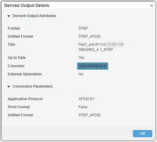

Figure 10 - If the converter is set to 3DEXPERIENCE, then it is an asynchronous rule.
Asynchronous converters rely on the 3DEXPERIENCE platform or a web app to create derived output jobs. The converter (ConversionAdministration Cloud Service or Derived Format Converter) processes the jobs and generates the derived output after an event. The derived output does not generate at the same time as a CAD operation.
Asynchronous converters have the following advantages and disadvantages:
AdvantagesDisadvantages
Save performance is faster.DO is not always synchronized and up-to-date.
More formats are available.DO result can be different from File > Save As.
DO generates after an event of your choosing.There can be a requirement for another converter.
More parameters and options for some formatsThere can be a requirement for more licenses.
You can create jobs outside of SOLIDWORKS in web apps.There can be a requirement for more workstations.
Non-CAD platform members can create jobs.Derived output generates more slowly with DFC.
Applies to all 3DEXPERIENCE Works roles and apps, including SOLIDWORKS Cloud.
You can control derived output filenames.

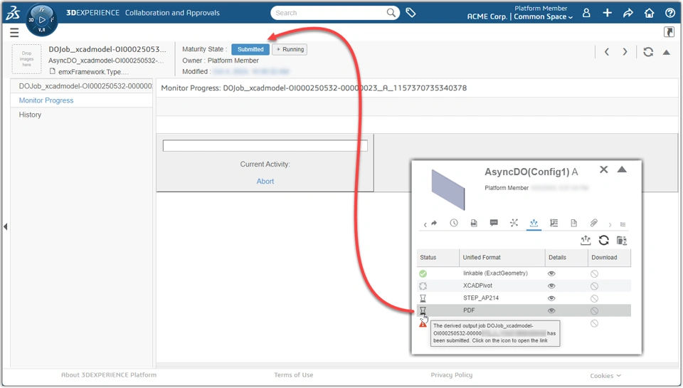

  • Event
A CAD app or web app creates asynchronous derived output jobs after one of three events. Jobs from these events are identical. As an example, if you create three asynchronous PDF derived output jobs for drawings, with different events, the resulting derived output is identical. The only difference is when you create the job.
  1. On Save from Connector
    The CAD app, SOLIDWORKS 3D CAD, creates a job every time you save CAD data to the 3DEXPERIENCE platform.
  2. On Status Change
    The 3DEXPERIENCE platform creates jobs every time you promote or demote the maturity of a part Physical Product or Drawing to a specific Target State: Draft, In Work, Frozen, Released, or Obsolete. You can use any web app to change the status to create the job. Typically, you change the status in MySession, Collaborative Lifecycle, Bookmark Editor, or a Change Action.
  3. On Demand
    The 3DEXPERIENCE platform creates jobs when you click the Generate Derived Outputs command and select rules. Conversion rules that have this event are available for selection inside the Generate Derived Output dialog. The command and dialog are available in several web apps:

a) ExactGeometry
A 3D format based on the CATIA® V5 geometry kernel. It generates automatically each time you save a SOLIDWORKS part to 3DEXPERIENCE.
It is a linkable format that you cannot download and cannot delete.

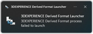

  • Clean Up Jobs In Progress means that there is an interruption in the processing of previous jobs, or the processing is incomplete. The service reprocesses the previous jobs before it processes new jobs.
  • Not Connected means that there are expired credentials or no cached credentials. The service cannot process jobs.
This status can also cause the following notification to display:
To resolve this failure,
  1. Delete the following folders:
    %appdata%\\DassaultSystemes\\CATSettings\\RXXX\\DerivedFormatConverter
    %appdata%\\DassaultSystemes\\CATSettings\\RXXX\\ENODFBatchSettings
  2. Log in to your 3DEXPERIENCE platform.
  3. Open the Compass.
  4. Launch the Derived Format Converter.
Once the service successfully starts, then restart Windows.

To start the Derived Format Converter in admin-mode:
  1. Log in to your 3DEXPERIENCE platform as a Platform Manager.
  2. Open the Compass.
  3. Launch the Collaboration and Approvals app.
  4. Me > My Credentials.
  5. Set your credentials to:
    1. Collaborative Space = Default
    2. Organization =
    3. Responsibility = Administrator
  6. After the web page reloads, open the Compass.
  7. Launch Derived Format Converter.

i) Format Details
As depicted throughout section 5), the Derived Output Details dialog gives you many important pieces of information.
dialog tells you the Format of the derived output, its Title, and the Converter that generated it. The converters you can see are:
Figure 56 - Asynchronous (ConversionAdministration Cloud Service) generated STEP AP242 derived output details.
3DEXPERIENCE = ConversionAdministration Cloud Service
sldprtTo =
slddrwTo =
SOLIDWORKS =
SOLIDWORKS 3D CAD
With the Derived Format Converter, you can use Process Explorer to monitor job processing. In Process Explorer, the Derived Format Converter shows as a DOWINSRV.exe process or as a DOBatchLauncher.exe process tree. When SOLIDWORKS 3D CAD is a requirement for processing, you see the SLDWORKS.exe process. For example, you see this process for the generation of asynchronous STEP_AP214 derived output.
ii) Job Status
Except for XCV and UDL, the status for all other derived formats shows in this interface. Each format can show one of five job statuses:
Submitted. A platform member or app created the job.
Running. A converter is processing the job.
Up to date. A converter processed the job and generated derived output.
Failed. A converter failed to process the job and generate the derived output.
Out-of-date. A platform member modified the CAD object. The derived output is not accurate. You must regenerate it.

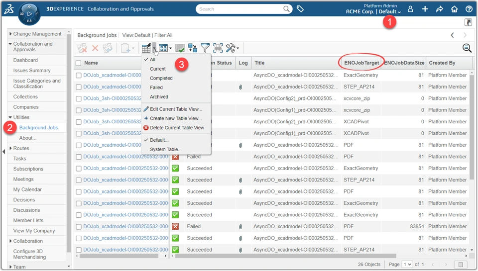

i) Collaboration and Approvals
Although not as user-friendly as the Information widget or panel, any platform member can view and manage their derived output jobs in the Collaboration and Approvals app.
Set your credentials then click the Background Jobs link in the left pane to view jobs.
Generally, it is best to select All and customize the table view to suit your needs. Adding the ENOJobTarget column is useful so that you can see and filter the jobs by format.
TIP: To refresh the table view and clear filters, click the Background Jobs link again instead of refreshing the web browser tab.
As a Platform Manager, you can change credentials to the Default collaborative space and Administrator responsibility. These credentials give you the ability to view all jobs from all platform members.

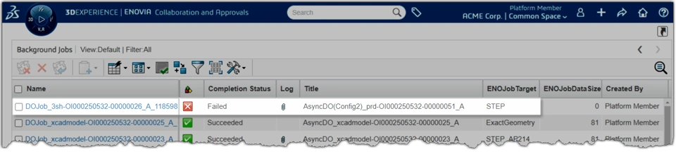

  • Case Study: Failed Job Analysis
Consider the following failed job:
license. This license is a requirement to generate STEP derived output.
The Derived Output Details dialog tells us that the target format is STEP. This format means that the job is asynchronous. And the ConversionAdministration Cloud Service or Derived Format Converter processes asynchronous jobs.
The Background Jobs table shows us that there is a log. The system only creates these logs locally. The existence of a log means that the Derived Format Converter processes the job. If ConversionAdministration Cloud Service processes the job, then there is no log. The log gives an error code along with HTM, ERR, and RPT reports.
The ERR report tells us the problem. The platform member running the Derived Format Converter – or the conversion user – does not have a Conversion Data Integrator for STEP Multidiscipline license. This license is a requirement to generate STEP derived output.
This error can also be an indication that there is a change to the signed in platform member, or a connection to a different tenant. If one of these conditions is true, then the platform member must stop or exit the app, delete the CATSettings (DerivedFormatConverter and ENODFBatchSettings), and restart the app.

2. ExactGeometry (best practice)
New tenants do not have an implicit conversion rule for 3DEXPERIENCE ExactGeometry. Platform Managers can create this conversion rule. The ConversionAdministration Cloud Service or the Derived Format Converter can generate this ExactGeometry without extra licenses. This derived output is based on CATIA V5 geometry and results in CATPart files. SOLIDWORKS opens this file format using 3D Interconnect. It results in a solid body feature that you can reference.

  • In the Derived Output Details dialog, what does External Generation refer to?
In the context of this document, the value for External Generation is always False. A value of True means that a custom-built application generates the derived output using REST API web services. For more information, see the following section of the 3DEXPERIENCE platform On Cloud Developer Guide: Web Services and Events > 3DSpace > Derived Outputs.
