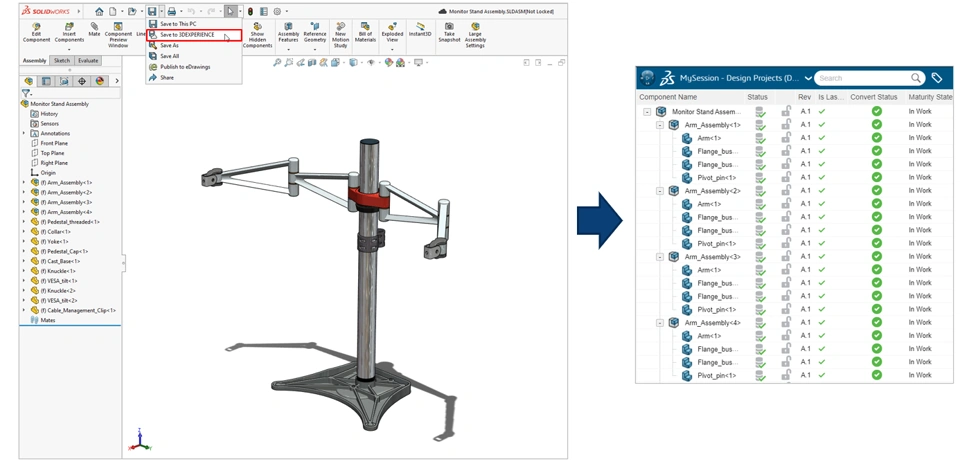

1. Saving the SOLIDWORKS assembly to 3DEXPERIENCE
The new monitor stand assembly is first saved to the 3DEXPERIENCE platform using the save to 3DEXPERIENCE command in SOLIDWORKS

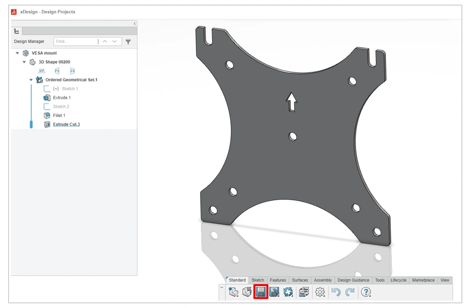

2. Create and Save the Mounting Plate Design in xDesign
A new mounting plate design is created using xDesign and saved in the same collaborative space as the monitor stand assembly.

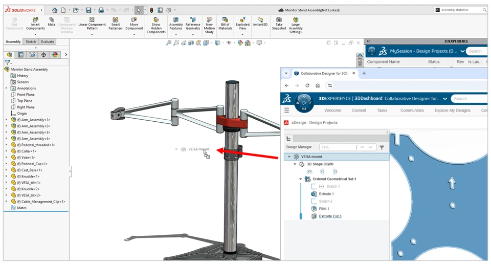

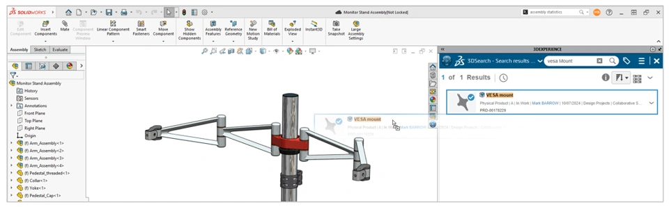

Instead, components authored using the xApps are added to a SOLIDWORKS assembly one of two ways. By drag and drop from the xDesign window into the SOLIDWORKS assembly, or from the MySession task pane tab in SOLIDWORKS using either 3DSearch or Bookmarks Editor.
In this example the component is located using 3DSearch in SOLIDWORKS MySession. From the search result in MySession the mounting bracket is dragged and dropped into the assembly.

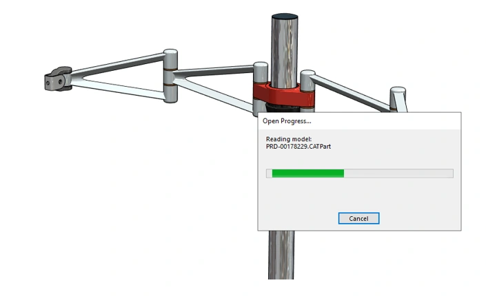

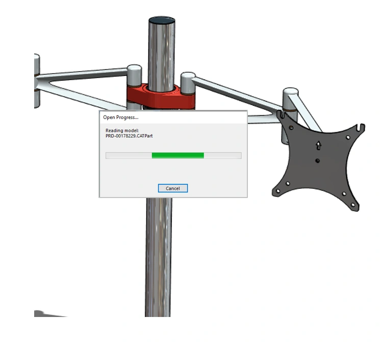

First a CATPart file representing the xDesign component is automatically downloaded to the local working folder and converted to a SOLIDWORKS part file.

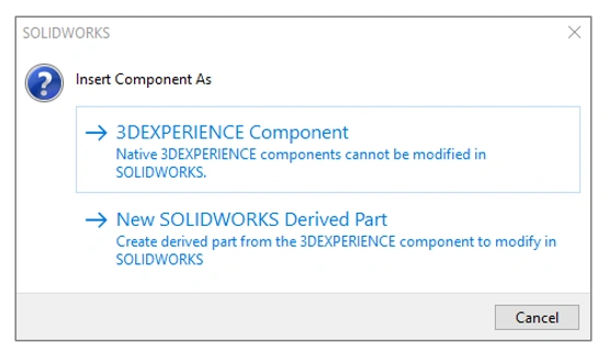

Next, two options proposing how the component will be inserted into the assembly are presented to the user. Insert as a native 3DEXPERIENCE component or create a new SOLIDWORKS derived part from the native 3DEXPERIENCE component. In this example the mounting bracket is inserted as a native 3DEXPERIENCE component.

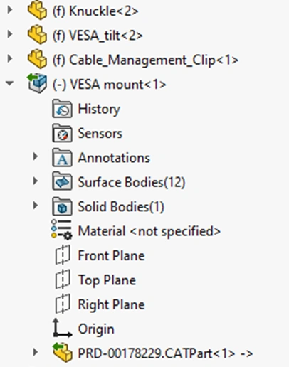

Native 3DEXPERIENCE components cannot be modified in SOLIDWORKS, this is okay as the intention here is that the bracket is only being used for reference purposes. Wherever possible it is recommended that modifications to geometry are always done in the native CAD tool that was used to create the component. This will preserve the feature history and make modifications reliable, quick, and easy to do.
The inserted component is displayed in the Feature Manager design tree and is easily identifiable as a 3DEXPERIENCE components by its blue and white physical product icon.

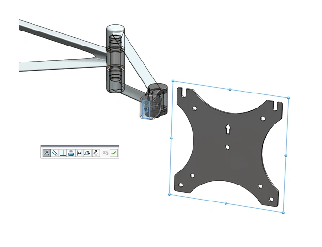

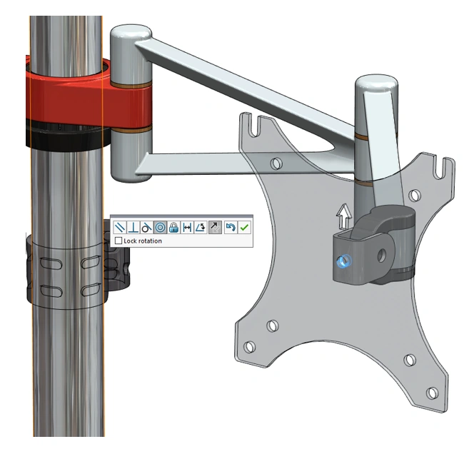

The mounting bracket will be positioned using two mates, coincident and concentric. The coincident mate is added between the Right reference plane of the mounting bracket and the front face of the Tilt component.
The concentric mate is added between cylindrical surface of the center hole on the mounting bracket and the center hole of the Tilt component.

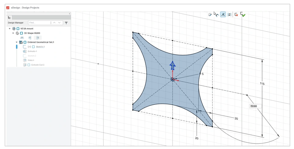

In xDesign the main profile sketch of the mounting bracket is edited the side radius is changed from 50m to 70mm. After exiting the sketch, the component is saved.

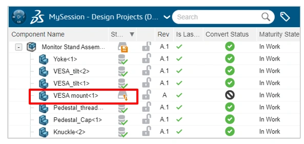

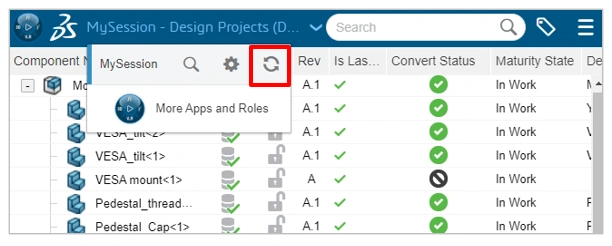

The SOLIDWORKS session was open in the background with the monitor stand loaded. To see the status change a refresh of MySession is required.
After the refresh the status icon of the mounting bracket has changed to show that a more recent version is available on the 3DEXPERIENCE platform.

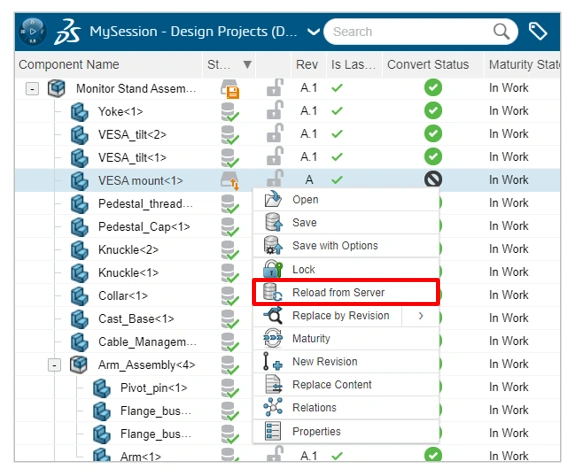

The mounting bracket is updated by RMB on the component in MySession and selecting Reload from Server.
When reloading an updated component, three options are available.
In this example the mounting bracket does not have any references so “Reload selected file only” is chosen.
When updating a SOLIDWORKS assembly containing modified native 3DEXPERIENCE components, each modified component is re-imported during the reload from server operation in SOLIDWORKS.
If the Derived Output setting for Generic Feature and Associativity has been enabled (3DEXPERIENCE and SOLIDWORKS setup) then the original face IDs will be maintained. The Concentric mate will rebuild successfully. However, if the Derived Output settings has not been enabled then new face IDs will be assigned to the geometry during the re-import which can cause any mates based on faces or edges of the native 3DEXPERIENCE component to fail.

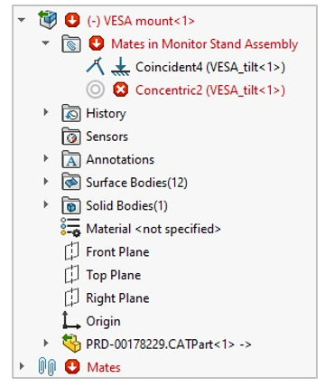

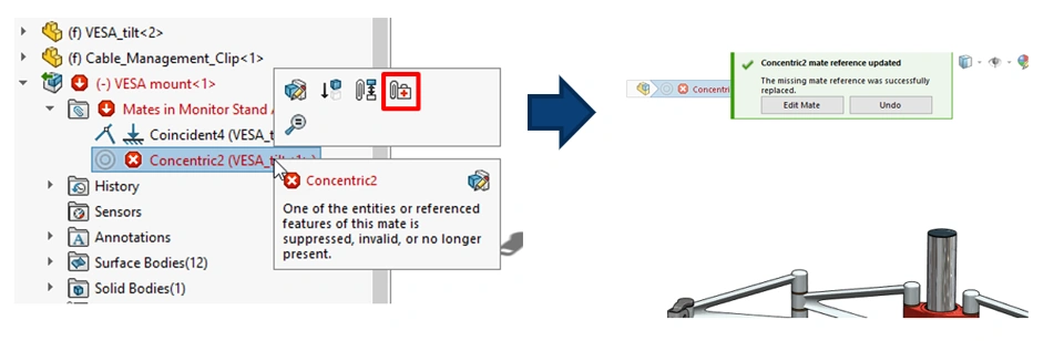

In Step 4 the mounting bracket was aligned using two mates. The concentric mate was constructed using the cylindrical face of the mounting bracket center hole. After the update this mate has failed because new face IDs were assigned during the update of the native component. Whereas the coincident mate being based off of a reference plane of the mounting bracket has rebuilt successfully.
Tip: A quick method of fixing any failed mates is to use the Auto-Repair option
The Monitor Stand assembly is now fully up to date and any mate errors fixed.
