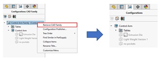

If your company uses SOLIDWORKS 2024, use the Remove CAD Family option so that only one Physical Product configuration can exist per file. With this option set, additional SOLIDWORKS configurations will be automatically created as Representation configurations.
<strong>NOTE</strong>: It is recommended that SOLIDWORKS part and assembly templates are updated with the CAD Family removed to make this the default behavior for every new part and assembly file.

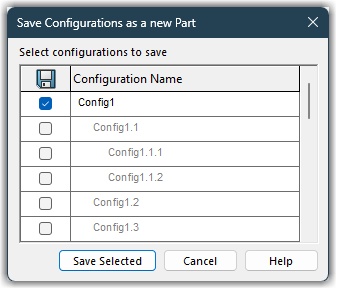

If you decide to maintain any part or assembly configurations as individually life-cycled engineering items, then those configurations must be split or saved into individual part and assembly files, with each file containing only one Physical Product configuration.
<strong>NOTE</strong>: Saving configurations to individual files is a manual process that can be automated using a SOLIDWORKS macro.
