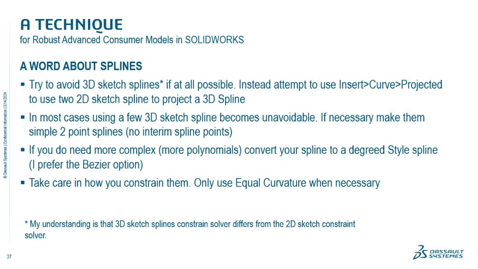

Known to most, there are differentiating levels of complexity of modeling in SOLIDWORKS. Whether you are in an industry that produces moderate to complex molded shapes or just want to improve your modeling skills beyond Extrude, Revolve, and Fillet, you will benefit from this session. This session is for intermediate and advanced SOLIDWORKS users who have a good working knowledge of the basic and advanced modeling tools. The focus of this session is on how to use them in a way that you can achieve the best quality in your design yet once your concept is defined, it can be a robust and modifiable solution for yourself and others. Using a live demonstration in SOLIDWORKS, the presenter will explain and show the various phases of developing a complex model, starting with conceptualizing and then moving to a detailed design solution made up of a robust curve network that can be quickly modified to provide a parametric solution for others to use.
