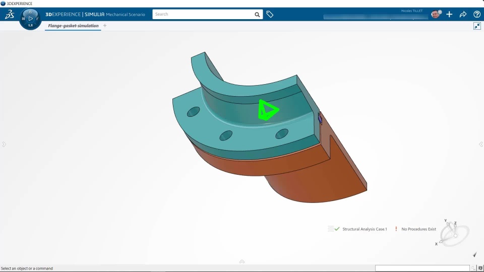

This presentation is a step-by-step demonstration of how to run a design simulation trade-off study using both SOLIDWORKS and 3DEXPERIENCE Works Simulation.
You will learn how to do the following:
  • Access the 3DEXPERIENCE Works structural simulation apps directly from SOLIDWORKS
  • Take advantage of the advanced simulation capabilities such as the ABAQUS solvers, and the advanced meshing tools including brick meshing, using the automatic ABAQUS General Contact, accessing a wide library of materials, leveraging cloud computing, and accessing and sharing with others the simulation results from a web browser
  • Change the SOLIDWORKS CAD model and re-run the 3DEXPERIENCE Works structural simulation in a few clicks - Transfer a simulation study from SOLIDWORKS Simulation to 3DEXPERIENCE Works Simulation to reuse a simulation setup
  • Automate a design exploration to find the optimal design alternative based on variables, constraints, and goals​​​​​​​
