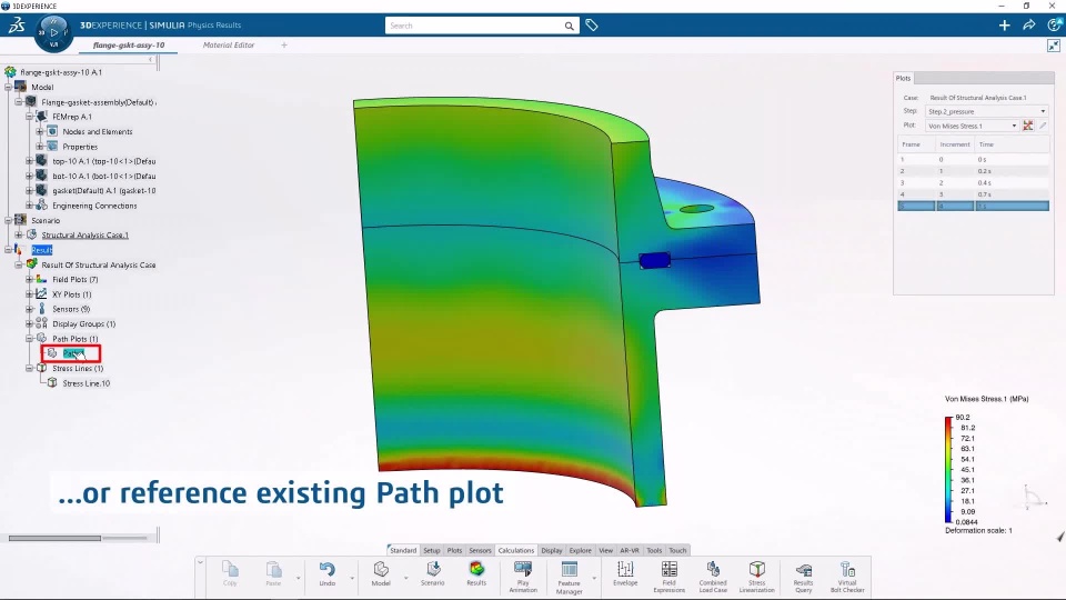

Reliably investigate and review material behavior with new material properties plotting capabilities

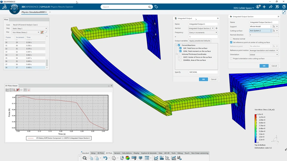

Enhance vehicle safety workflows with the availability of integrated section output definition and results visualization

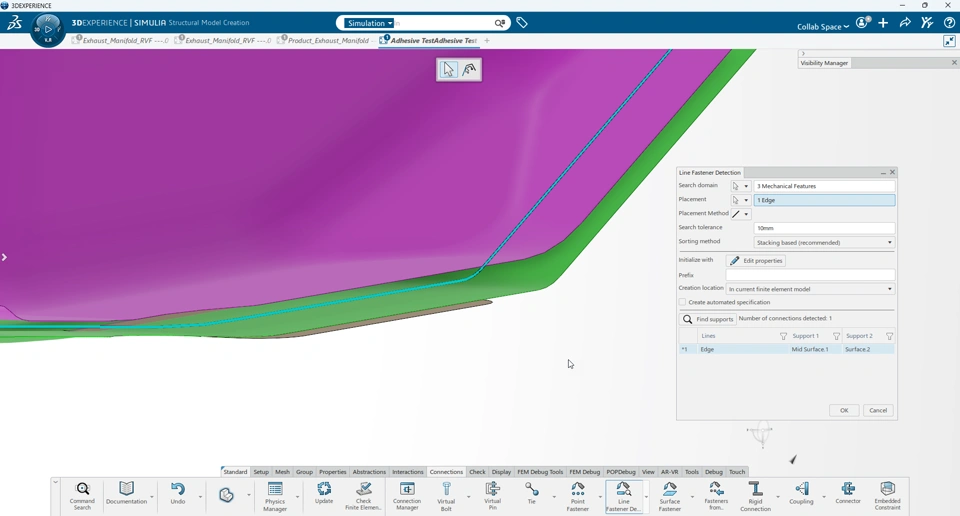

Improve line fastener robustness involving multi-part overlapping scenarios with the availability of enhanced proximity detection techniquesEnhance modeling of heat transfer effects in thermal engineering applications with the addition of cavity radiation definition

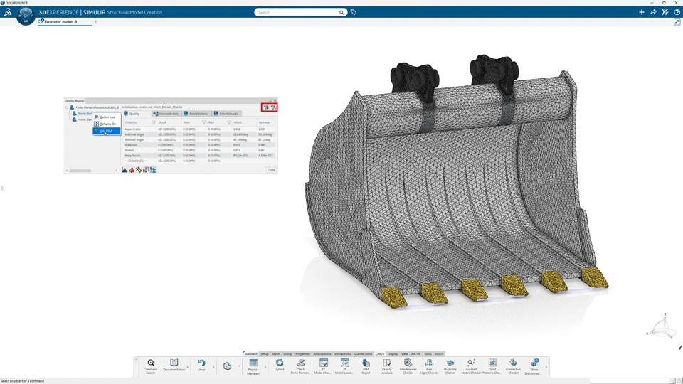

Easily review the mesh quality matrix of selective meshes with the enhanced Quality Report

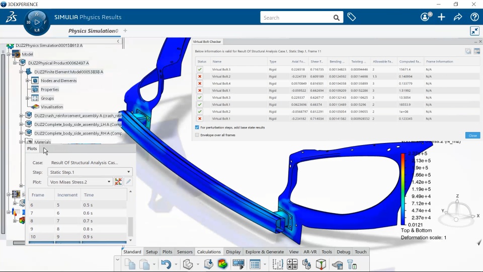

- New factor of safety output for virtual bolts allowing a quick check if the bolt has failed or not

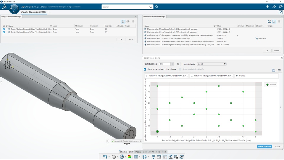

- New app introduced: Parametric Design Study Essentials - single objective study identifying the best design in an intuitive environment

- New check and fix tools for compatible line fasteners connections are improving dramatically the meshing success rate

- Durability - XY Plotting of Fatigue Loading Signals
