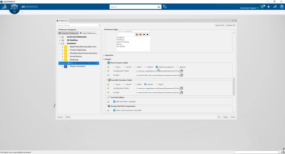

Video Demo 1: How to activate ICAM Foundation post-processors
To access the ICAM post-processors, including 3-axis milling and 2-axis turning, change your preferences as shown in the following video.

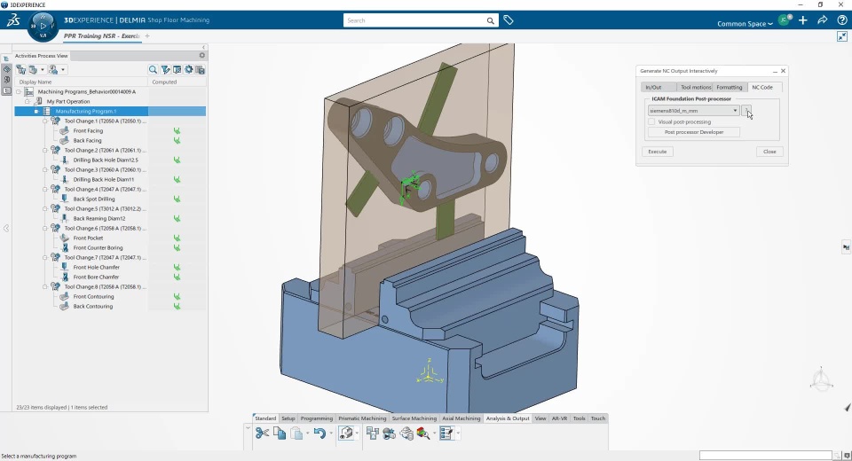

Video Demo 2: How to generate machine code
During the output generation step in Shop Floor Machining, you can select the post-processor and generate the machine code (G-Code). You can also access the documentation of these post-processors.

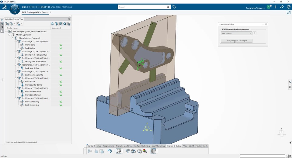

Video Demo 3: How to modify an existing post-processor
In NC Shop Floor Programmer, you can customize an existing post-processor according to your needs.
