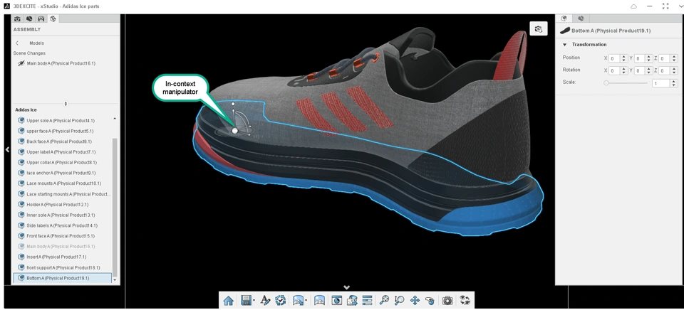

  1. Remember to double click a part to select it. Single-click selects the entire assembly, rather than the target part.
  2. Once a part is selected, please look for a small triad which is an in-context manipulator, sometimes at a corner, as shown below. This small manipulator integrates lots of controls to move, rotate, and scale parts.

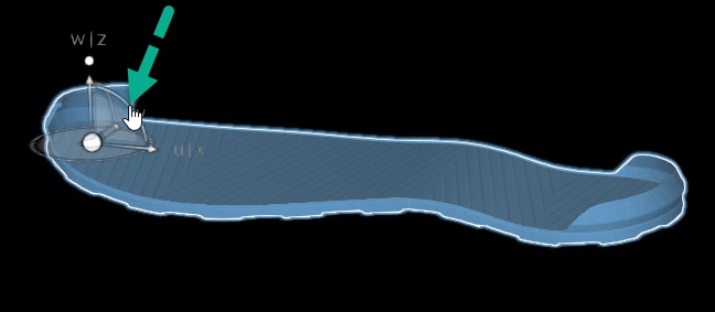

  3. Hence the click has to be very precise on the triad.
E.g.
Drag an arrow to translate:

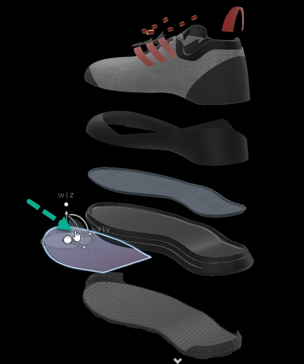

Drag a plane to move along that plane:

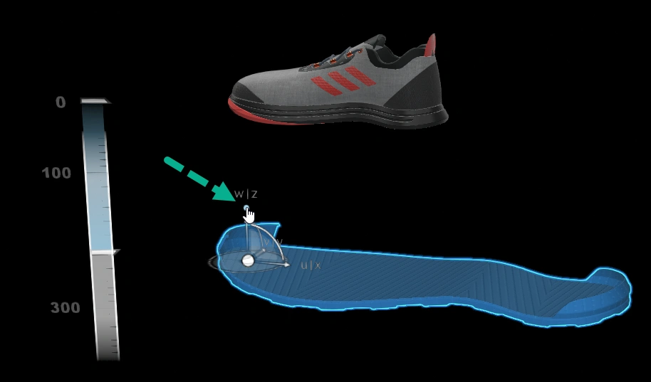

Drag the quarter circle to rotate:

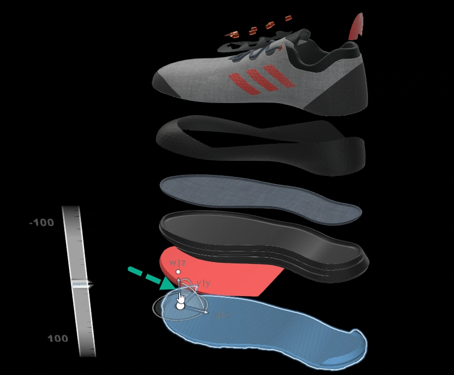

Drag the top dot to scale up and down.
