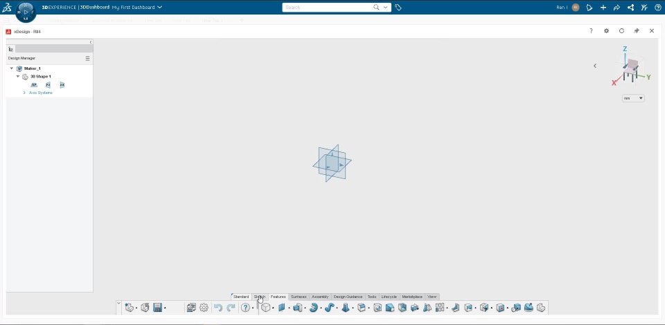

To launch xDesign and create a model:
  1. Open the 3DEXPERIENCE Platform in a browser and log into your account
  2. Click on the Compass at the top-left corner of the page
  3. Under ‘My Roles’, click ‘3D Creator’ > click on ‘xDesign’ to launch the app
  4. On the xDesign window, click ‘New Component’
  5. Enter a file name in the ‘Name’ text field
  6. Click the down-arrow next to the ‘Location’ field > choose the Collaborative Space in which you want to save the xDesign file > Click ‘Ok’
Now you can explore the Action Bar at the bottom of the widget to create a new sketch, insert an existing model into the assembly, or create an extruded body.
The video below shows you the steps to create a new model in xDesign.
