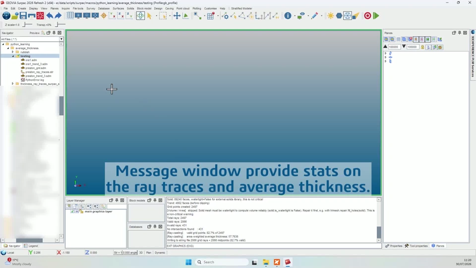

The second thickness method takes every node on the sampling grid and generates an infinite ray both forwards and backwards until they intersect the solid. For GEMS users you can imagine this as needling as it is very similar. We record the intersections and calculate the distance between entry and exit points. Often a ray will fail due to the trend surface being outside the solid boundary, or it only records a single intersection or it misses the solid entirely due to a hole. Rays can also be excluded based on a user specified Maximum Distance which eliminate erroneous large rays due to complex shapes of the solid and trend surface. These failed rays are retained and exported as part of the output file as grid node points in string 3.
Once all rays are complete the valid rays are averaged and the thickness reported in the message window. The script in version v1.2 now also writes the Bearing, Plunge and Dip in to the D3, D4 and D5 fields of string 2. This can then be used with the Surpac search ellipse to show an orientated ellipse based on the surpac ZXY-LRL convention. This can then be input to the block model as dynamic anisotropy search criteria.
