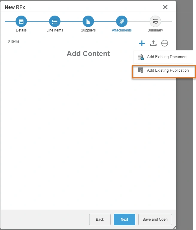

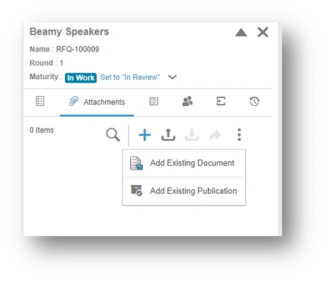

Adding Publications to an RFx Object
Why
Improve communication with suppliers by sharing with them more information related to the RFx
How
  • You can now attach Publication package to RFX
  • The attached Publication is saved in a zip format and you can decide if you want to share it with your suppliers or not.
  • Once shared, suppliers can view the Publication content by downloading the zip file.
Note: The Package Publication is generated in the ‘Collaboration Package Management’ app that comes with ‘Product Release Engineer’ or with ‘3D Product Architect’ roles

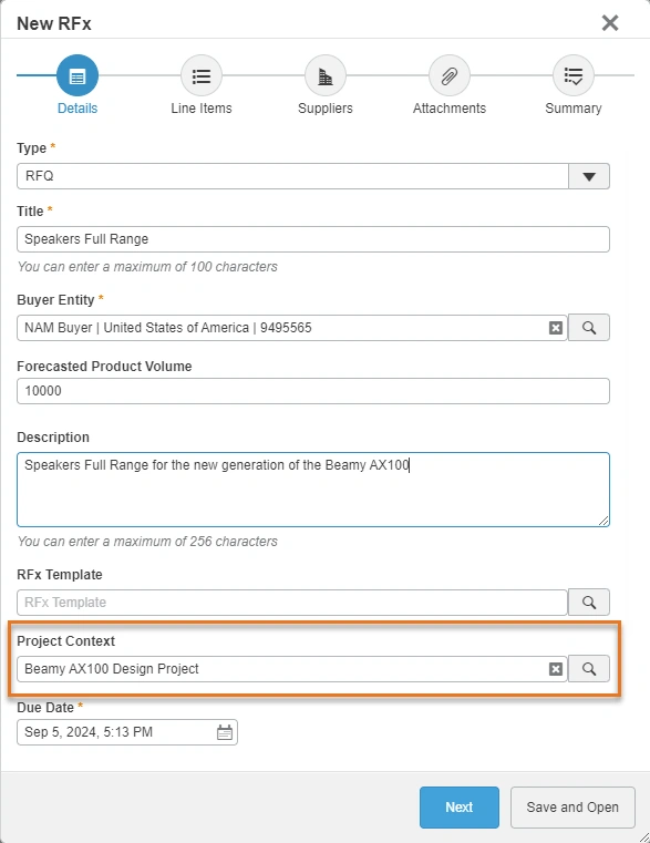

Support for Project Context for RFX
Why
Improve productivity by providing project information on the RFX level
How
  • A new field, ‘Project Context’ is now introduced, which allows you to associate a project with the RFX.
  • The following project types are supported:
    • Project Management
    • Project Planner

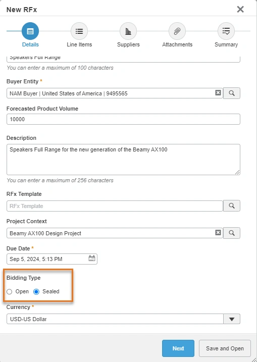

Support of "Open" versus "Sealed" concept for RFQ
Why
Improve RFQ process through a sealed RFQ
How
  • A new field, ‘Bidding Type’ is introduced for RFQ in the RFQ creation dialog which contains two optional values:
    • Open (current behavior)
    • Sealed (new)
  • In the case of a Sealed RFQ, buyers cannot access supplier responses until the RFQ due date has passed.
  • In the case of an Open RFQ, buyers can view supplier responses at any time.
Note: RFI is always Open
