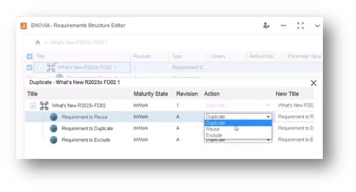

Duplicate Requirements with Advanced Options
Why
Improve flexibility when duplicating requirements by using the Advanced Duplicate option
How
Advanced Duplicate mode is now available in Requirement Structure Editor application.
When duplicate a requirement specification, you can now specify for each child object if you want to:
  • Duplicate
  • Reuse
  • Exclude

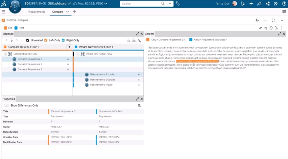

Requirement Content Comparison
Why
Improve decision making by analyzing the differences between requirements through compare option
How
You can now compare the content of two different requirements or different revision of the same requirement.
New command, ‘Compare Structure’, is added to the Requirement action bar, under the Lifecycle tab, allowing you to load the selected Requirement object in the Compare widget.
The following panels are displayed in Compare widget, depending on the selected compared objects:
  • Structure Panel – comparison of structures of selected objects
  • Properties Panel – comparison of properties of selected object
  • Content Panel – comparison of content of selected object like text, images, tables etc…

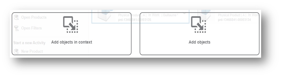

Open Requirement in Context of its Parent
Why
Improve the understanding of the requirements, by opening the requirements in context
How
You can now open requirement object in the context of its parent.
When dropping requirement object from any application to ‘Requirement Structure Editor’ widget, you get two options:
  • Add Objects - this will open the dropped object in the application
  • Add objects in context – this will open the dropped object in the context of its parent
