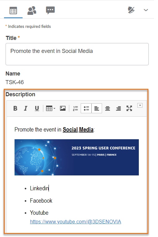

Rich Text in Task & Projects Description
Why
Enrich communication and clarity among project team members by using rich text in projects and tasks description.
How
  • We are now supporting rich text for the Description of tasks and projects.
  • Using the rich text you can now:
    • Create bold and italicize fonts
    • Underline phrases
    • Add bullet points.
    • Choose different fonts, text sizes, and colors
    • Add hyperlinks
    • Embed images
    • And more

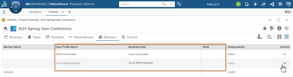

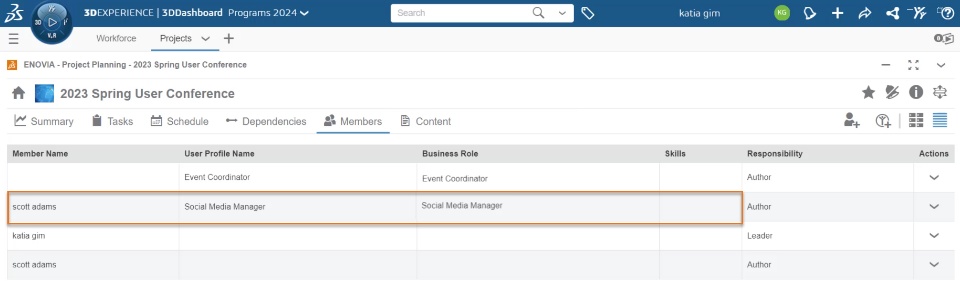

Display User Profile after Assignment
Why
Improve resource allocation management with available information about the profile, skills and business role of the required resource.
How
  • New columns are added to the Members table view in Project Members Tab:
    • User Profile Name
    • Business Role
    • Skills
  • This information is displayed in the table, also after the user was assigned to the project.
  • You can also un-assign a user.
    In this case:
    • The User Profile will go back to its unassigned state.
    • If the user who was assigned is not assigned to any other User Profile, a dialog box will be shown, asking you if the user should remain a project member or removed from the project.

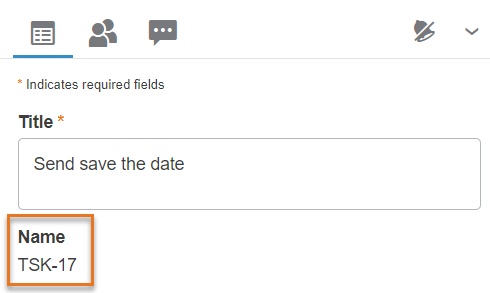

Task Name Availability in the Property Panel
Why
Improve collaboration and clarity through a unique task’s name / id
How
  • A new field ‘Name’ is available now in the task’s property panel.
  • The name is unique per tenant.
                                                             Same Title different / unique Name:

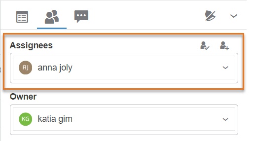

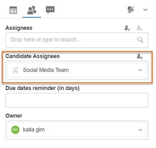

Candidate Assignees for Tasks
Why
Improve efficiency of resource allocation process by setting candidate assignees
How
A new field ‘Candidate Assignees’ was added to the Task Members tab, in both ‘Project Planning’ and ‘Collaborative Tasks’ applications.
Candidate Assignees’ can contain single users or a group of users.
A new filter ‘Show Tasks where I'm the Candidate’ was added, displaying all the tasks that:
  • Does not have any assignee
    AND
  • The user is directly a ‘Candidate Assignee’ or part of a group which is a ‘Candidate Assignee’.

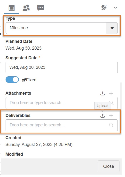

Deliverables and Assignees for Milestones
Why
Improve project review process and traceability by adding deliverables and assignees to milestones
How
You can now add deliverables and assignees to milestones.

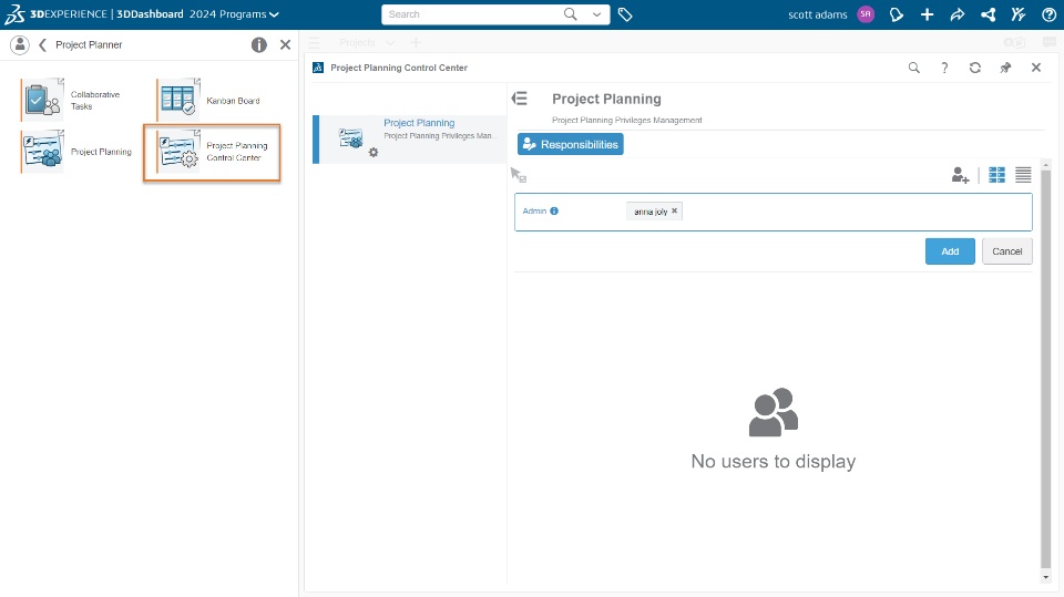

Project Planning Control Center
Why
Improve administration through a new Project Planning Control Center
How
A new ‘Project Planning Control Center’ widget is now available, that enables platform administrators to grant Project Administrator responsibility to other persons or groups.
