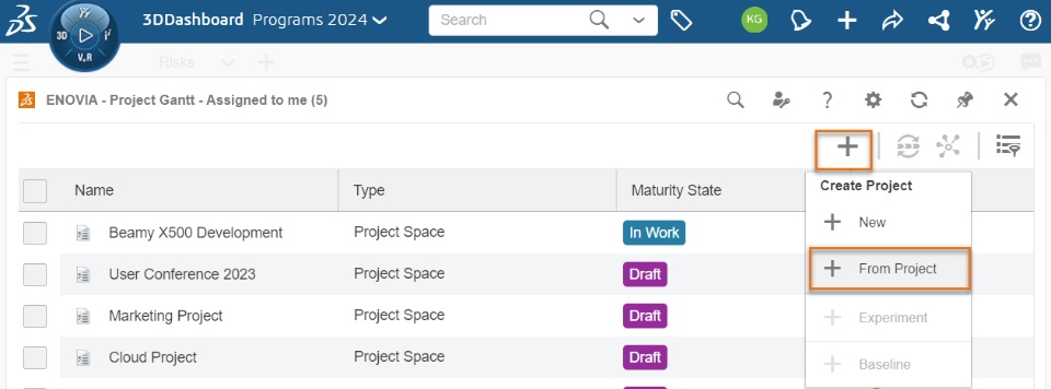

Create a Project from existing Project in the Gantt widget |
Why Improve productivity by allowing creation of projects from existing projects in Project Gantt widget |
How You can now create a new project from existing project in the ‘Project Gantt’ widget The newly created project becomes the context and is loaded in ‘Project Gantt’ widget Note: Project Manager role (DPM) is required to create a new project in Gantt widget |

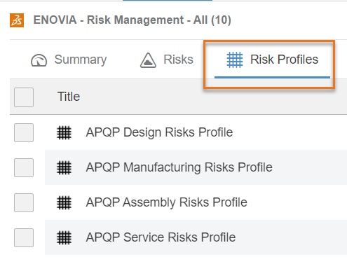

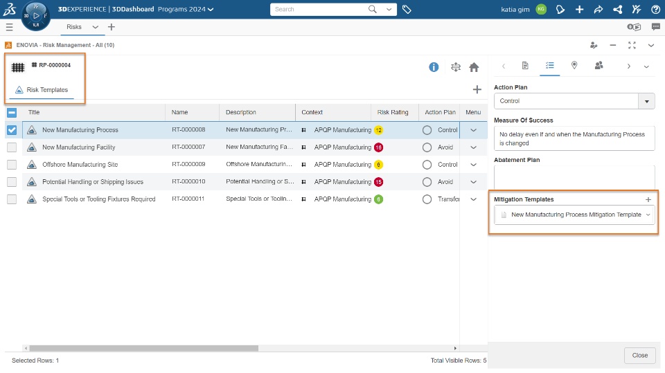

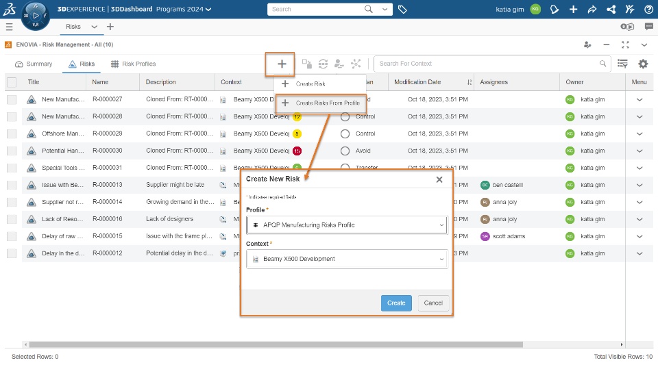

Support of Risk Profiles and Risk Templates |
Why Save time and standardize risk creation through Risk Templates and associated Mitigation Project Template. |

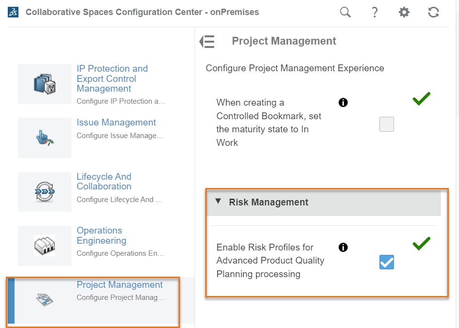

How New tab is introduced, ‘Risk Profiles’ in the ‘Risk Management’ application lists all Profiles.Each Risk Template defines the properties, mitigation plans, members, classification and relations of the risk. •Scratch (as before) •Profile Note: To enable this enhancement, the following setting should be enabled: ‘Enable Risk Profiles for Advanced Product Quality Planning processing’, (available in the ‘Collaborative Space Configuration Center’, under the ‘Project Management’ section.
