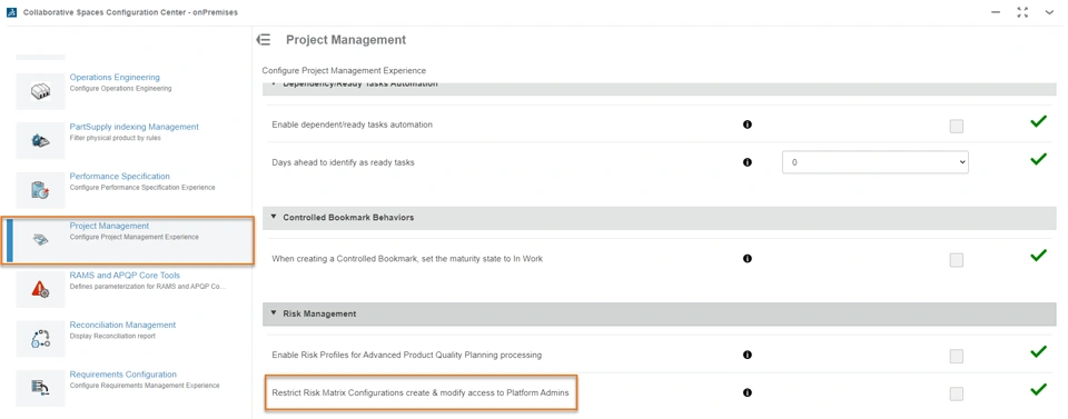

New Setting to Restrict Access To Risk Matrix Configuration
Why
Better control over who can configure the Risk Matrix through a new setting
How
  • A new setting ‘Restrict Risk Matrix Configuration create & modify access to Platform Admins‘ is now introduced and available in the ‘Collaborative Spaces Configuration Center‘ widget under ‘Project Management’ -> ‘Risk Management’ section.
  • It allows you to control who can configure the Risk Matrix Configuration.
  • In case the setting is set to :
    • False (the default), the behavior remains the current behavior:  Project Leaders can create and modify the Risk Matrix Configuration
    • True, only users with platform admin privilege can configure the Risk Matrix Configuration.

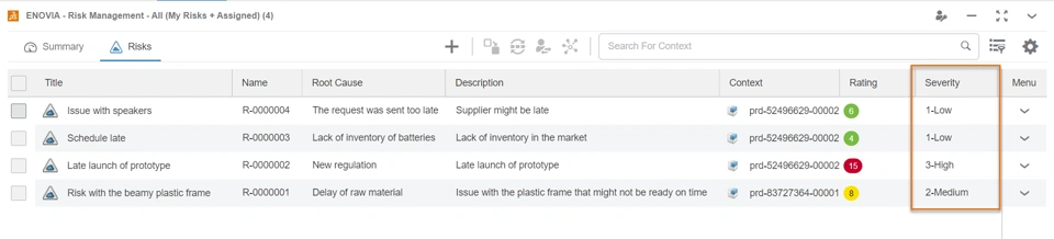

New Attribute ‘Severity’ for Risk & Opportunity
Why
Improve decision making by displaying the severity of the risk in the creation dialog, the table view and the property panel.
How
  • The Risk Severity is based on the Risk Impact and the Risk Probability.
  • Until now, the severity of the risk was represented only by the various colors in the Risk Matrix. (Green, Yellow, Red)
  • Now, a new field, ‘Severity’ is introduced and available for Risk and Opportunity in the:
    • Creation dialog
    • Table View
    • Property Panel
  • In the default risk matrix configuration the severity is mapped as follows:
    • Green level is mapped to Severity 1- Low
    • Yellow level is mapped to Severity 2 – Medium
    • Red level is mapped to Severity 3-High
  • You can change the severity definition in the risk matrix configuration.

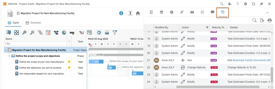

History Tab in Information Panel
Why
Improve regulatory compliance by capturing and listing all user actions performed on an object
How
A new tab ‘History’ is added to the Information panel in the ‘Project Gantt’ app.
The ‘History’ tab displays history details of a selected project entity including:
  • Modified On
  • Modified By
  • The Action
  • The Maturity State
  • The Details
The Details column includes a link to the respective object which can be opened in other applications.
