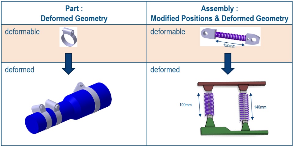

Support of Deformable/Deformed Products
Why
Easily identify “Deformable” and “Deformed” products in the Engineering Definition and prepare for the procurement process
How
You can identify the “deformability” of the product through a new attribute, that can have one of the following values:
ValueMeaning
Rigid
the Engineering Item cannot be deformed (therefore not deformable)
Deformable
This is the reference of the “Deformed” Item:
The Engineering Item that can be “Deformed” to one or more forms
Deformed
The Engineering Item is deformed from a “Deformable” item
Notes:
-One or more “deformed” products are linked to the “Deformable” product.
-Use the view “Product Made From” to display the roll up of occurrences for all deformed Engineering Items of the same “Deformable” one, to prepare for the procurement process.
-In index mode, the Enterprise Item Number of the “Deformable” item is also applied to the “Deformed” product(s)
-Ideally, you should not set an Enterprise Item Number (EIN) on the “Deformed” item. The system will not block you from doing so, however a warning message will appear in this case that recommends not to modify the EIN on the “Deformed” object.
