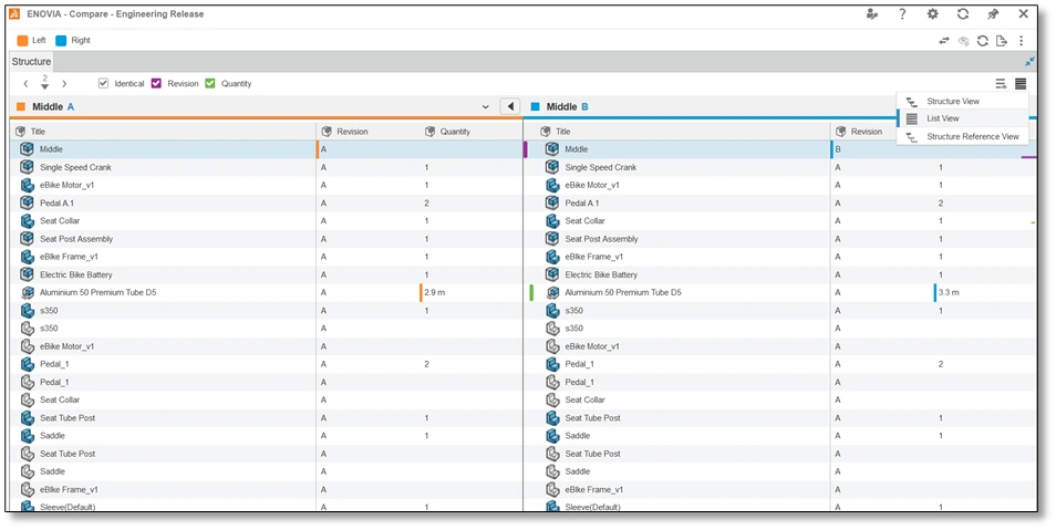

Compare Quantities of Raw Material |
Why Enable a quantity compare between Engineering Items as a preparation for manufacturing/procurement |
How
•The “Compare” command enables you now to compare quantities between Engineering Items of: •Raw materials •Parts •Sub assemblies •You can switch between three views in the Compare tool: •Structure View – shows the quantity per instance •List View - shows the total quantity calculated for each reference •Structure Reference View - shows the quantity per reference

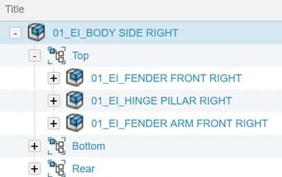

Browsing Structure Support in Engineering Release app |
Why To ease and increase collaboration across disciplines and organizations through grouping the structure using predefines nodes |
How You can now assign Engineering Items to predefined nodes (*) and display them in groups that reflect these assignments This facilitates the navigation of your Engineering Definition, A new command “Manage Browsing Structure Definition” is available now, to enable you to: -Group Engineering Items by a Browsing Structure -Add the selected Item(s) to a Browsing Node -Review existing assignment, and modify it (adding / remove nodes)
Note: Browsing Structures and Browsing Nodes are created with “ENOVIA- Browsing Structure Definition” App (Role: CCM - Classification Manager) The Browsing Structure must be released to be able to use its nodes in the association with Engineering Item.
