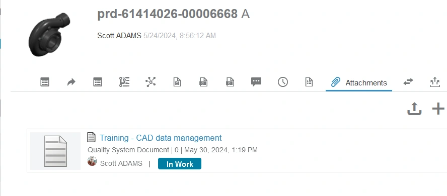

Controlled Documents Support
Why
Enrich Engineering Item definition with new types of documents
How
You can now add controlled documents to the Engineering Item, as Attachments and/or Specifications.
All types of Controlled Documents are allowed to be added, except of:
  • Controlled Document Template
  • Rendition Document Template
The following commands have been removed when you right-mouse click the Document:
  • New Branch
  • New Revision From
Note:
  • Controlled documents are created using the role "Quality Document Author (QUC)"

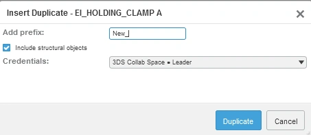

Insert Duplicate:
Allows you to perform the following actions in one shot:
  • Duplicate an existing Item
  • Insert the newly duplicated item as a child

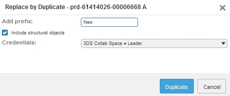

Replace By Duplicate:
Allows you to perform the following in one shot:
  • Duplicate existing item
  • Replace existing item with the newly duplicated one

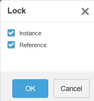

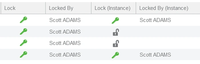

Lock/Unlock Engineering Item Reference/Instance
Why
Protect the instances/references you are working on from being modified by other users
How
You can now lock or unlock Engineering Items (references / instances) using the new icons:
When clicking on the icon, the following options will be displayed to make your choice:
