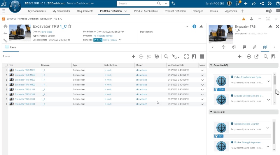

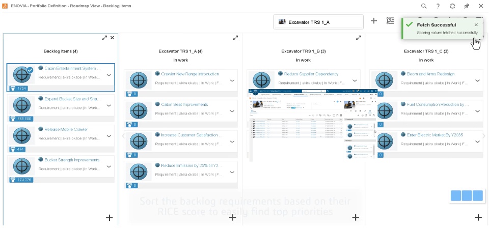

Displaying the Requirement Score in the Tile View
Why
Improve decision making and requirement prioritization by viewing the requirement score on the tile
How
  • The requirement score calculated based on the R.I.C.E scoring model is now displayed on the requirement tile when it is viewed in the:
    • Roadmap Tab
    • Maximized Roadmap View
  • You can refer to this score to take further decisions such as committing the requirement to the required portfolio version

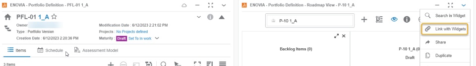

Link Roadmap View to Portfolio Definition
Why
Speed up your backlog prioritization by linking and synchronizing Full Roadmap View to the Portfolio Definition app
How
  • You can now use the “Link with widgets” option to link a Full Roadmap View to the Portfolio Definition app available in the same dashboard tab.
  • The roadmap view is synched with the selected portfolio version in the Portfolio Definition app. This allows you to switch between portfolio versions and view associated roadmap view seamlessly.
