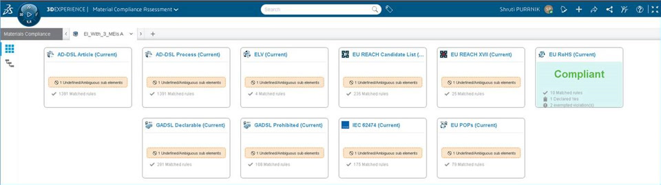

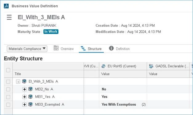

  1. In this example, the Engineering Item (EI) has 3 MEIs , with different compliance status “EU RoHS” regulation
  2. After drag & dropping the EI into Material Compliance Assessment widget, you can visualize the compliance result by default

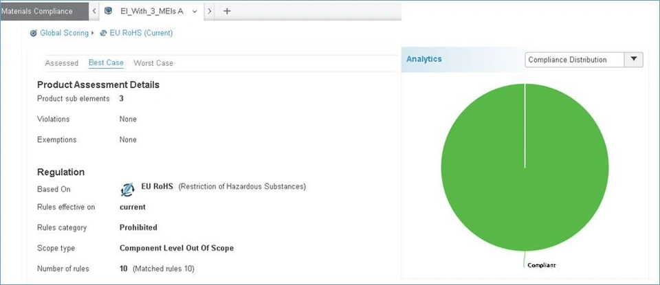

  3. By clicking on the EU RoHS Current compliance card, users can drill-down in the results and visualize Best and Worst case MEI

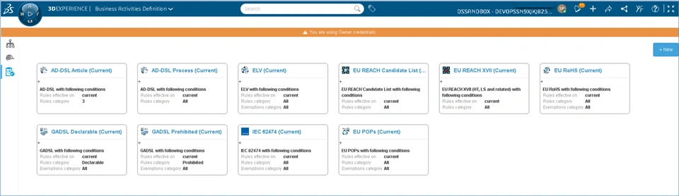

Support EU POPs Regulation
Why
Improve regulatory compliance through a new supported EU POPs regulation
How
A new unconfigured EU POPs Regulation is now available in the Business Activities Definition app, which allows you to perform POP’s compliance assessment on your products in the ‘Materials Compliance Assessment’ app

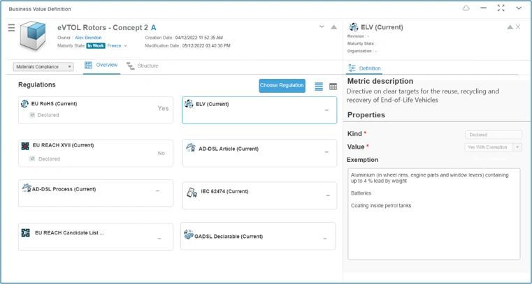

Class A Definition within Business Value Definition
Why
Improve Materials Compliance Engineering Definition by leveraging and authoring sourcing information coming from suppliers
How
You can now author the compliance status of Manufacturer Equivalent Items (MEIs - supplier’s products) as well as Engineering Items using the Yes/No/Yes with exemptions options within Business Value Definition widget.
